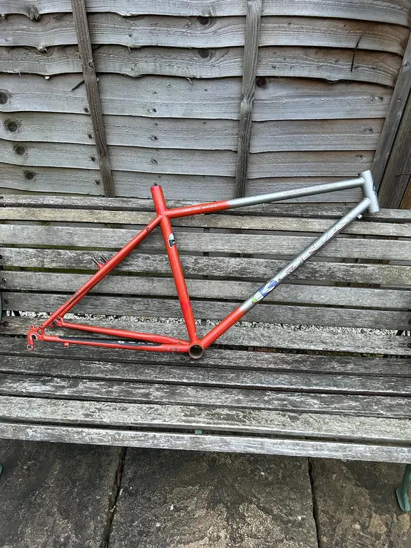

1993 Kona Hahanna - seized stem/bits missing :D

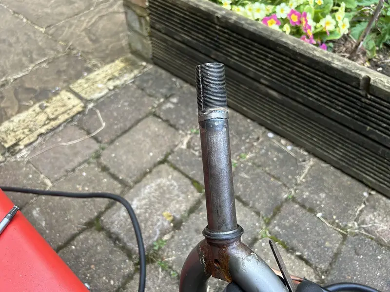

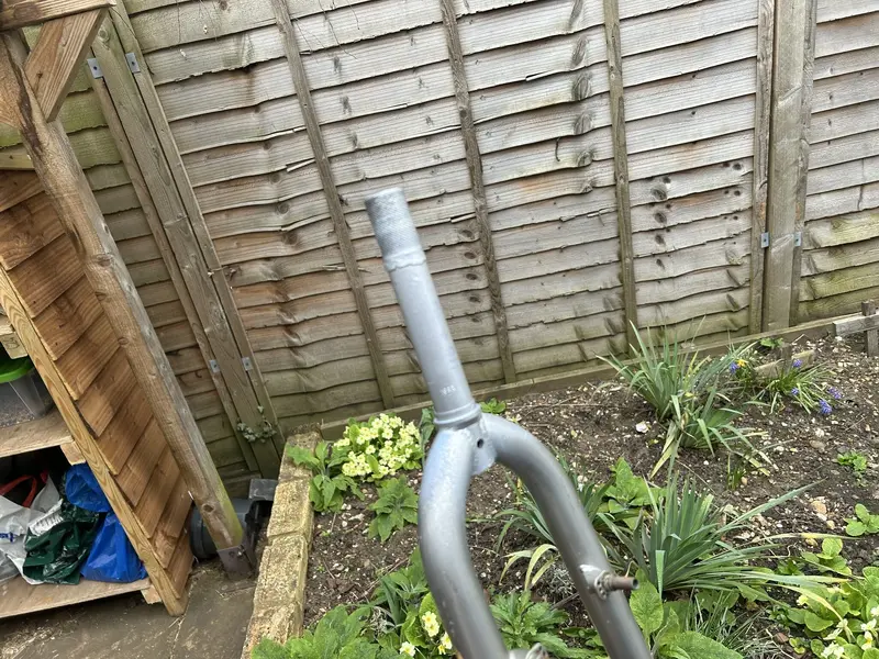

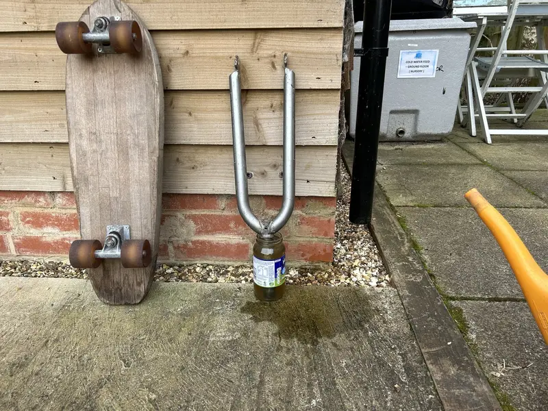

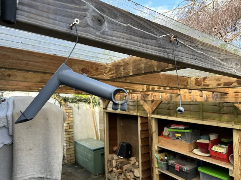

Well, bit disappointing - I’ve been soaking this in a fairly strong acid solution and while it did clear the stem out:
It also wore the steel threads down too:
My fault, I should have ordered some caustic soda and used that, lesson learned.
So now the forks need new a steerer welding on (I’ve done that before) or I need to source a 1” fork.. hmmm..

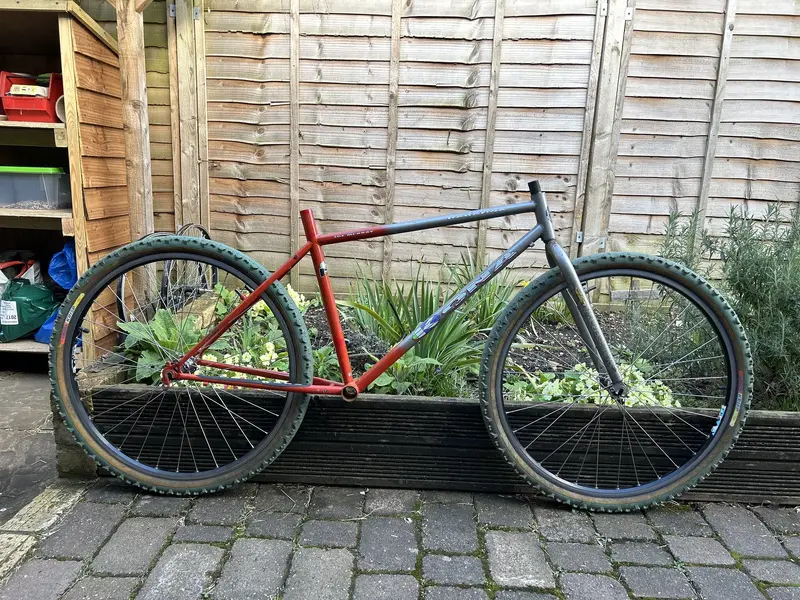

A random road bike fork donated the top of its steerer and I got it welded on and a coat of paint to protect from rust.
I’ve done this sort of repair before, each time improving the method, hopefully this’ll hold up ok. I got a nice neat bead of weld around it and purposefully didn’t grind it all the way flat afterwards, I figure the more material on there the better.
Now I can build it up this weekend. :)

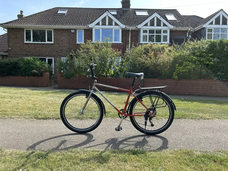

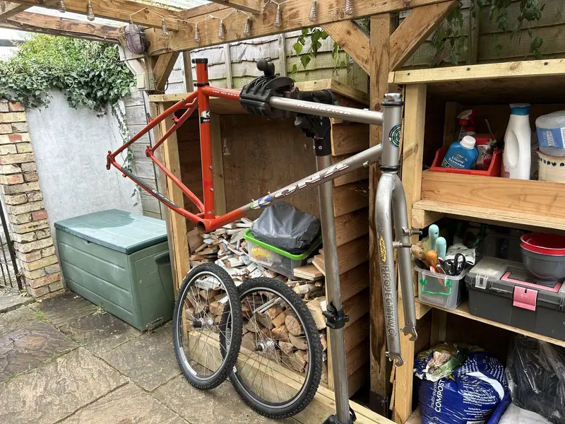

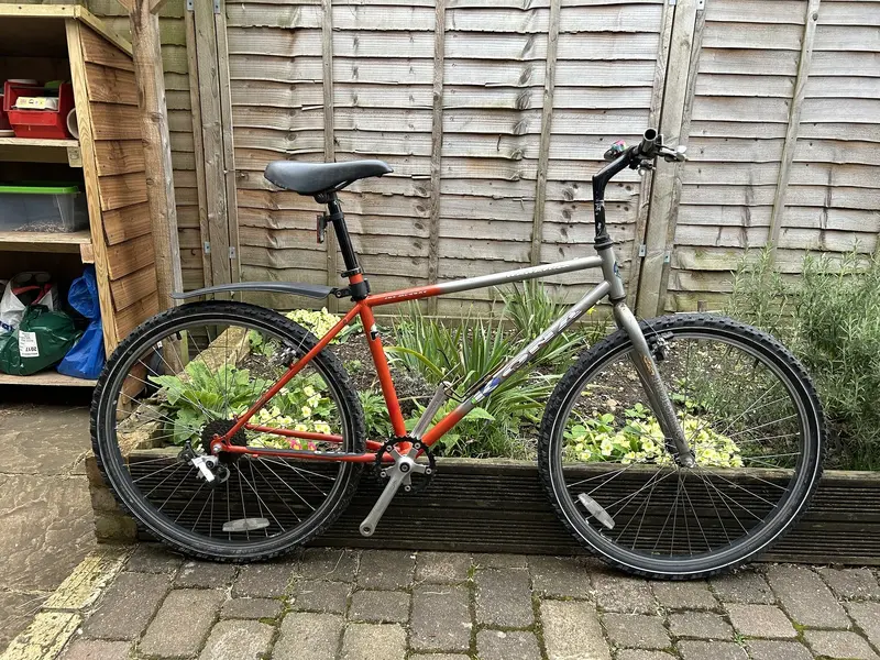

Woke up early this morning so I thrashed this out, I was really eager to see if the fork repair had worked. It did, the forks went in and tightened down in the headset with no issues.

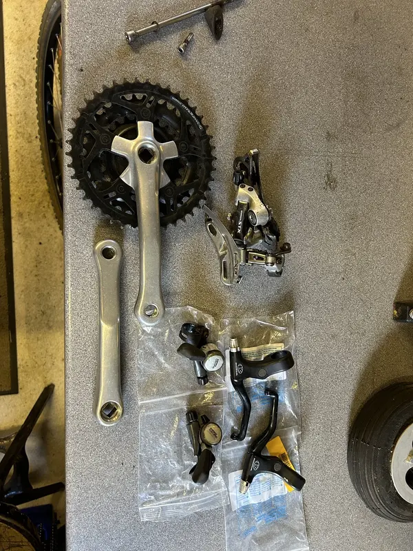

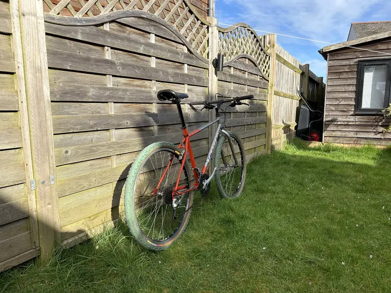

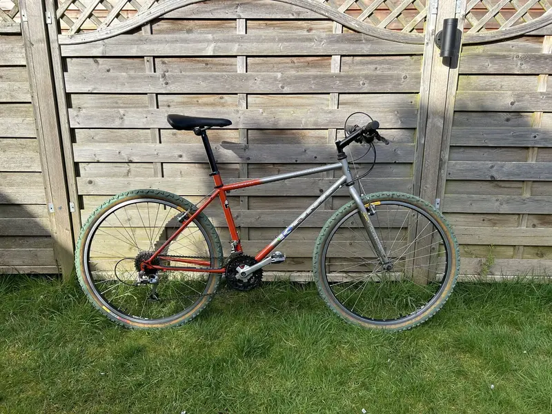

It helped that I’d sorted all the components ready for the rebuild and had them all laid out ready. I’ve been for a couple of mile ride and I’m really happy with it - even with lower end kit these old steel Kona’s are great fun.
*not necessarily my political sentiments, but couldn’t resist a pic with the green graffiti (matches the tyres :LOL: ).
