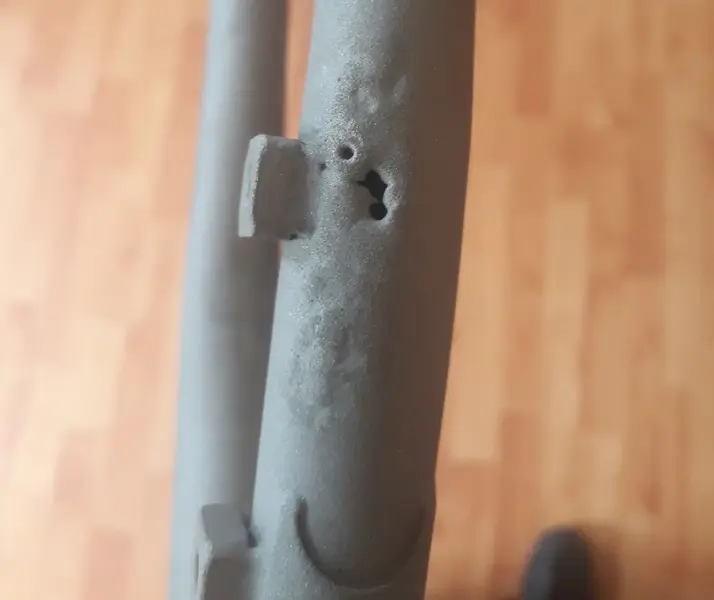

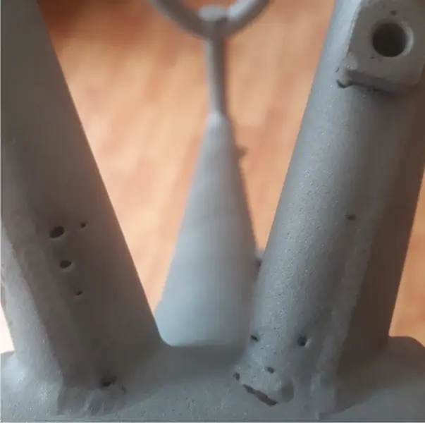

Well, I sandblasted the frame and it's in pretty bad shape as you can see in the pictures. I'm not an expert when it comes to repairing frames, welding etc. but it looks to me like it needs new chainstays. Maybe I can have some extra gussets welded over the bad spots and then ride it till I brake it.
Any thoughts?

Judging by the second photo it looks like that whole area is on its way out. If it was my frame and I was pretty attached to ithe frame, looking to keep and use long term, then I would explore the option of replacement stays. Otherwise I'd explore other options but I think you be removing a fair bit of material in the process.
