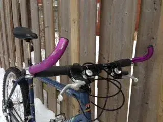

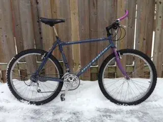

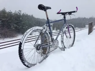

I took it for a test spin today. Attached are some pics.
