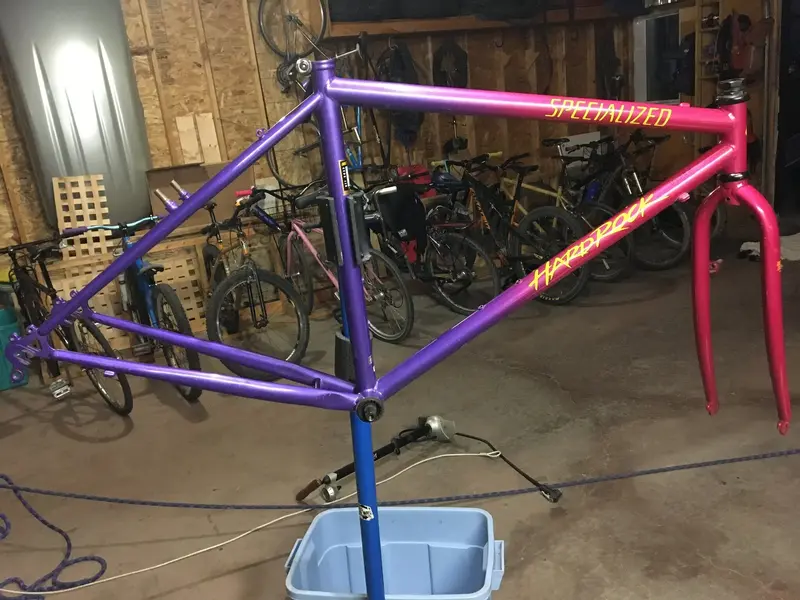

I just purchased a 1992 or 1993 Specialized Hard Rock Ultra frame. I need to get a seatpost, but am not sure of the size. I scoured the internet as best I could and have 2 possible diameters, 26.0 and 26.2. Since this will be difficult to get I would rather get the right one the first time. Does anyone have one of these that could verify the correct post?

I finally got the seatpost sorted. I initially ordered a 26.0. When it arrived it was way too small so I asked the shop to measure the seat tube. The shop couldn't find their measuring device so after trying all the posts we could find and using the caliper we decided to order a 26.4 and try that since finding a 26.2 was going to be challenging. Yesterday it arrived and worked. Thanks for the input.
