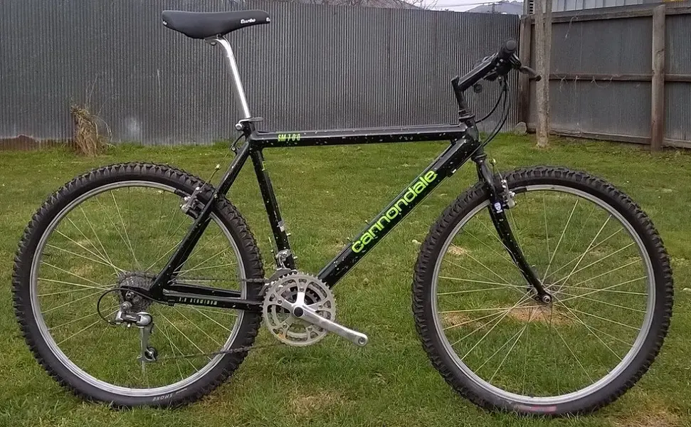

I just acquired this from my brother who got it from a collector a few years back. It's a 1991 Cannondale SM700 18". I always wanted a Cannondale of this era but was only 12 years old at the time and Cannondale's were a bit out of my price range. It's really a bit small for me but with a 140mm stem I will be able to get my riding position correct, and a 140mm is still borderline acceptable for this size bike of this era.
It's all in quite good condition and very close to catalog spec. I've just fitted an LX rear derailleur to bring that back to original spec. Plus I put on a new Turbo saddle which while not catalog correct is fitting for this vintage. The Ritchey post was cracked so I put on a Kalloy copy.
Other parts to be replaced are:
-Remove Smoke and Dart tires for suitable Ritchey model
-Remove 560mm Zoom bar for 580mm Ritchey (or similar)
-Remove new style Ritchey grips for old style WCS foam or ODI Attack
-Remove 120mm stem and make a new one in 140mm length
-Remove the seat skewer and replace with a bolt
This should be enough, along with a general service and re-grease of all bearings.
Then time to give it some throttle on the local trails...
