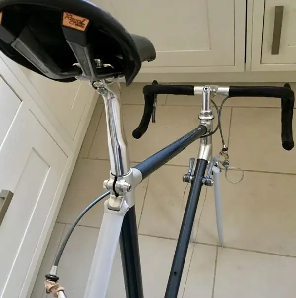

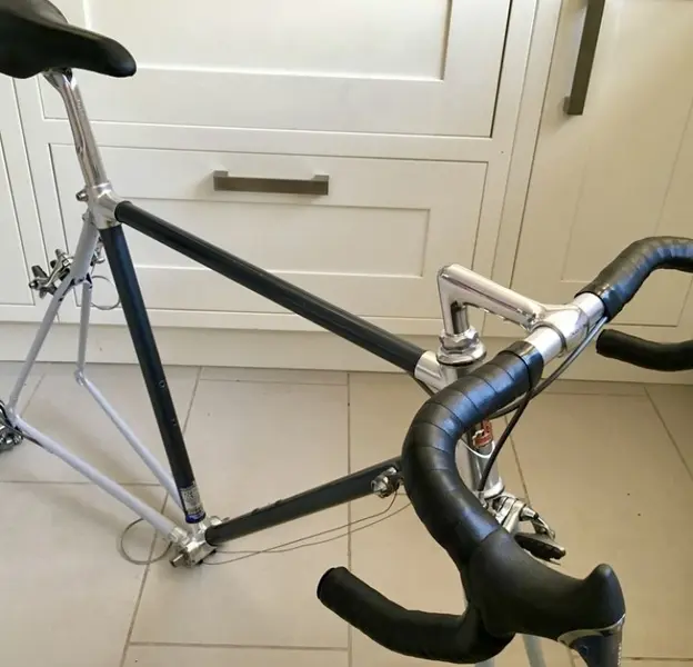

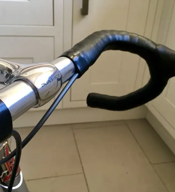

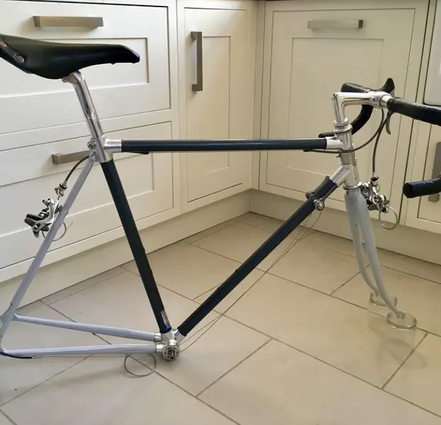

Again, I had a bit of spare time today where I could get a bit more done on the build-up. I was really keen to get the bars and stem on along with the seat post and saddle. A bit of cleaning and some polishing beforehand though - mostly with the bars. As they still had remnants of part of their old 3TTT Forma logo. I'd rather they were badgeless too, as it allows the stem and its Dura Ace logo to take centre stage.

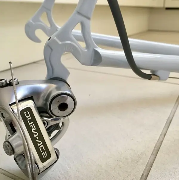

I also managed to retain the rear derailleur outer cable and its fittings. This was completely covered in Black paint, but some gentle rubbing with emery cloth did the trick.

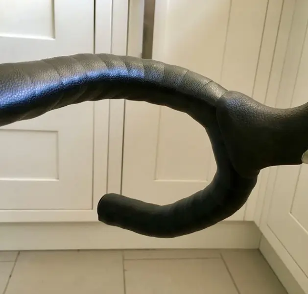

The rear derailleur was cleaned up and fitted, as were the brake levers, then I installed all the cables and cut them to size. Last job was to wrap the bars, and I was careful to use my old favourite from the early 90's; it's like a plastic leathery high density foam. Ambrosio used to make it, and it was simply referred to as bike ribbon. It took a while to find any, and in the end it had to come from a shop in Spain!

The original rear derailleur cable was resurrected with various abrasive substances 😁...
The genuine late 80's Regal Girardi saddle I've had waiting on the shelf for years...
A close up of that bar tape/ribbon...

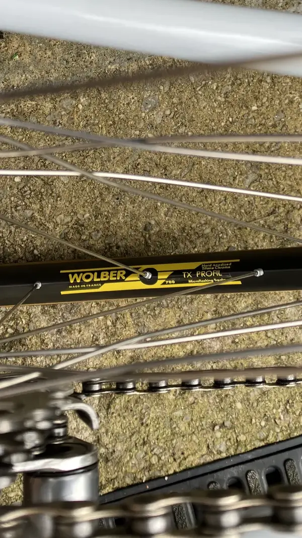

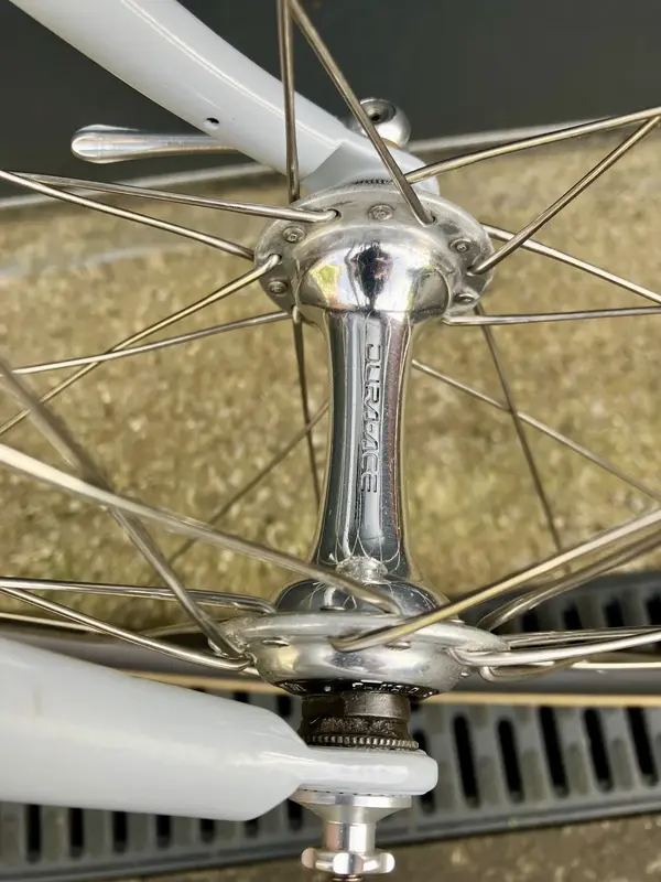

Ive still retained the original wheels, but I also had some 28h hubs with some Campagnolo Omega Strada rims (which will be used elsewhere). I always wanted Wolber on this build, but was divided between buying old rims which are designed for 19mm tyres (plus let's not forget that old rims are old rims, and will always have an amount of wear unless they're NOS), or using very similar modern rims with a 23mm width. As I'm keeping the original wheels still, I became less attached to the idea of being totally retro with these new wheels, so I bought some H Plus Sons Archetype hard anodised rims. I can comfortably use modern 23mm tyres with these rims too. They look so much like an older rim, that I was quite happy to include them on this build, and I've ordered a set of Wolber decals for them, which will have most people fooled.

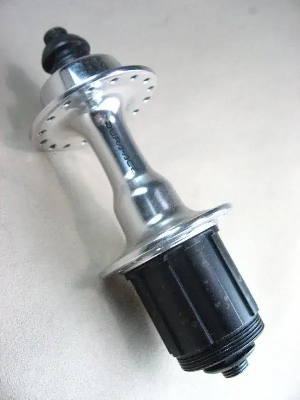

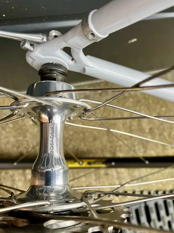

The hubs are the pretty rare Uniglide/Hyperglide crossover, which allows either type of cassette to be used. I've got a NOS Dura Ace 7400 cassette, but I really want a nice 8 speed Titanium one. Mechanically, the hubs are sound, but visually they were very tired, and I knew I had to rub down all the pitting and anodising to smooth bare alloy before hand polishing them. Here they are after hours of rubbing...

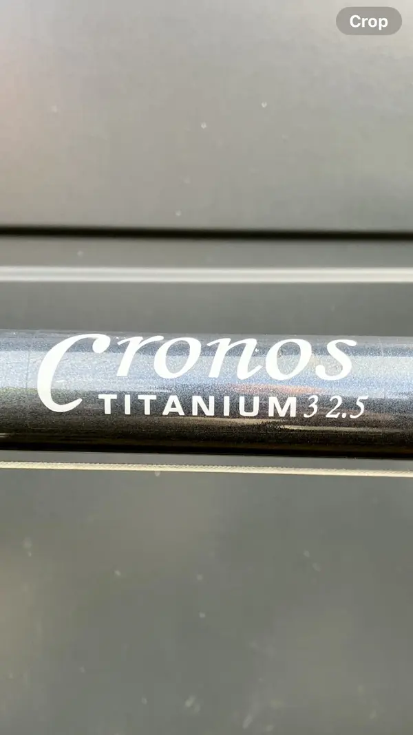

Like I said before, these are a close copy of the originals, but with a slight twist. Where the steel work would have a Raleigh worded decal, I thought it better to recognise the quality of tubing they'd chosen. Also, Reynolds were doing that strange thing with Raleigh, and changing their tube names from 753 to 2080 etc. and nobody really knew what 2080 was, so I retained the 753.
The main tubes are identical to the originals, but I've left out the silly oblong with a marble type finish to it.

PS the locknut on the NDS of the rear hub is backwards for some reason.
