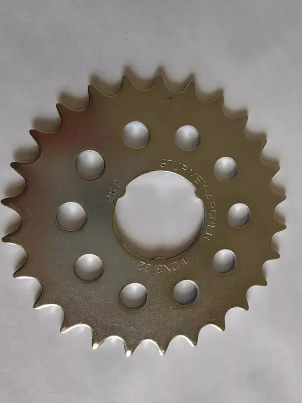

One of the nice things about the Alfine is it takes any 3 lug gear hub sprocket from Sturmey, Shimano or Sachs/Sram and others, I am currently running the offset 24 tooth Sachs 3/32" wide sprocket that gives a nice 42mm chainline. I believe Sturmey made a 26 tooth that takes 1/8" chain so the gearing choices really very wide.
I have not seen an SA sprocket bigger than 24T but do have a Sram the same fitting that is 25T

Could have been a typo or a limited production part, it popped up during a web search for Sturmey Archer cogs. I said I believe and that does not make it fact, so who knows...

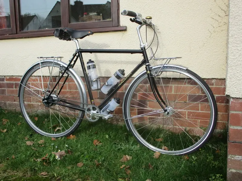

What a wonderful Royal, it presents very nicely and exhibits excellent workmanship
Beautiful fender lines, are the fenders Velo Orange? I went almost mad fitting Honjo fenders to my Bob Jackson World Tour still a work in progress

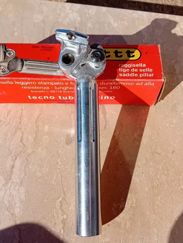

The long hunt for a very early 70's 27.2 3TTT Record seatpost in decent condition for the Stratos ended last night with the purchase of this NOS in the box item out of Germany (the cost was reasonable). It's a period correct match for the 3TTT adjustable stem that's installed. There really is a Santa... WOOT.
Merry Christmas and may all your holiday wishes come true: Mike
