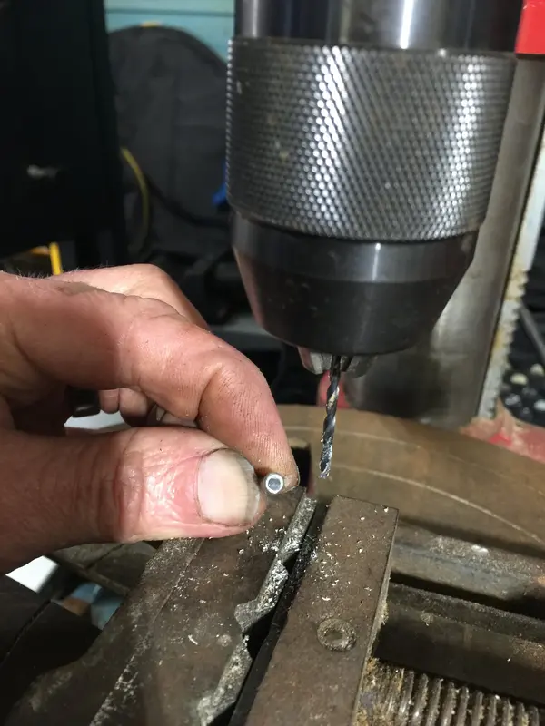

However even the big end caps I have were a tad too small so I needed the pillar drill to make them big enough. I think I should have cut my nails before this photoshoot! 🤣

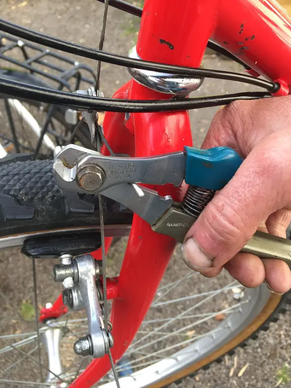

I like to triple crimp my cable ends for aesthetic reasons. Not my best work, but acceptable for a Hardrock! 😜

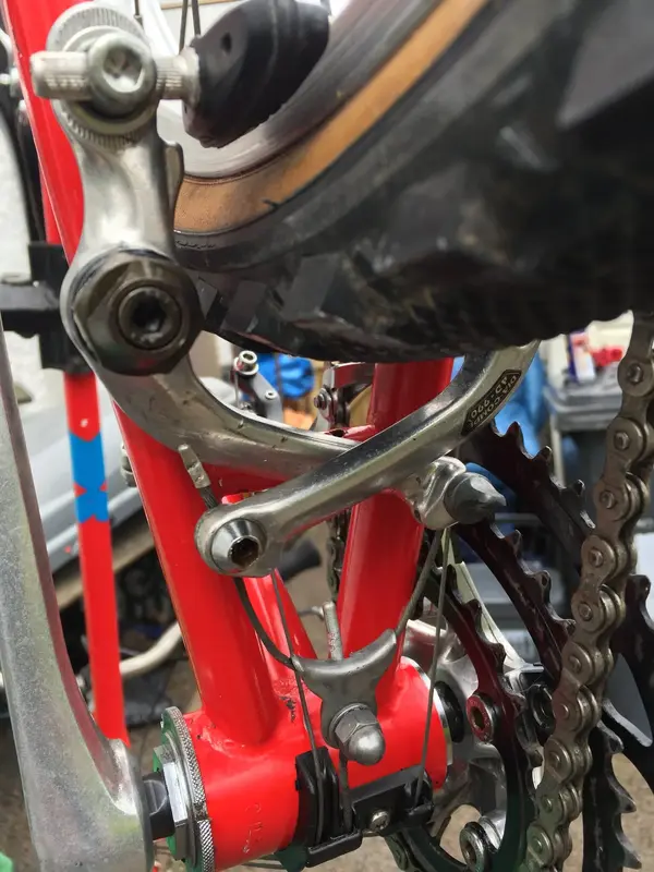

Got to love a U-brake. Love setting these up. Some people hate them, but I think they are rather splendiferous! :cool:😍
Some details....
Look the amazing grip detail on this straddle cable nipple! 😍
Love the crude nylon block that replaces where the B adjustment tab & screw normally go. No idea why this wasn't integrated into part of the black washer/sleeve it screws into? Looks almost homemade which I love!
Also a big fan of the all steel barrel adjuster and it gorgeous knurling.

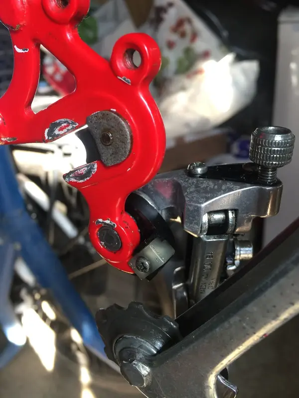

And one more detail you cannot see. All the High/Low adjustment screws on both derailleurs have vertical slots in them with nylon inserts to provide friction to prevent them vibrating loose. All great stuff on such a budget bike

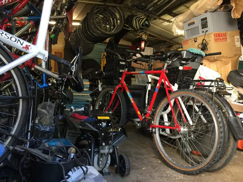

Now parked up back in the garage amongst the chaos! 🤪
