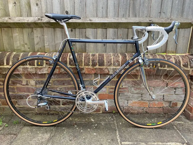

If it's of any interest I finished putting one together a bit earlier in the summer - a year younger than yours but same frame design I think with the fastback stays.
Mine still has really nice condition original paint and decals, so have left it for now, but may tidy up at some point down the line, for now it's getting some miles put on it as it's a great ride and my only road bike, built up with full Shimano 600. -there's a full build thread in Readers Rides.
I really like the frame with the cut out lugs and seat stays, tempted to find another one and do a period correct resto in the pale blue colour, so look forward to seeing how yours turns out.
