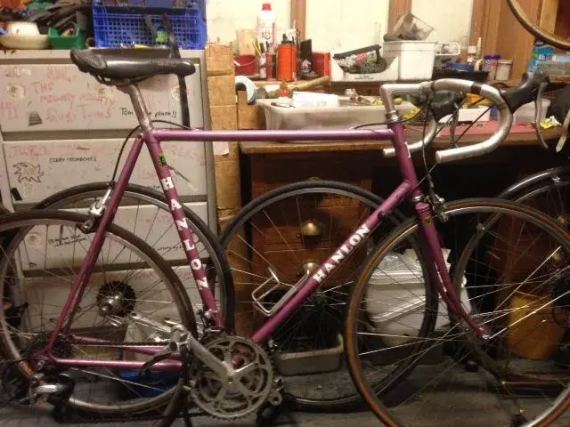

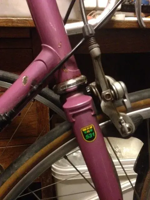

Here are some pictures:

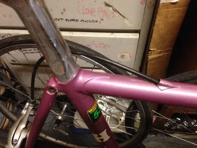

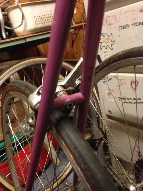

And a few more pics.
The carefully filed v-shape tip at the lower end of the fork blade seems to be a Vic Edwards feature.
I agree that it was probably modified to take allen key brakes at the time of the repaint. Quite likely the internal cable guides were added at that time also, although I have seen these on much earlier frames as original features, so not entirely sure about that.
It's a bit ratty at the moment, but deserving of a sympathetic rebuild and repaint, I feel.

Re: 1970 Pat Hanlon - 700c wheels and Allen key brakes, or not.
Looks like a 70's frame with internal routing, brazed on front mech etc added later. Are there two small portacatena holes on the rear dropout or are they long items?
Dropouts are Campag, short and almost vertical, not the usual semi- horizontal type.
The frame number makes it 1970.
I have fitted a pair of Mavic Module 2/Campag SF 700c wheels (as shown in the pics) which seem to look right, so it was probably built for sprints. I think 27s might be a bit tight, although only 4mm larger in radius.
