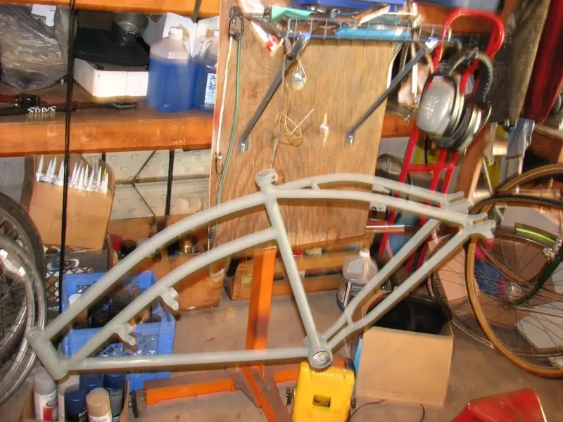

Original paint stripped. I welded on clips for a battery tube. Welded on new seat post clamp as the original was snapped off. Frame was considered a loss by the previous owner because of the missing seat tube clamp. I got it very cheap. IMG_4113.jpeg
2k epoxy primer and 2k base coat.

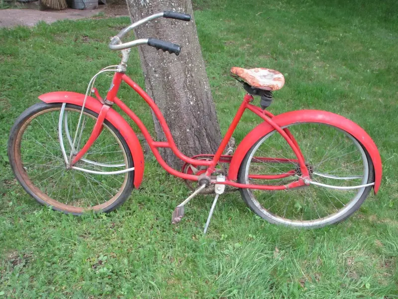

Donor bike. I used the peaked mudguards with curved stays and the matching art deco Chain guard. I used a hammer and dolly to remove the mudguard dents. IMG_4117.jpeg IMG_4118.jpeg

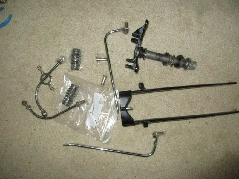

Front springer fork from a 1950s bike. Disassembled for cleaning and painting. IMG_4122.jpeg IMG_4129.jpeg

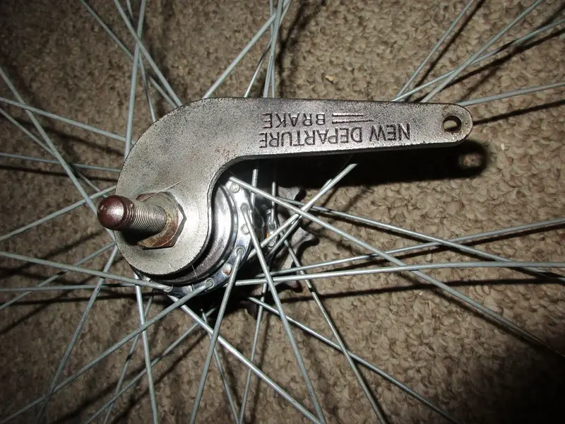

One inch drive from red donor bike. I laced the wheels up using a beautiful set of obsolete, free, donated, chrome, drop center rims. The rim profile is tapered so rim brakes won’t work. IMG_4114.jpeg IMG_4121.jpeg

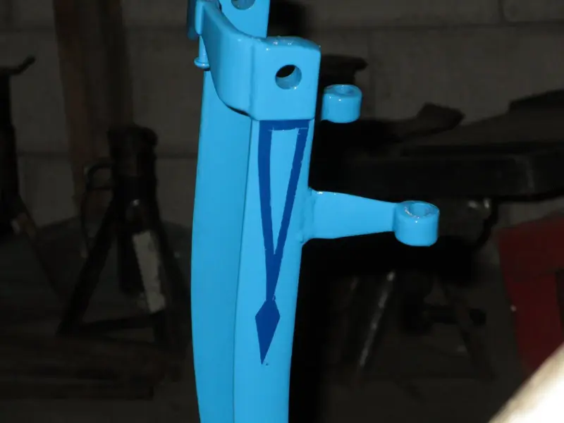

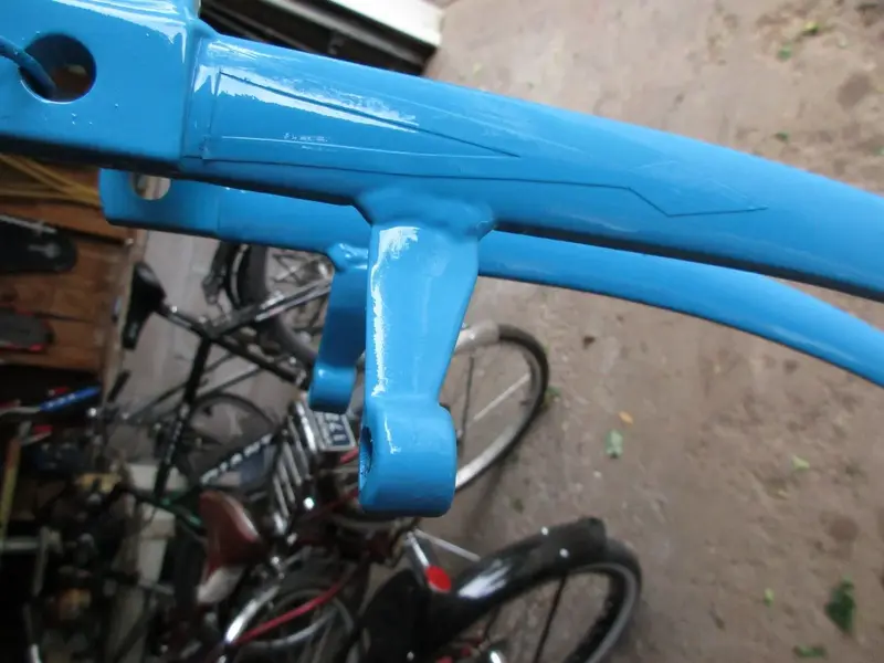

Original paint stripped. I welded on clips for a battery tube. Welded on new seat post clamp as the original was snapped off. Frame was considered a loss by the previous owner because of the missing seat tube clamp. I got it very cheap.View attachment 779443
View attachment 779444View attachment 779445

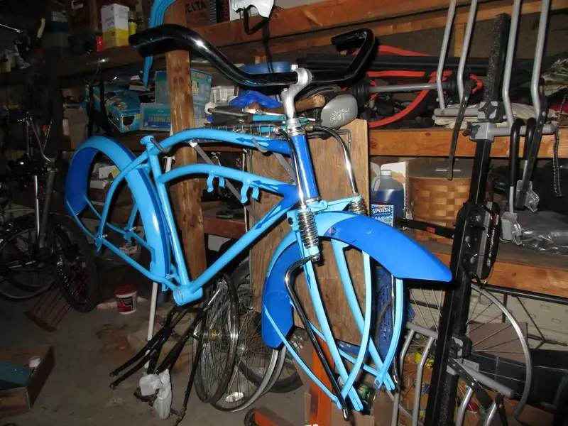

Donor bike. I used the peaked mudguards with curved stays and the matching art deco Chain guard. I used a hammer and dolly to remove the mudguard dents.View attachment 779455View attachment 779456
Front springer fork from a 1950s bike. Disassembled for cleaning and painting.View attachment 779457View attachment 779458
One inch drive from red donor bike. I laced the wheels up using a beautiful set of obsolete, free, donated, chrome, drop center rims. The rim profile is tapered so rim brakes won’t work. View attachment 779464View attachment 779465

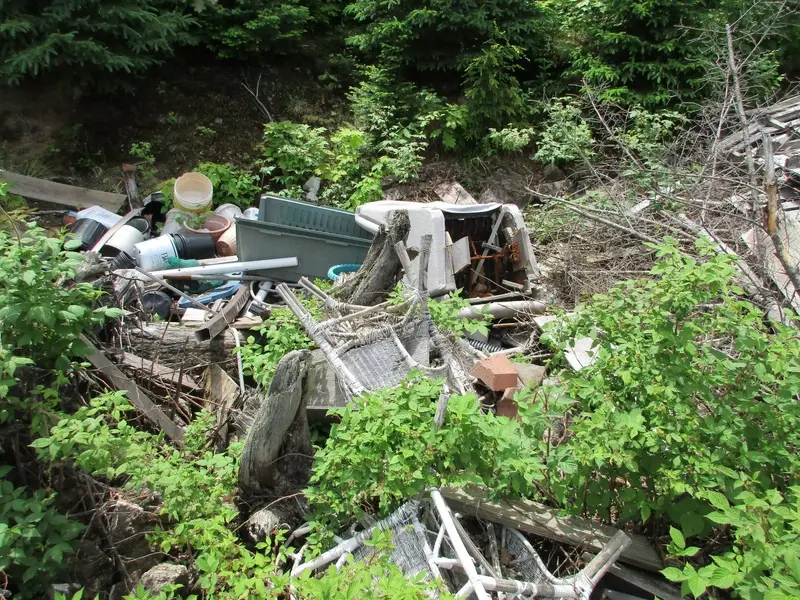

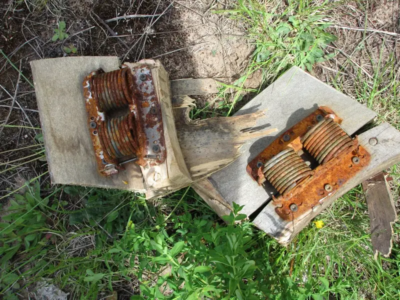

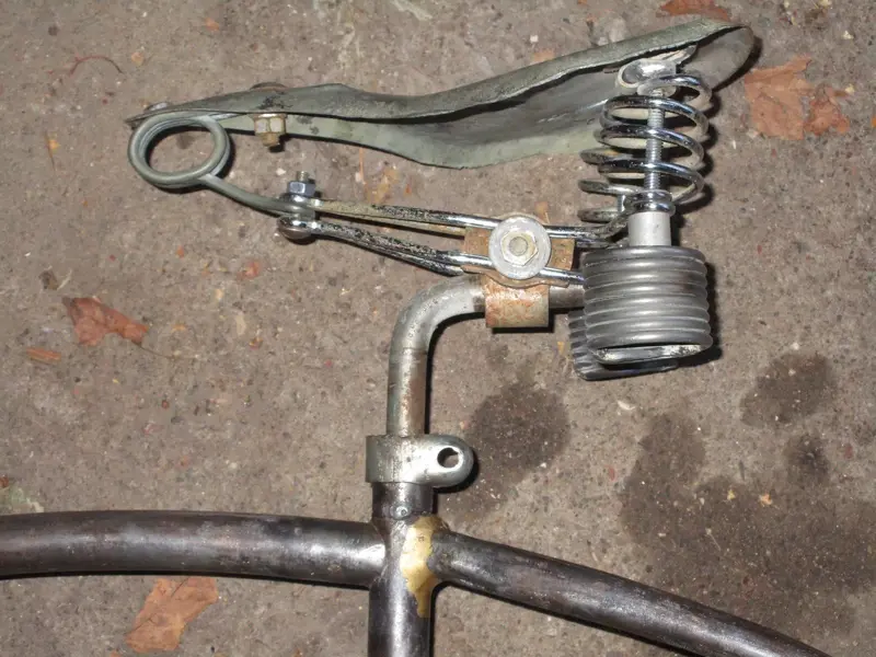

An old woods dump supplied the springs for a homemade seat. IMG_4123.jpeg IMG_4124.jpeg IMG_4119.jpeg

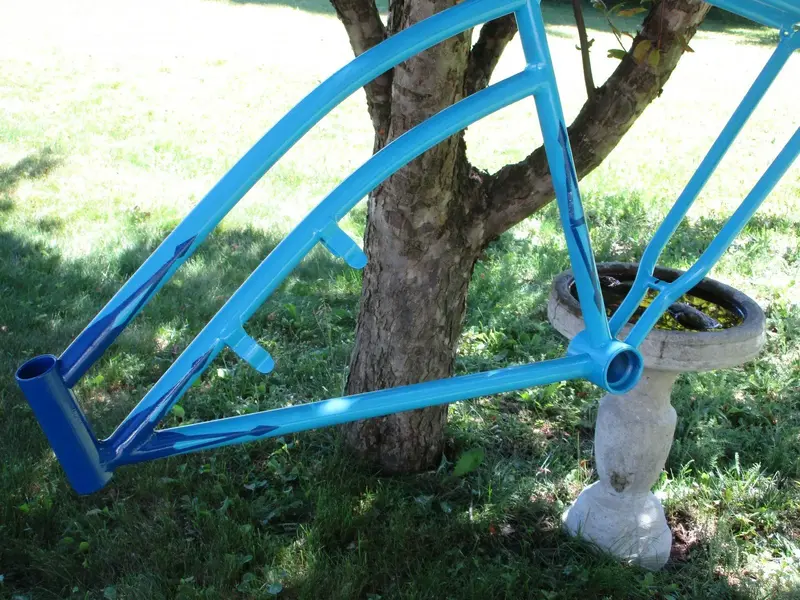

Top coat. Vinyl for pattern placed on base coat and top coat applied. IMG_4125.jpeg IMG_4126.jpeg IMG_4127.jpeg

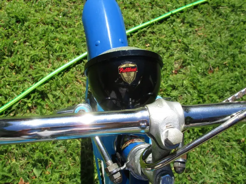

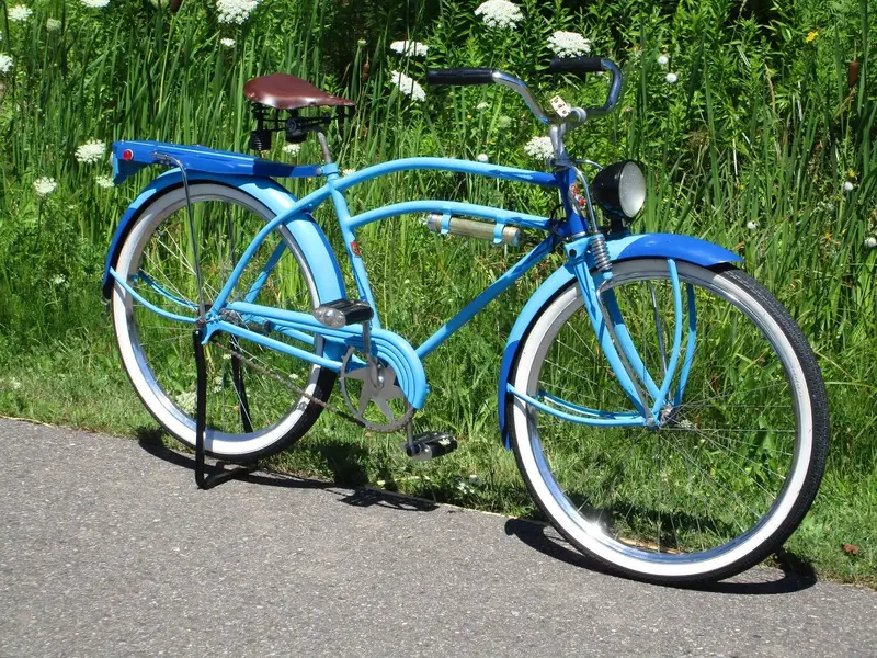

It’s got reproduction 1940s tear drop pedals. The headlight is some kind of a vintage industrial spotlight I got at a Habitat for Humanity builder supply thrift store. The battery tube is from a 1940s brass hand held torch. The bulb holder and reflector are missing. I used cloth covered wires. There is an old brass lock with a long U clasp on the handlebars. Just like I had for security as a youngster. Very grunty gearing considering it weighs around 15 kilos.
