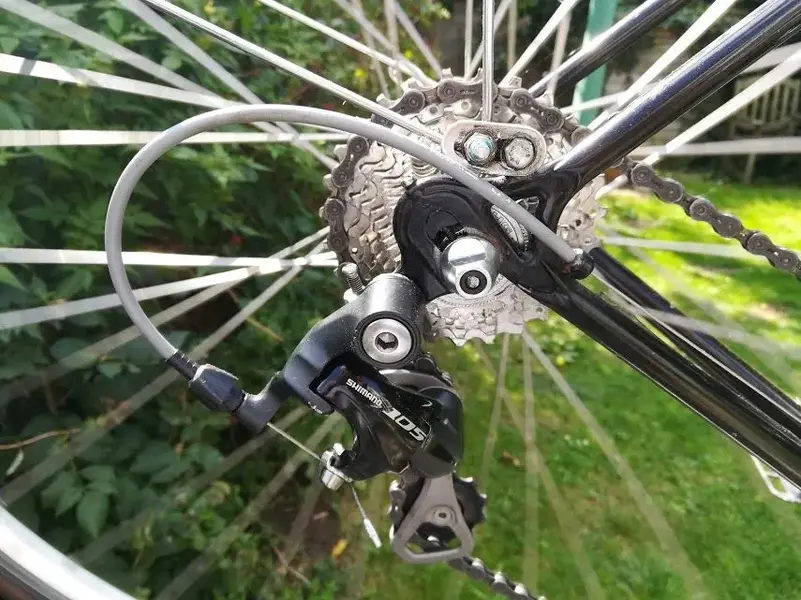

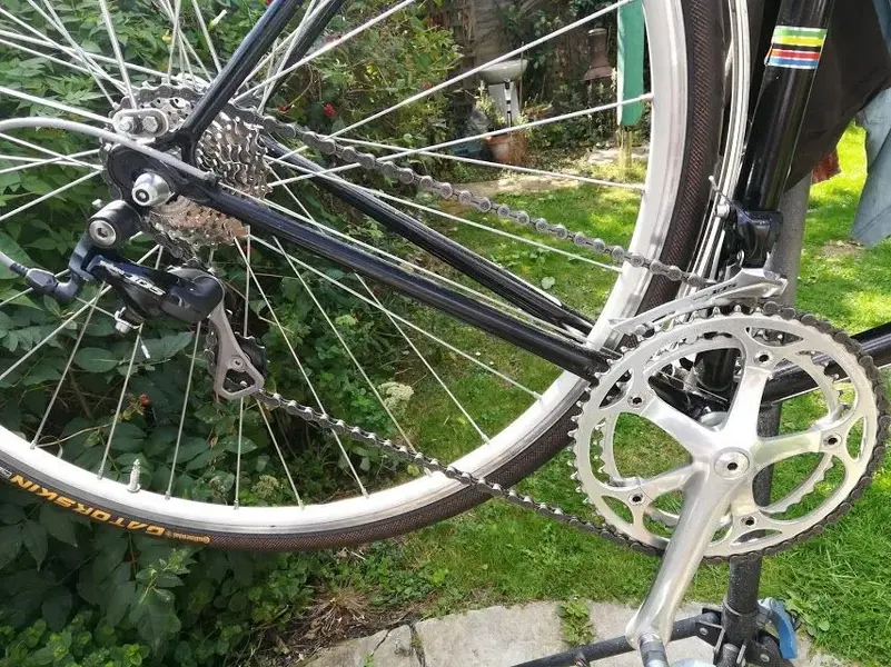

Here you go, 10spd 105 cassette, ultegra chain, Suntour Superbe chainset and 5701 105 mechs.
Shifting is via Dura-Ace 7900 10spd bar-end shifters
Frame is a late 1970's Daniel Salmon

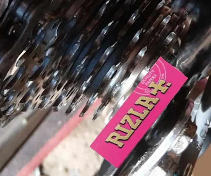

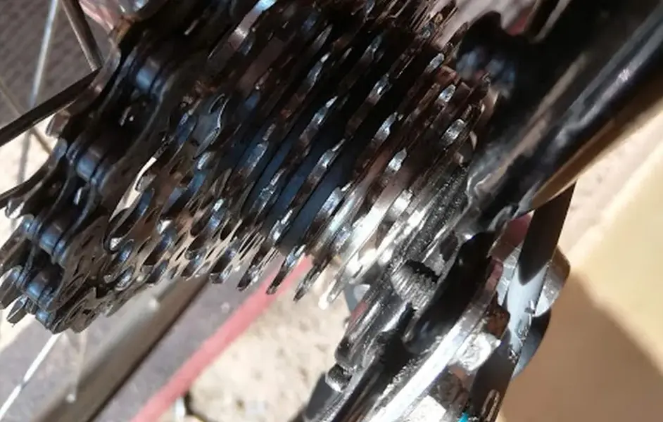

Nice...can you get a fag paper between the chain and the stay in tenth?
Re: 10spd shifting on a old frame
legrandefromage":3t1tub94 said:
In their packet, yes
Go on then, I wanna see a photo with a packet of Vera’s in place... :P
I dont smoke da reefer but a pic will appear. Rear is 126mm with 130mm modern wheels.

Looks like it's got necked/pinched stays/dropouts, should have loads of clearance. Might have been originally built for something with a 13 or 14 top sprocket.

So have you stretched the rear slightly to 130mm or kept it at 126mm? By my calculations I can get 9 gears off a 10-speed cassette onto a 7-speed freehub and maintain the 126mm rear spacing. My frame is alloy with cast dropouts, however, so stretching is out of the question.
Its a steel frame so more forgiving than people often take them for. Most people dont realize that they twang the frame around by quite a few mm when simply removing a wheel. I wouldnt even worry about frames like Alans or Vitus, have successfully run 130mm wheels in these frames over the years.
10spd freehub sized bodies have been around since Ultegra/ 600 8spd days so theres nearly 30 years of suitable frames and wheels sloshing around out there.
Got any Vera’s? Lovely.......
