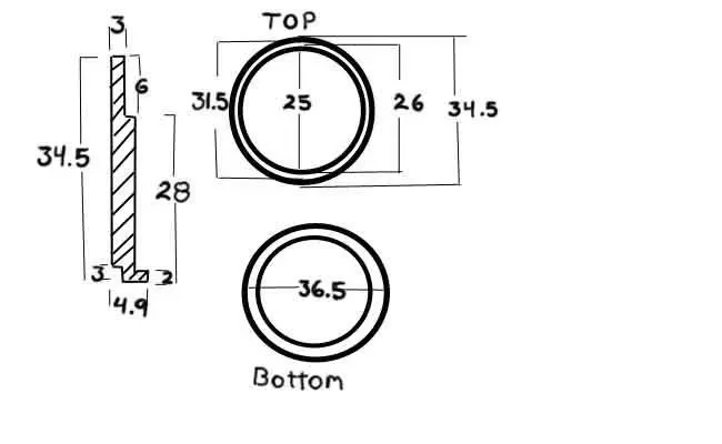

so heres my idea , i have a long threaded steerer on a pair of cheapo forks , if i hack it off , and fit one of these stem shims ( see pic )
it is one of those that are used to fit to a 1 1/8 stem to a 1" steerer , so should be good for the type of forces put on it ( question 1 )
then i am going to get the steerer cut to size and get a groove lathed into it and ft an external snap ring
1 - will it be safe , basically the same as pace does ??
2 - have i missed something important ??
It's something Marzocchi did with the early bombers to drop them from 1 1/8" to 1"
Should be fine.
Doesn't sound like you need one but if you want a photo of an original, can take one for ya.
yes please
think i got it worked out in me head , but a pic allways helps :wink:
got the 1 1/8 steerer so its only the shim i need a pic of , and how they go together
length of shim too please if you can
This should help
Forgot to say it is in MM
And the 3 is not the top flange it is the inner to outer measurement.
The top flange is 1MM.
