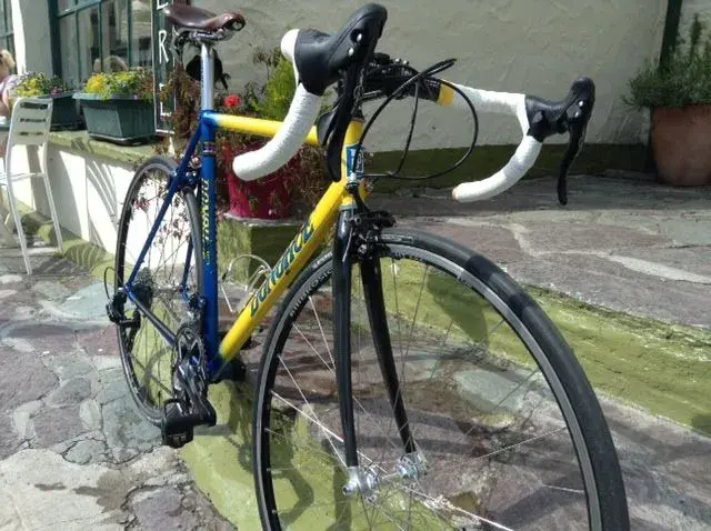

You don't necessarily save loads of weight - I put 1" carbons on my Donahue - threadless, with ahead stem & shim - will try & load some pics later...
Maybe saves 150g or thereabouts (or about 1/10th of a full water bottle)! I'm really happy with the ride, but I was before too - I only really changed because the old forks were not that attractive, whereas chrome forks on a Gios just seem right don't they?!

Here's the Donahue too:

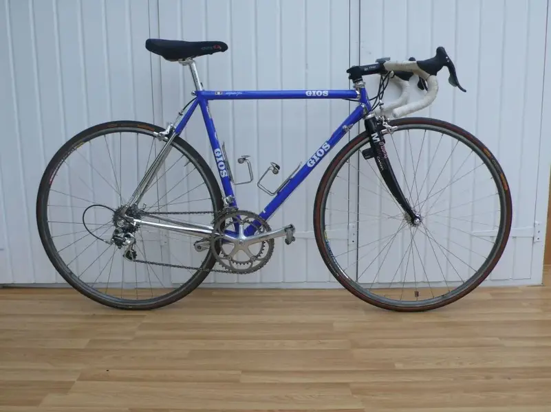

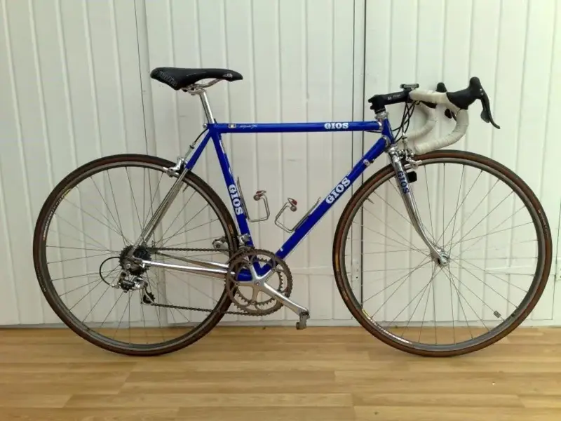

Oddly enough my wife's bike went in the opposite direction. The figures which I weighed at the time were 450g for the ITM Millenium Carbon (there were tons of 1inch carbon around I had some on a C40 and also have a spare set of 1 inch Colnago Force that my Master was supplied with. Intergiry no issue), 670g for the Gios Team. So 220g saving.
