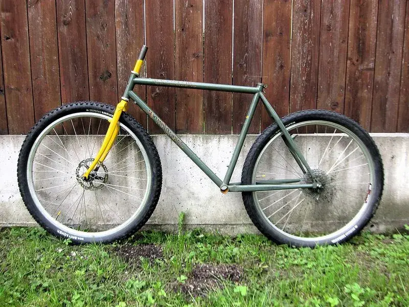

could you give me any pointers which steel frames have really generous tyre clearance? Basically my criteria are steel, clearance, 1 1/8 headset, and not aggressively sloped if possible.
Here is a pic of an older 1" steerer Stumpjumper with 650b x 2.0 tyres, just for reference. Clearance is awesome, something like that would be ideal, but looking for 1 1/8 front. Seems chainstays got shorter later on on many frames. Fork not needed. Not looking for offers, but just pointers would be great. Many thanks.

How strange... i was just pondering what to do with the spare 650b rims and some other parts i've got knocking around. The thought occured of finding another old 26" frame to use... let me know how you get on!
The sliding dropout Voodoo Wanga is apparently quite happy with 650b wheels when the dropouts are slid fully rearwards.
Ideally I'd like to do something like this viewtopic.php?f=6&t=195070 but based on a 1 1/8 steerer because there are more options. Unfortunately many of the newer frames are so strongly sloped, which is not as easy on the eyes for someone who's first mtb was perfectly level at the TT.
Wow had never considered a 1x1. Surly in my mind is always a newschool brand, unbelievable how long they've been around. Now I have to find me one of those early models where the sloping is not as pronounced. They look perfectly like the kind of retro MTB I was imagining.
