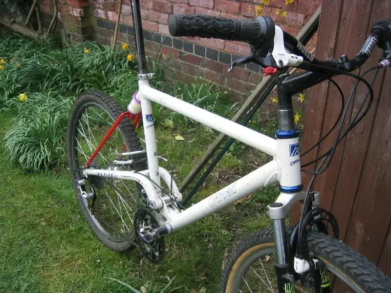

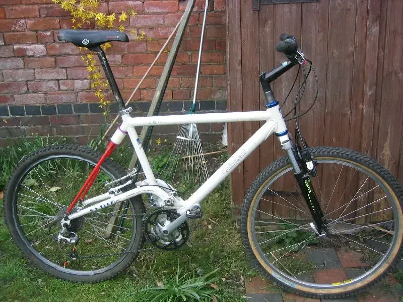

see here on my Proflex 753 (now dismantled). You can see the thread all poking out the top of the headset :oops:
