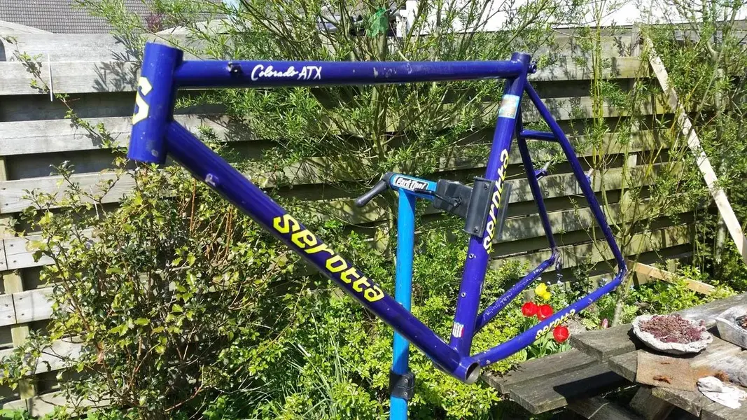

Hey guys!
Time for me to do a proper build thread. I have been on here for quite some time now, but never did. My most recent acquisition, a ‘94 Serotta Colorado ATX frame, was in need of a new coat of paint.

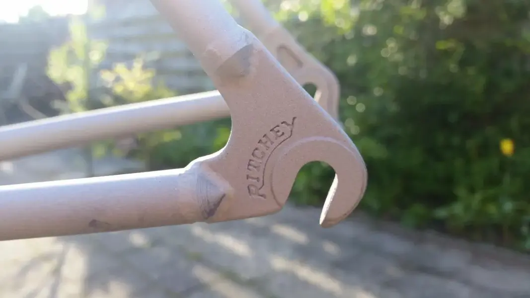

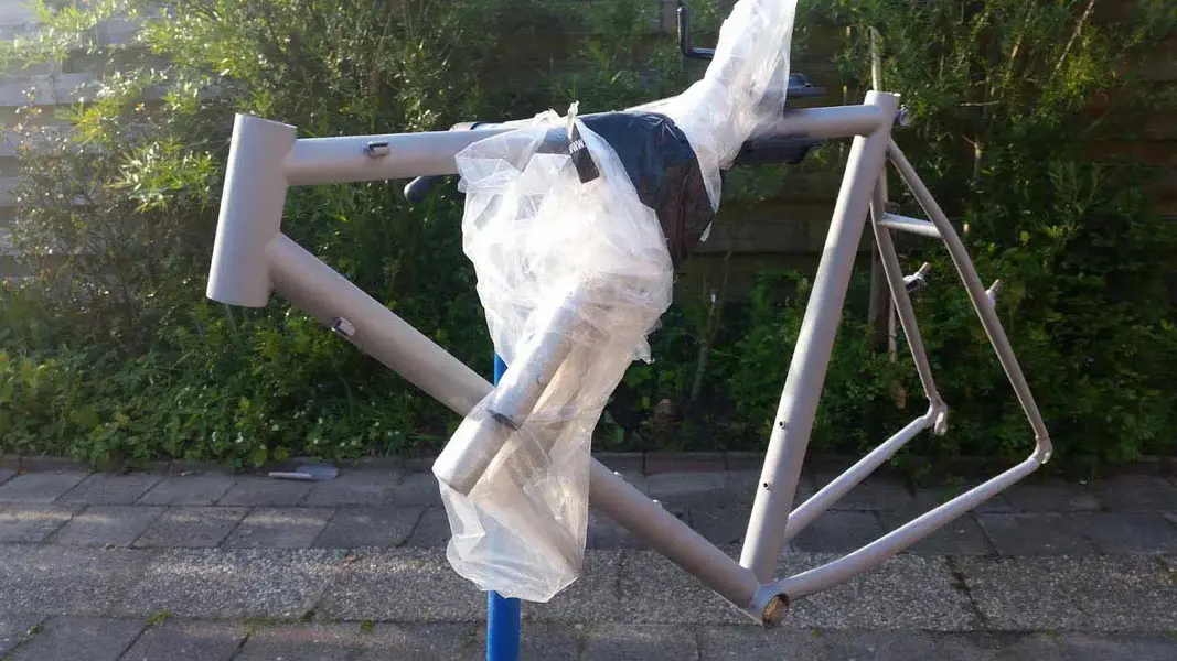

Just got it back from mediablast en now it’s of to paint. I’m not goig for purple but for a Bodacious Blue/Sky King Fade. The Switchblade forklegs and the stem wil also be painted....both in Bodacious Blue.
