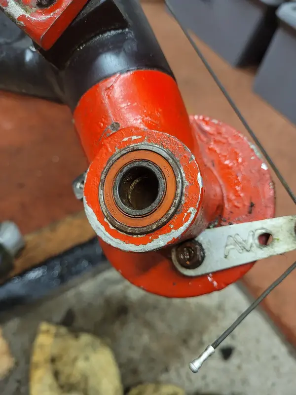

2. I managed to get the front wheel off and removed the brake shoes. These need replacing - I have no idea what spec / size they are (I've never worked on drum brakes before) although I read somewhere that they are Sachs items. Research needed.

3. Managed to get some of the water out :LOL:

Wheel bearings are 16002RS by the way for the rear but the fronts are different (I'll have to check the exact size). Despite the appearances at first glance quite a lot of bits are also available off the shelf.
The drum brakes are Sturmey Archer items and not Sachs. It's been a while since I checked but I think they are 70mm front and rear. There was a time that Mike fitted 90mm versions up front, but they were too powerful and kept tearing the spokes apart on the wheel! You'll need a single sided hub for the front but they are available (for racing wheelchairs and the like).
