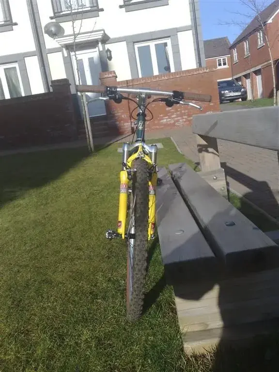

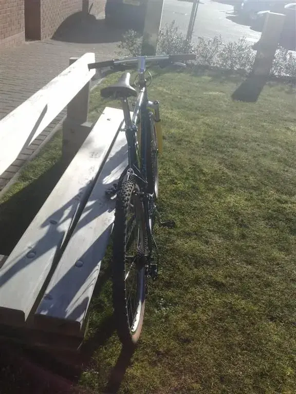

1996 Bontrager Privateer - NOW COMPLETE!
cce
Keith's Finished....
Frame: 1996 Bontrager Privateer size XL
Fork: 1995 Judy SL with Kronos coil springs
Headset: FSA Orbit
Stem: Kore
Handlebar: Generic silver alloy
Grips: Brown specialized ones
Barends: n/a
Brakes: M563 LX Cantis
Brake Pads: LX Front, Jagwire rear, soon to be LX all round
Brake Cables: Cut beautifully by agency_scum
Cantilever cable hangers: Fibrax
Brake Levers: LX M563 STIs
Shifters: LX M563 STI
Front Derailleur: M563 LX
Rear Derailleur: M560 LX
Derailleur Cables: as brake cables
Cassette: SRAM PG850
Chain: SRAM
Cranks: Sugino Impel 700
Crank Bolts: Generic
Chainrings: Shimano top, middleburn middle, sugino bottom
Chainring bolts: Generic
Bottom Bracket: UN72
Pedals: M520 SPD
Hub Skewers: Shimano LX
Rims: Mavic 238
Hubs: Sovos front, M563 LX rear
Nipples: Brass
Spokes: Ordinary
Tyres: IRC Notos XC
Tubes: ordinary
Saddle: Custom brown vetta TT trishock
Seatpost: Fred Salmon
Seatpost Binder: Kalloy :(
Weight: 25lbs?
Keith weighs 5.6lbs with his BB and headset cups in.
Keiths's partner judy lacks bounce.
Whereas Richards partner Judy has lots....
..maybe they should change position sometimes so she doesn't have all of his weight on top... :wink:
Or give her a good work out. No, not that way. Just some mechanical overhauling..
it's no wonder judy is feeling down.... one leg has three elastomers in it, the other has none at all.

time to make this a little bit more sensible. Keith's a 1996 Privateer.... which technically means he is a trek. oh dear. still. he looks cool, and this is what matters.
Keith will be built with a black LX group, including cantis. i have some redwall IRC tyres and my DIY brown saddle to go on.
Call me silly ( oh go on ) but aren't those re-badged RST forks? Look at the top caps on the legs.
Sh1t Keir, that's gotta be the BEST paint scheme Keith ever did.
