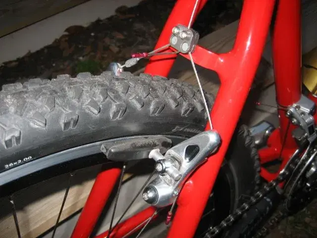

Don't forget that Cannondale realized how crappy these things were and begain selling "Half-Pipe" cable hangers for their frames, through dealers, to folks who wanted a more normal cable routing. Half-Pipes were Cannondale parts, and bolted to the Force40 mounting stud as a direct replacement to the F40.
I've got a Force40 on the front of my Beast, just for kicks, but the rear brake is a legit hanger... My 'Oh Crap' insurance, if you will... 8)

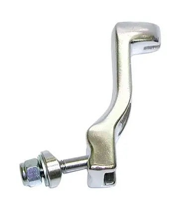

For example... Uglier than a Half-Pipe, but same function.
PurpleFrog":1hdbl63l said:
Don't sjs sell a Tektro near clone of this? The Tekto Power Hanger???
