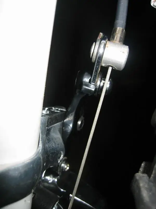

Dunno what this is called but I urgently require one for a frame with no braze on cable stop so I can run a BP front mech....can anyone help?
These were fitted to Trek 8500's BITD

FluffyChicken":1m6wu89a said:
Where on the frame does it go... (trying to think how it helps run a b.p. front mech ?)
Like this mate :wink:

That's novel, never seen it before. I assume the other end of the cable bolt into a nut in the frame somewhere.
Seem to remember hub (sturmey) gears doing something similar or maybe it was a petrol lawnmower throttle.
Loops round a bolt and back up to mech....the cable stays still and the outer moves ( :shock: ) so I've been told.....I think I know how it works but yeah, its weird.
Sure should do, allowing you to run a BP mech from a top tube routing. Was gonna suggest the same. .
Or, set up an ebay search for a yeti front mech. They had an XT with a similar arrangement to what you spotted on the trek, prior to them moving to rollers.
Having used all solutions listed above, I can confirm they all work ok. Just a question of what 'suits' your build. . and I think I know which one its for :wink: and a TP f/mech probably isn't for you :-)
