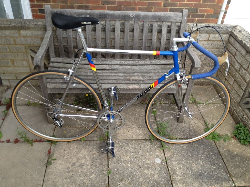

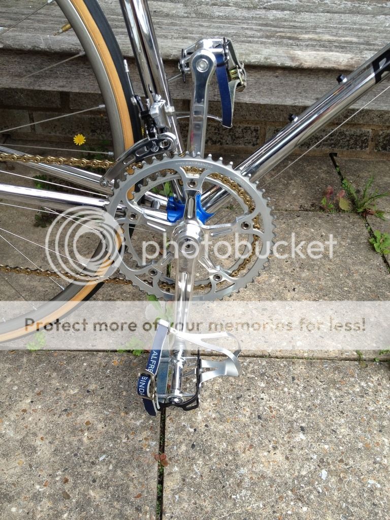

Had this beaut for a while only just got round to taking some pics. Full Super record Ti kit. Built with the lightest spec around in the mid '80's

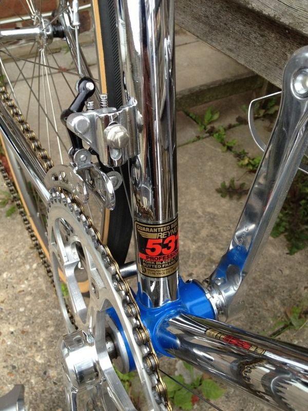

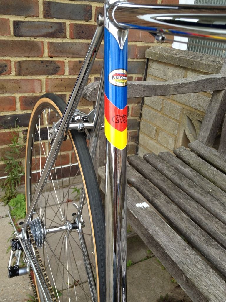

Reynolds 531pro tubing.

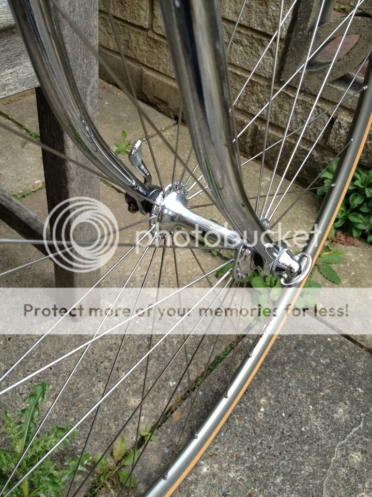

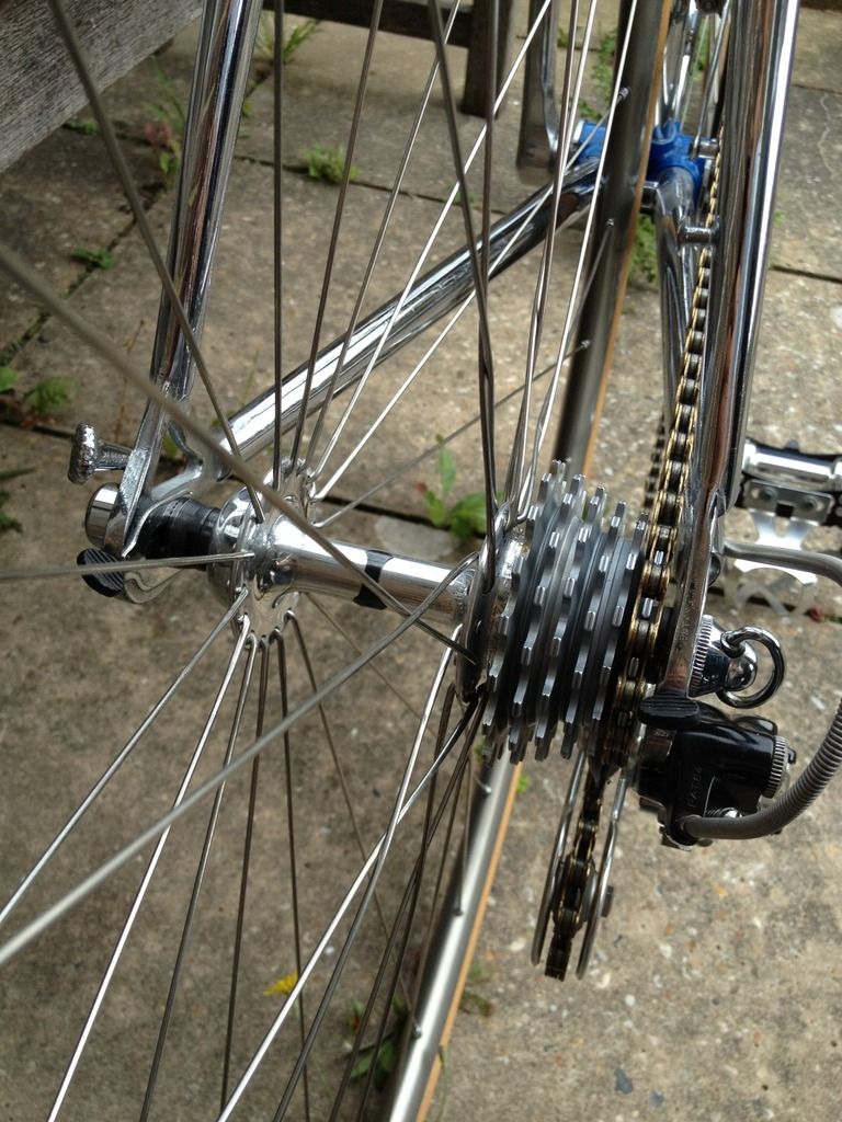

Radial spoking on front and non drive rear, 2x on rear drive, alloy nipples. Built this way for the shortest possible spoke length and in turn lightest weight.

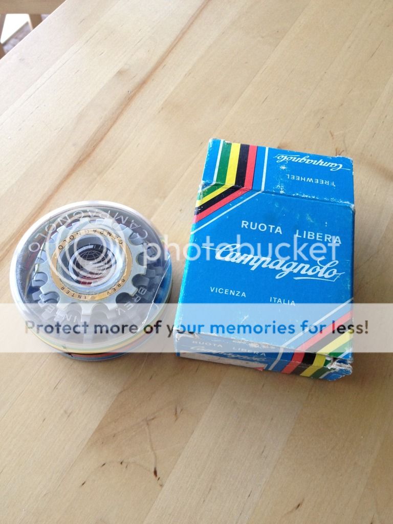

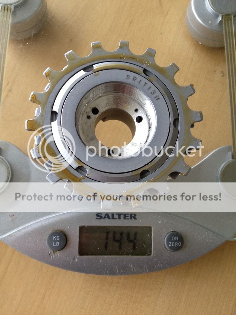

Nos campagnolo full alloy freewheel. $280 new in 1985!!! never taken out of its pod until now. 145 grms, that's light!

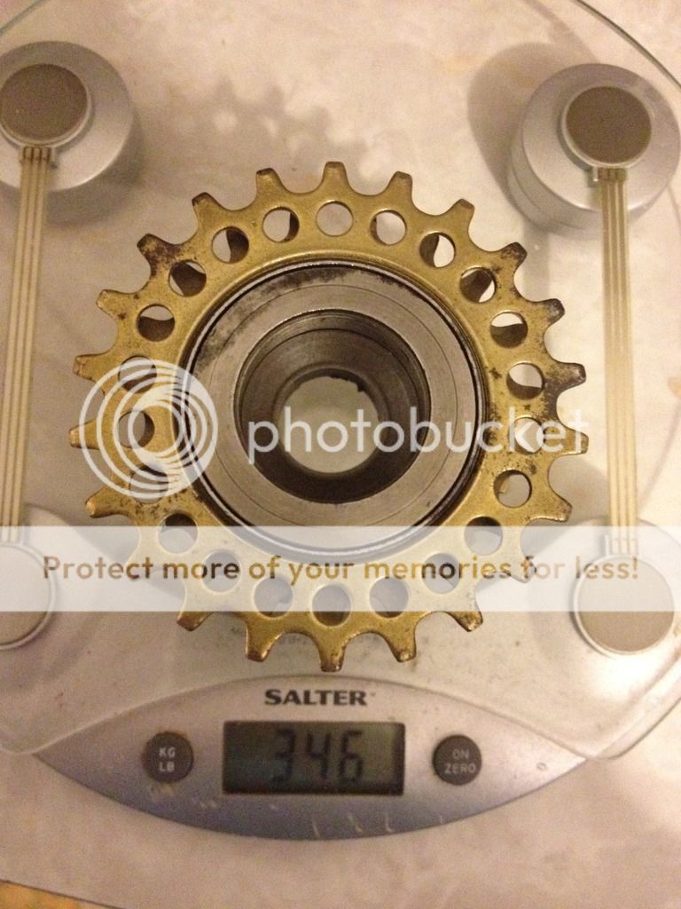

A decent nos regina oro for weight comparison, 200grms more :shock:

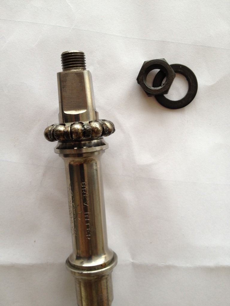

Finally a nos Ti axled second generation (the ones that don't snap!) SR BB
At 18.4lbs I'm happy
That is simply devine! Beautiful bike, would love that in my shed, in fact it would be in the living room! It'd save me so much money on a tv license and sky subscription. I'd look at it for hours at a time :D

The frame was dismantled when new in '85 and stored in a German guys warehouse and then forgot about. It was only found at the beginning of this year still sticky with wax from careful storage 8) It originally had SR record parts.
It does get used, gently of course when the sun decides to show and is absolutely brilliant to ride!
