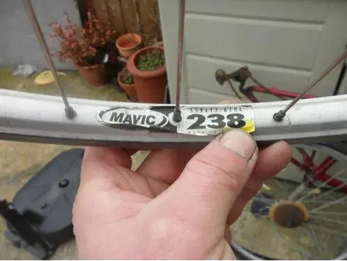

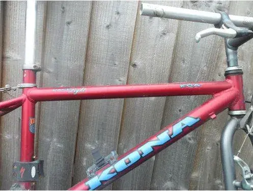

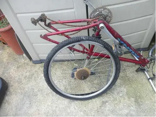

So the pictures on eBay did not lie. This really was a pile of bike bits, but for the money paid I really couldn't complain!

So I stripped down the bike totally - except the bottom bracket and headset - and gave everything a clean. A good clean to get rid of all that rust etc.
That got me to the stage shown in the following pictures.

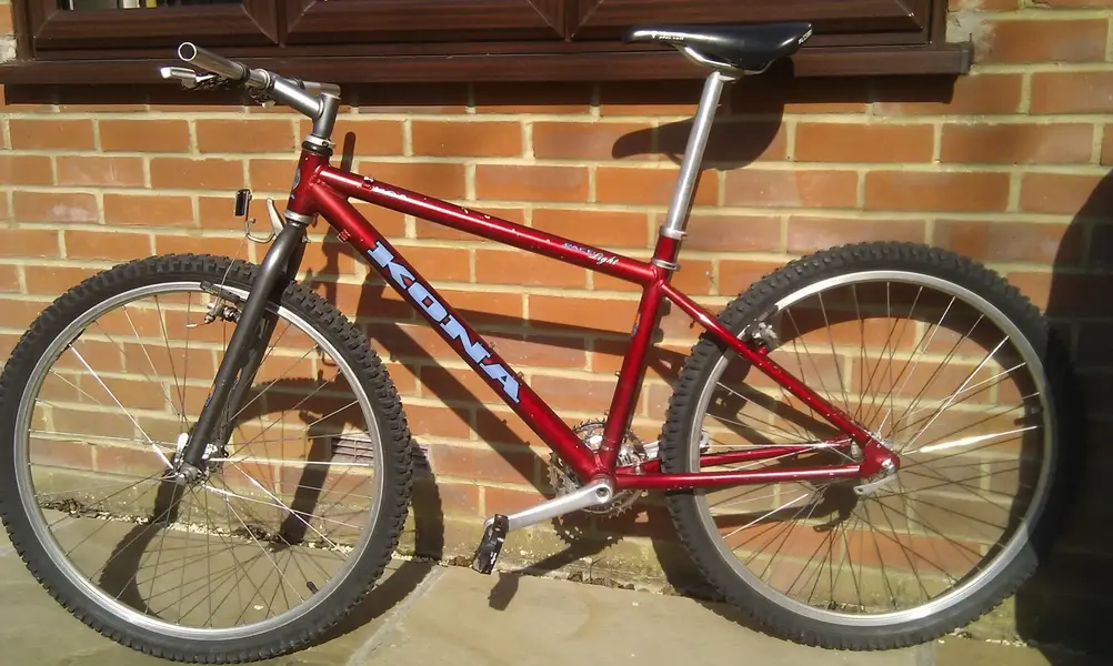

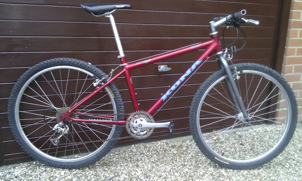

Now I had been toying with the idea of making this a single-speed project bike. But riding around a bit without shifters and cables made me realise that I needed some gears. So I decided on losing the front mech and running the middle chainring with the existing 7-speed cassette.
So cost minimisation was the name of the game with replacement parts. I picked up a 7-speed Sunrace rear shifter new on eBay for less than £10. I'd never heard of Sunrace before. It seems that they bought the IP of Sturmey-Archer and moved manufacturing to the fast east. I wasn't expecting much, but I was impressed that the shifter installed and worked straight away.
Fortunately the stock Kona brake levers still worked smoothly. So they just needed new inners and outers.
So now I had a working bike with 7 speed.

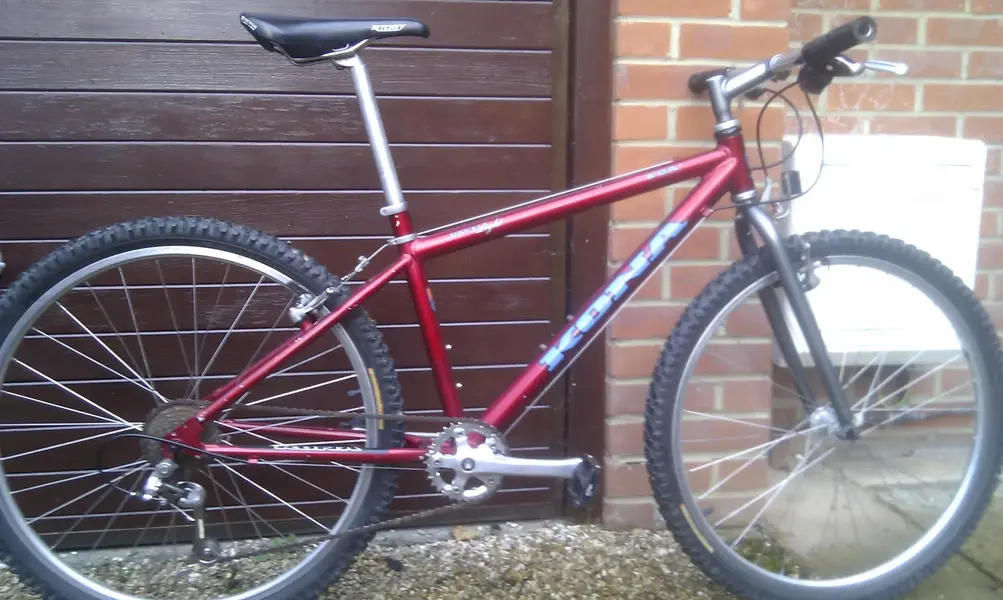

The bottom bracket was replaced (upgraded) with a Shimano UN55 unit. The old unit had rusted into the frame and was, apparently, problematic to remove. Threads needing rechasing etc. Of course, now there is no play and the action is smooth as ever.
The headset was more problematic because of the low stack height. In the end I decided to just have it cleaned and the bearing replaced. The races are slightly pitted and could do with replacing. But I wanted to keep the Kona headset.
While the chainset was off for the BB replacement I had the granny ring removed. I then removed the outer ring myself. I found that I needed to pack out the installed stock Shimano STX chainring bolts with 2mm washers.
I'm amazed what a difference removing the chainrings has made. The bike 'looks' really different now.

2. Paint. Whilst a total respray would be nice it's out of budget. So I might have to resort to spot fixing.
Looking good! I agree with Travill that it needs to be locked up. It really doesn't look as though it would benefit from repainting - I think you'll be pleasantly surprised by how effective a bit of minor paint repair will be. The only downside being, you'll then need a bigger lock.
