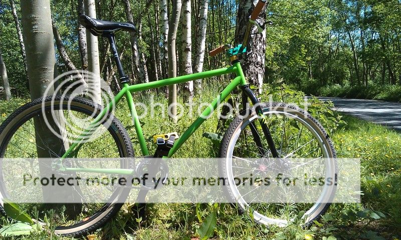

I got into SS a little bit more over the last few years, I got rid of my SS 'Jump bike' and built it into an 8 speed Cotic as I'm too old and too big for a bombproof tight 13" frame and needed something more trail orientatied (didn't stop me rebuilding a DMR Ryhthm with left overs though! :D ) so I had a SS rear wheel... :D :idea:

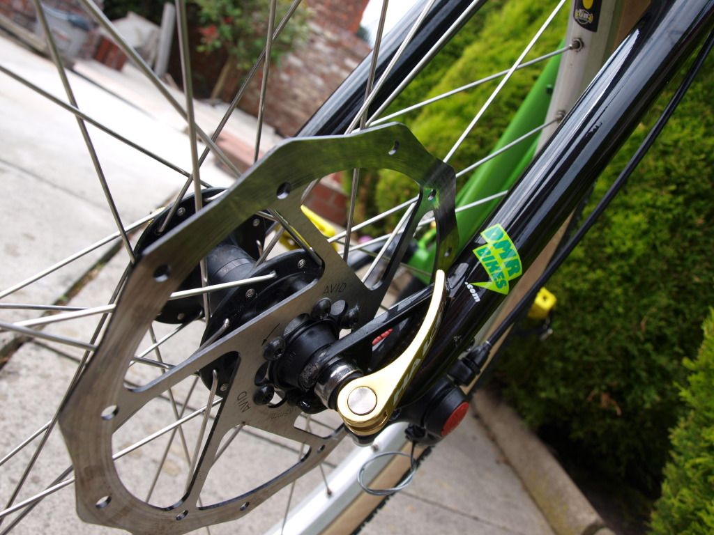

It started with the idea of using a Velo Solo Disc Cog and not a rear brake, but before that even got bought, parts kept finding their way to me! I got Light DMR OW Forks in a combo deal buying bits for the Rhythm so a wheel and some forks and odd parts bin bits, I almost had a bike right?! :D

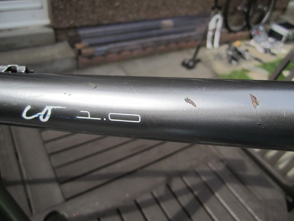

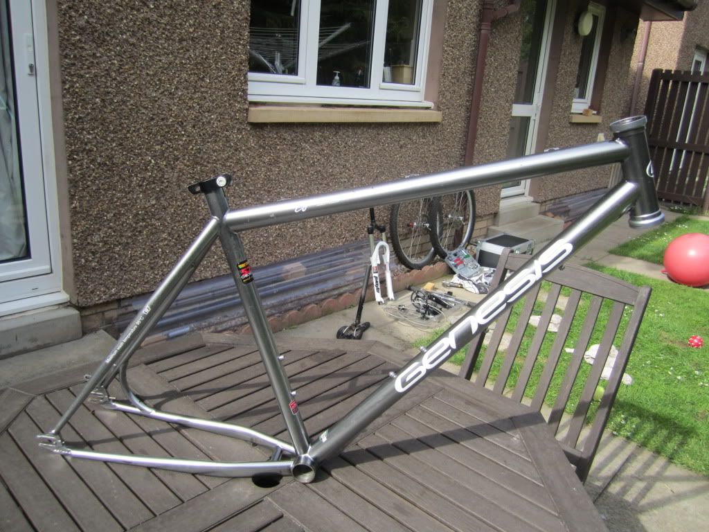

I've loved my Genesis Day One, so when a rough looking IO came up on here, I went for it and struck a deal last summer! :D

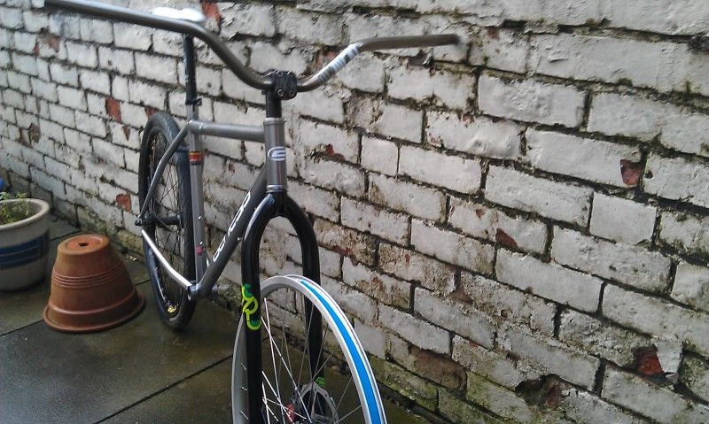

and a mock up, at this point I wasn't sure if it was going to be a ghetto budget build, and stay the same...
DMR OW forks, and the BLK MRKT bars actually bought for the DMR Rhythm didn't suit it which worked out well as I had lovely light cromo skinny bars for this!

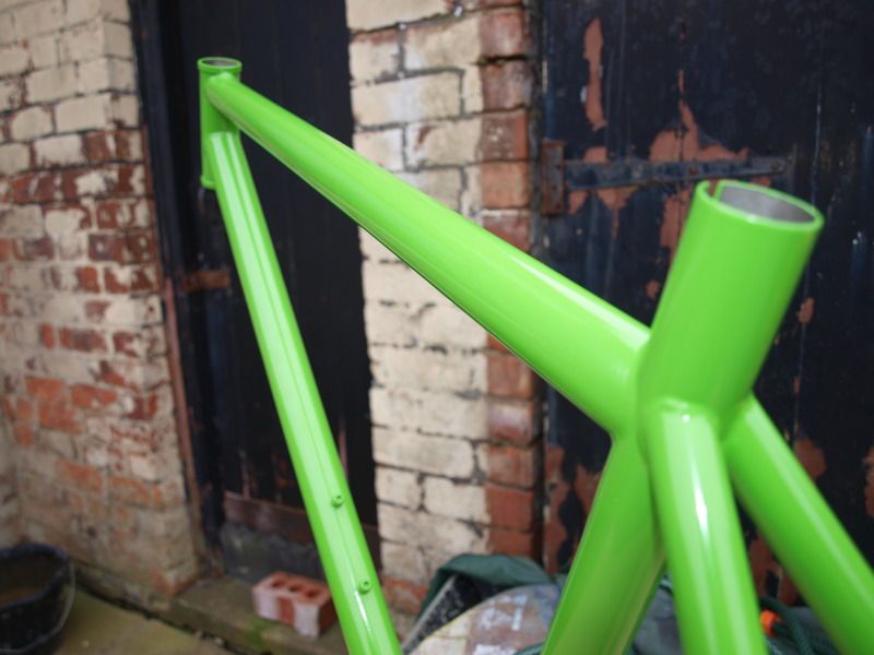

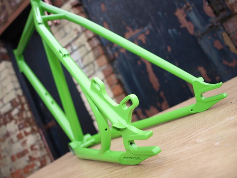

There was already a small dent in the top tube and the disk hose guides were bugging me so thouse got deleted after months of pondering! I did a fairly tidy and safe job of it...
Earlier this year IIRC I made two trips to Triple S in Keighley based on reccommendations. Price was slightly more than I expected and the colours were more limited than expected, however, great place and lovely finish, really happy with the mega loud Kawasaki Green!

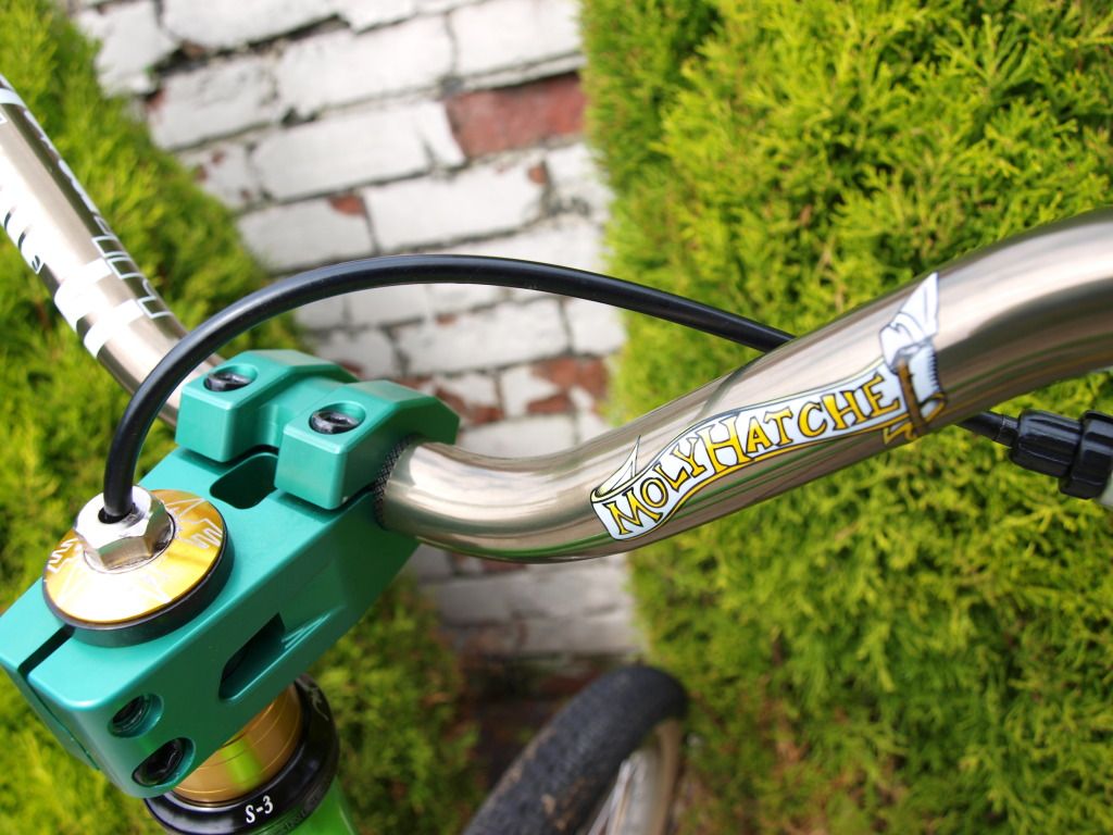

Molly Hatchet Black Market bars, now chopped down from crazy wideness! still WIDE knee bashers though. :lol: Speaking of which, internal cabling allows bar spins!

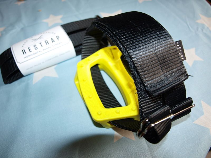

Foot straps I spent a while looking at, I proudly opted for these Yorkshire made Restrap items! 8)
and some marked down Eclat 'plastic' pedals, surprisingly grippy specially with the super straps! retroish shape too.

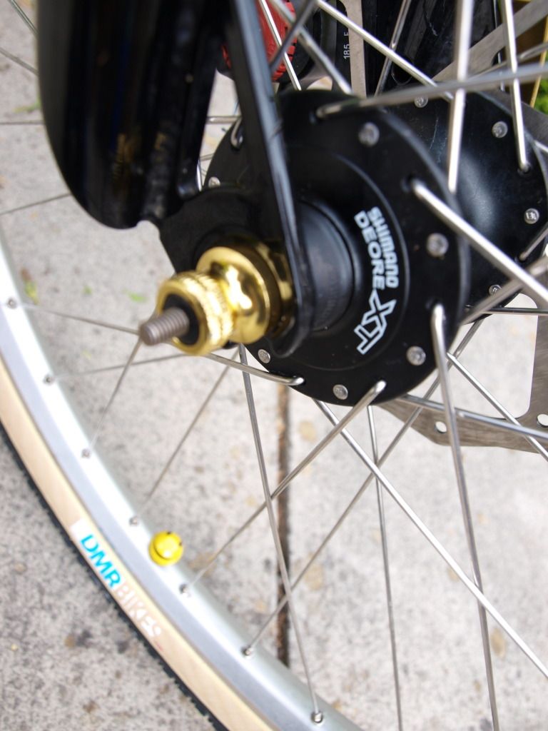

The final wheel/Fork set up with Halo Skewers liberated off my Muddy Fox, also light Folding tan wall DMR Supermoto

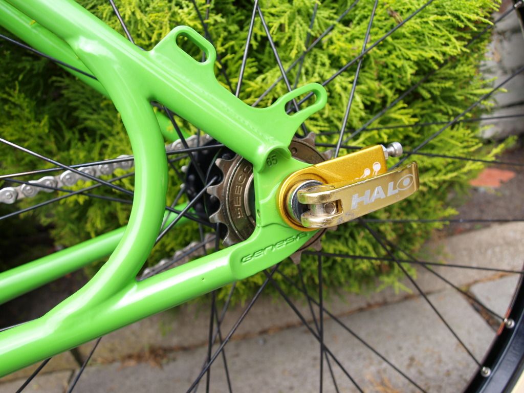

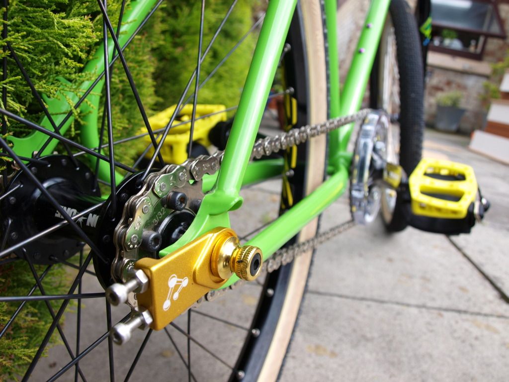

That Velo Solo bolt on Cog set up!
Chain tensioners were the last thing I bought, the Genesis, weedy adjusters b0rked on the original frame removed by me, and it wasnt holding tension so good on the test rides, really feel chain baggyness on a FG, first impressions are good now with these fitted, will keep an eye on them to see if they work OK with QR's

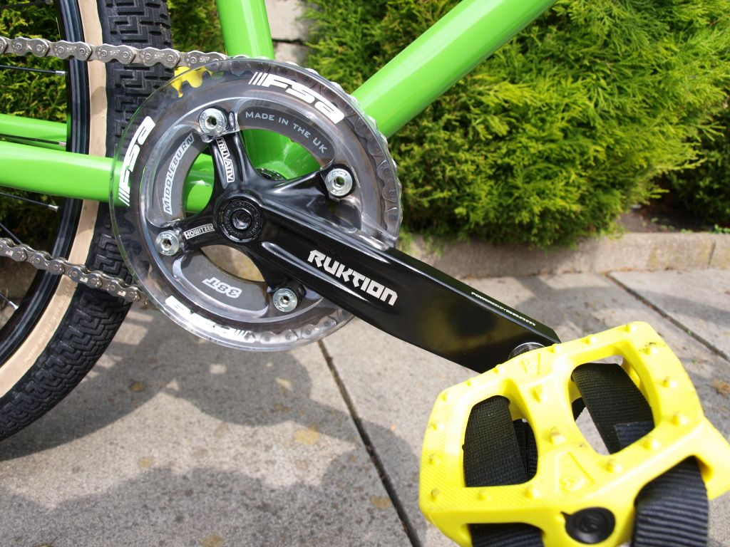

Cranks, I really went round the houses on this search, length, type compatibility!!?? Apparently shorter cranks are good for spinning and gurus swear by them, also ground clearance is a bit of an issue but less of an issue than road frames, I have long legs but I was still weighing up 170 vs 175, in the end these new super tough through axle Truvativs were 165's! Downhillers would love these! So far good and interesting.
Final disk set up, just one brake. God knows how they get on with No brakes! :?

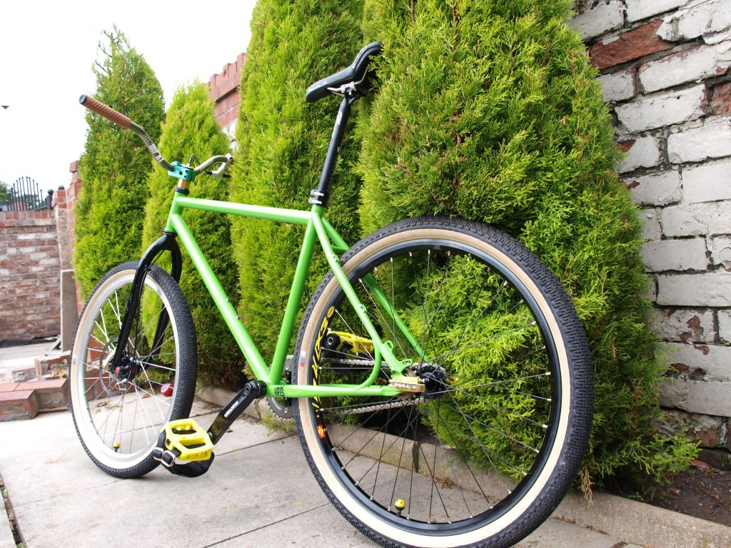

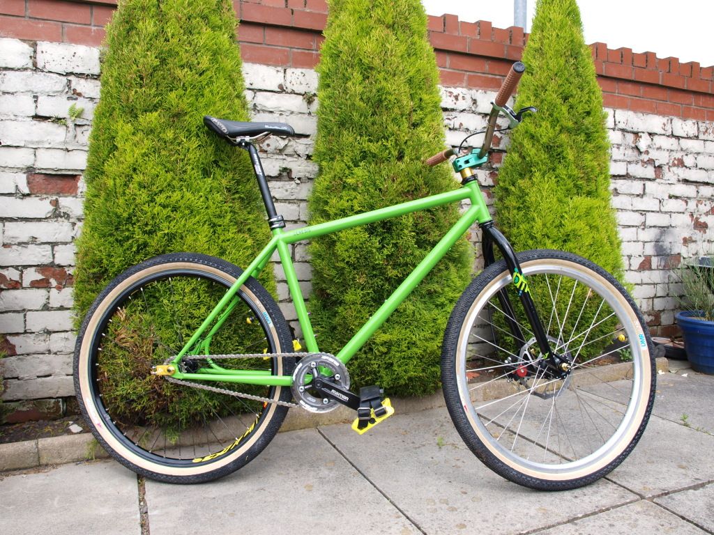

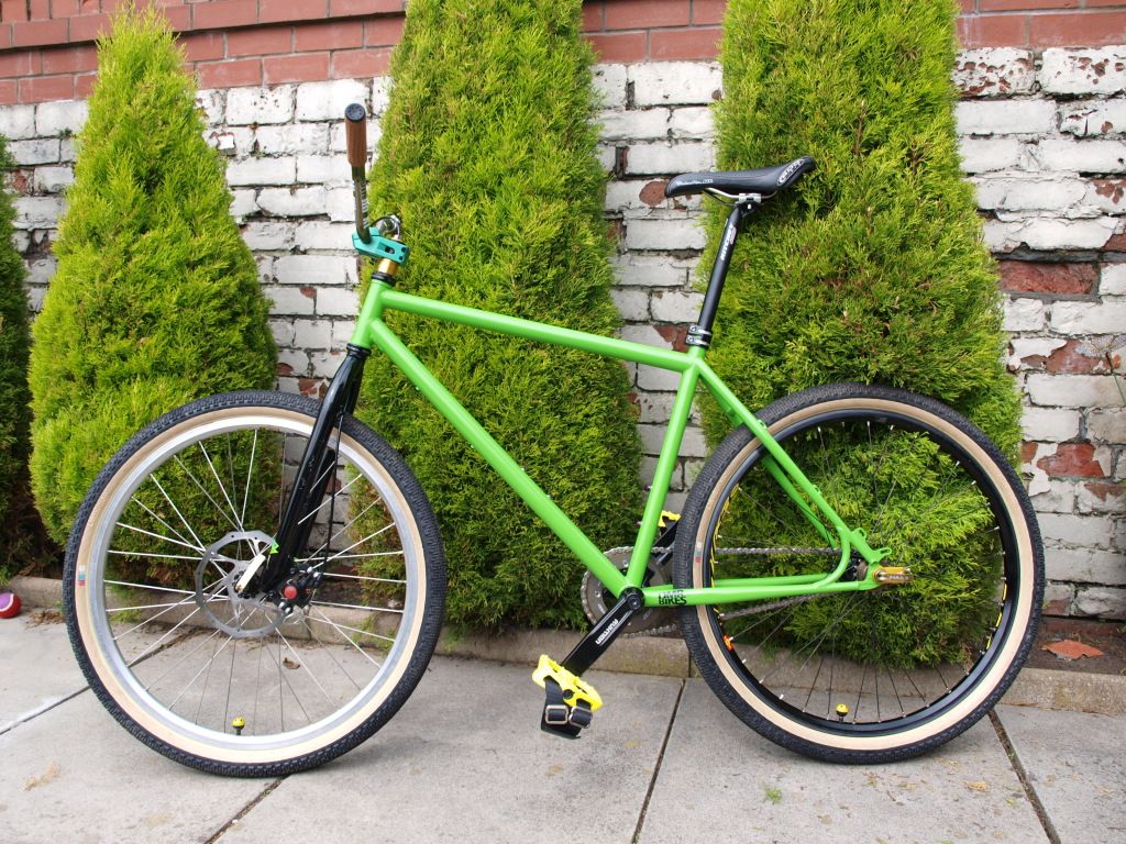

Finally a complete long shot

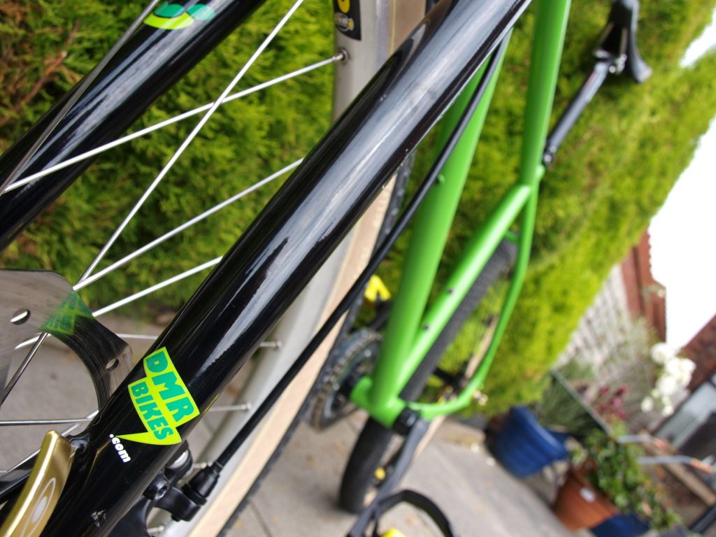

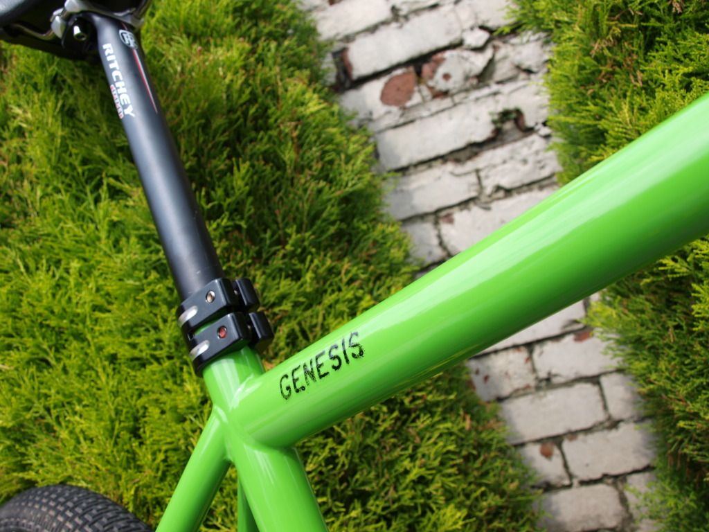

A finishing stencil and a brand new quality Ritchey seatpost as the Easton had unglued itself on test rides!!

I'll report back with my ride experiences so far... :lol: it takes some brain training and isn't great for my back/hip/leg tension skidding, but quite good fun and a new experience!
I quite like that. With the skinwalls it has a BIG BMX look to it. Bet it's great fun to lark about on.

Hiya, thanks for the nice messages, it is a bit like a big BMX it would be if I could trick it properly! It's got a short rear with this gearing and a compact ish frame for my size, though a 17 would be even BMXier!
Yep the whole build was a mash up of inspirations, the freestyle fixed guys, they are largely nuts, I love watching the smooth and creative riders rather than the heavy hard big ball huckers! Their bikes are getting smaller now with tech tricks. In reality it's hard to ride. Very difficult to bunny hop. Usually I guess you'd start on a light big wheeler on skinny tyres but guess the new scene generation start out on wide tyres 26ers. The guys run no brake on the majority! When you've ridden fixed, as many of you would have, no brakes is a tad nuts. Uphill is really good but down eek! I find it's an all new skill being involved slowing down the downhills, and the skids pull muscles! Lols! :lol:
