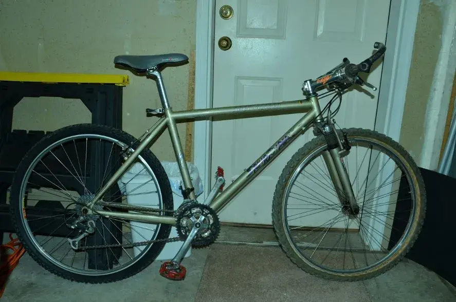

Here's a crappy pic from craigslist of the bike, I'll post more that show the detail of its war wounds. The rear umma gumma was replaced unfortunately but it came with the front (which is rock hard and probably unsafe to ride, laugh!). :oops:

We_are_Stevo":3rgy72ue said:
Nice bike, though the fork in the photo' is a Judy not a Mag 21... :?
You know what, I thought it was a bad photo, but you're right of course now that I look at it again. The guy I got it from told me it was an old photo and his dad had replaced the rear wheel and tire since then, but now I'm wondering what happened and what else was swapped out.... sheesh.

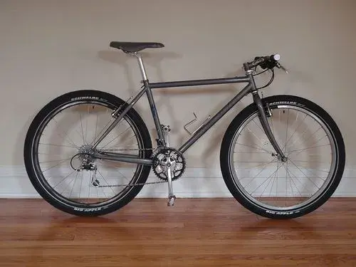

Hmmm. I agree it certainly looks like a 1 1/8" steerer in the photo... but i happen to have a steel S-Works from the same year and it actually has a 1" steerer. (the Ibis stem on there is an 1 1/8" with a Thomson adapter underneath)
Would the S-Works be different? I would have thought whatever my S-Works was, the steel Stumpjumpers would be too. But maybe not? The dropouts, tubing size/shape and SP clamp seem to be the same for whatever that's worth.

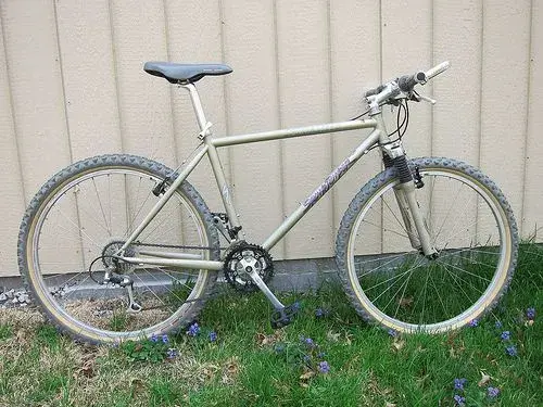

Specialized had Future Shock versions for both the Mag21 and the first Judy models of Rock Shox. This guy's post on MTBR shows pictures of both 'SL' versions in all their carbon exoticness:
http://forums.mtbr.com/5643046-post3.html

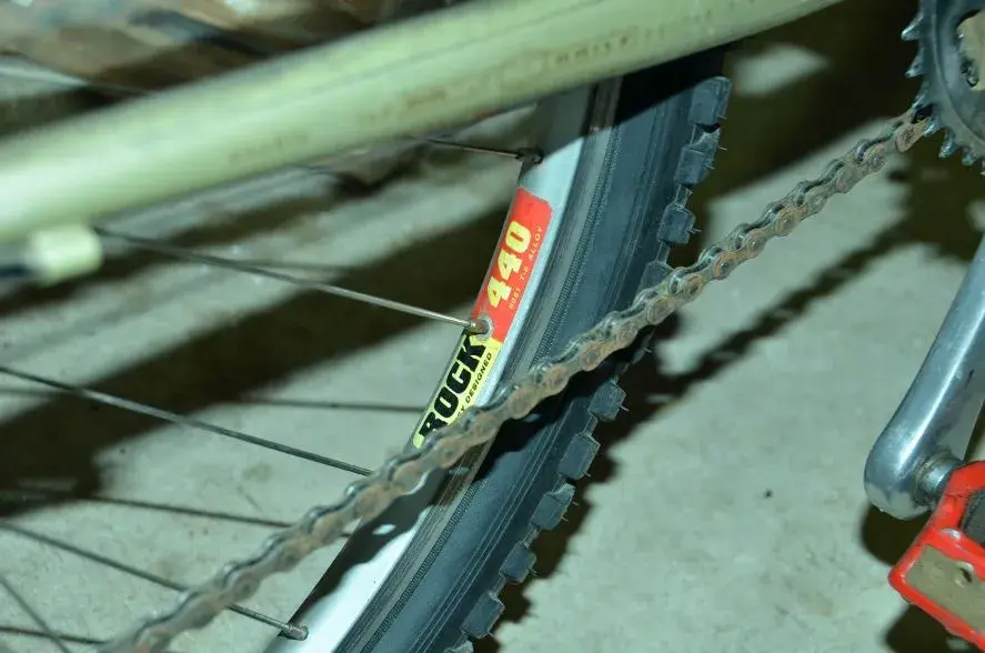

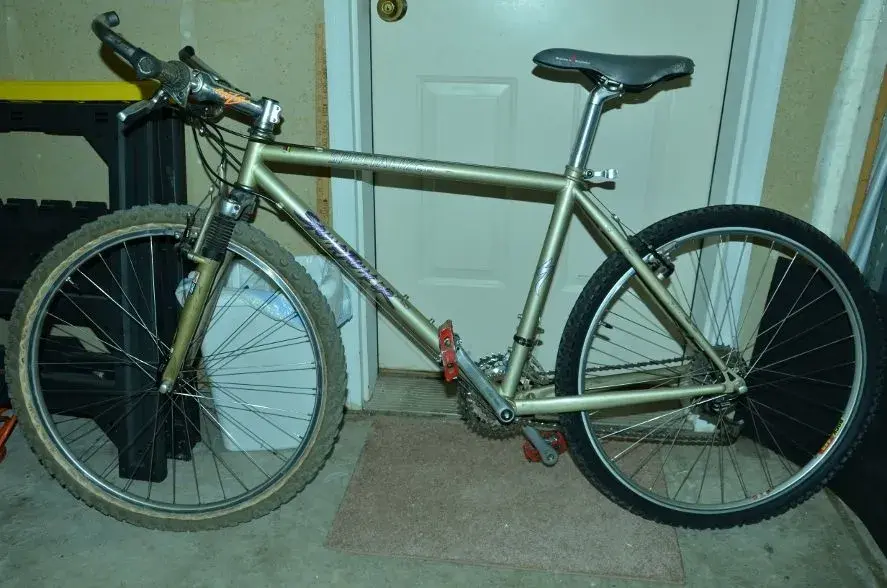

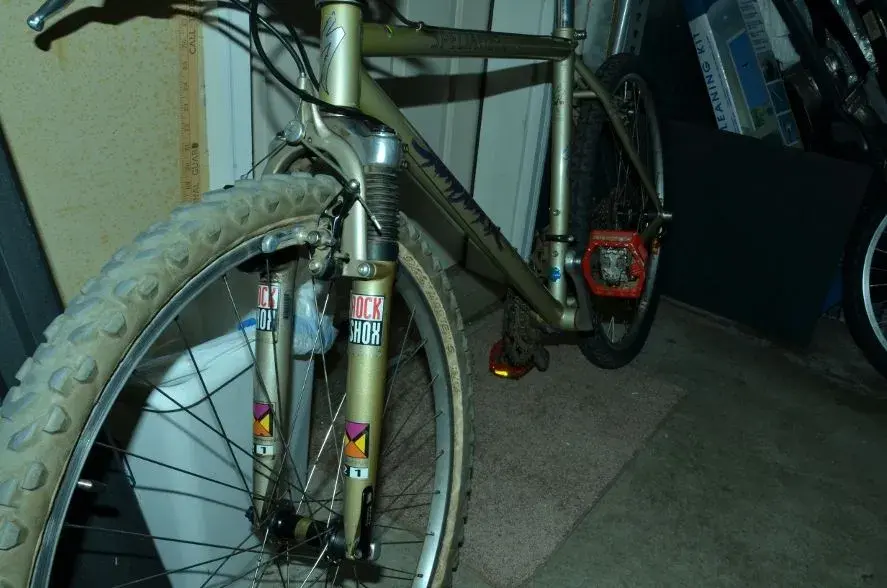

OK, here are actual pictures of the bike in my basement, not the ad from the seller I bought it from on craigslist. :roll: Now what say the group?

Huh. It looks even more like 1 1/8" from the close ups. Maybe my S-Works is more different than i thought. A 1" HT bike in 1995 was rare either way. Best way to be sure is to measure...
Other than what you've already pointed out, the bike seems to match the Bikepedia posted specs pretty well actually. Nice.
Unless I'm mistaken, those Mag21s just need a bit of air to prop them back up again. Assuming nothing is worn out of course. Under the top caps there should be a valve. They do lose air over time.

No, it is a 1" - all of the last gen steel S Works were, designed really to be used with their 650g steel fork (yes, its a little flexy). I guess part of the reason was probably that they had some of the steel parts to hand and just specced the main tubes. The other bikes in the range that year were all 1 1/8", with the exception of the S Works Ultimate (ti/carbon this year) which also happened to use the same fork, perhaps another reason why.
