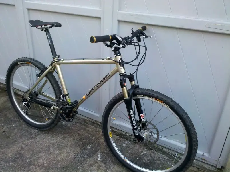

Just wondered if any Orange riders to help with a slipping seat post problem. I have a 17" frame with a Ritchey 31.4mm seat post clamped with a Hope seat pin QR but I am unable to stop it moving around?
Do I have the right diameter?
Any help appreciated

Thanks I'll have to get hold of a 31.6mm seat post. I only got a 31.4mm one because the original Orange Stalk Lite seat post was that size.
That explains why it won't clamp tightly. I thought it was an odd size. More manufacturers to choose from as well in 31.6mm.

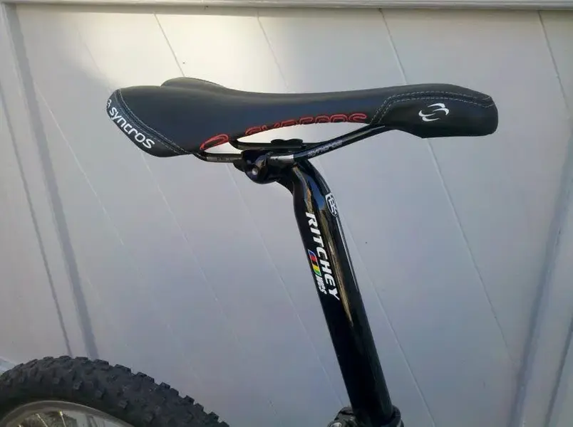

Just bought a new Ritchey WCS seatpost size 31.6mm and it fits perfectly and no longer sinks during rides.
Thanks for all the advice and messages regarding this matter.
Still don't know why Orange supplied it with a Stalk lite 31.4mm post?
