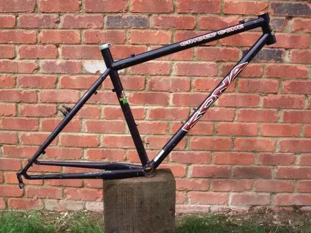

I'm planning on making my own frame based around Kona geometry, the size 20 Explosif I have is a little large, so I thought I'd try something smaller - a 98 Cindercone to see if the size / geomtery works for me.
Ebay turned up an 18" Eggpant Surpirse 98 Cinder Cone, complete with stuck steat tube. 10mins with the seat tube in the vice and turning the frame and it was out.

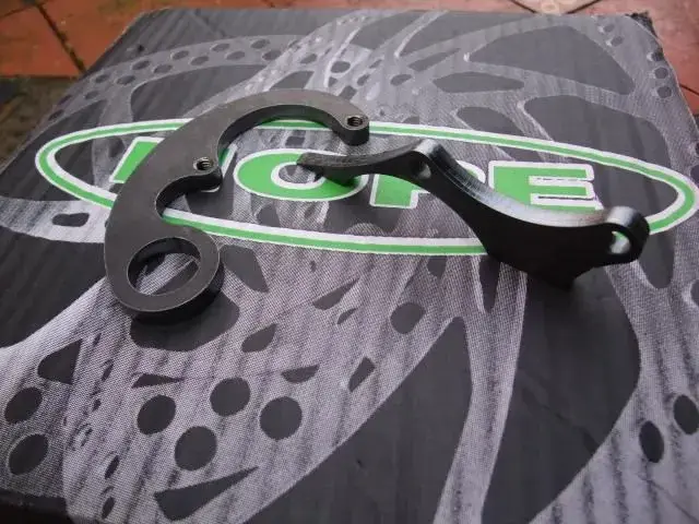

When looking for suitable disc tabs I found that 'B3' on here had laser cut some for his son's bike, so I drew up the tab and a jig in CAD and sent him the files, then got these back;

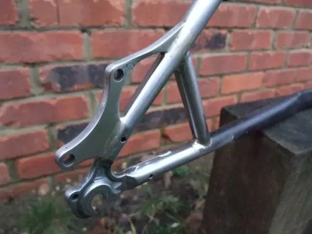

Because the seatstays run at an angle down to a small drop out, the tab needed some tweaking to get the top part to sit on the seatstay, it was then bolted up ready for tacking with the jig fitted around the rear hub.
Then brazed and cleaned up...

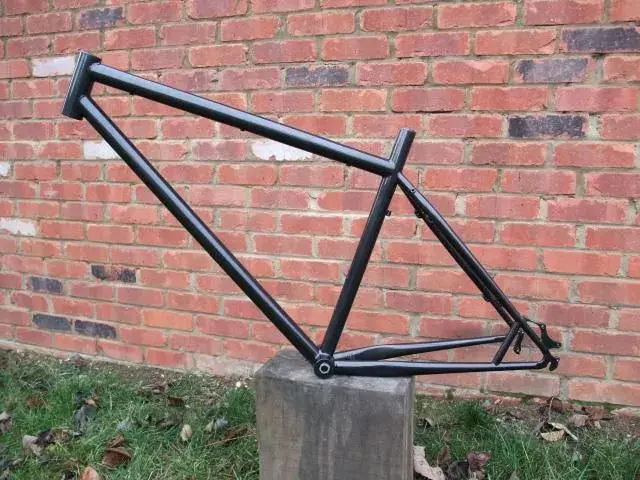

With the 3 extra top tube bottle bosses on, 2 hose guides on each seatstay, the disc tab and brace on and the canti bosses removed, it was then read for blasting and powdercoating...

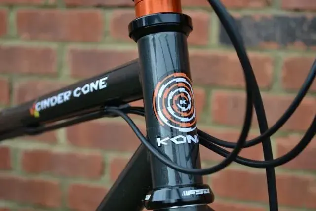

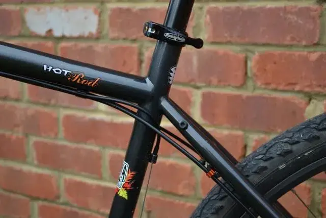

Gil_M did some amazing custom decals, I wanted orange and grey, with a mix of '97 and '96 logo types (spiral head tube badge) a long with some other custom touches. I was really please with the results! As ever awesome work by Gil_M

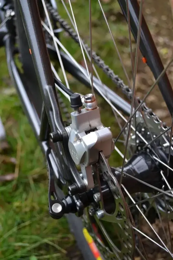

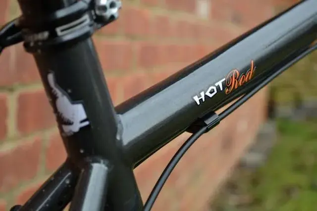

Then I built the whole thing up with bits I've been collecting over the past 6 or so months, and with an orange anodised theme (I've tried to keep it to a minimum!)
The top tube routing uses Ragley bolt on cable guides, which are fairly veratile and allow a complete outer casing routing for the gear cables with the hose guides on the drive side seatstay.
