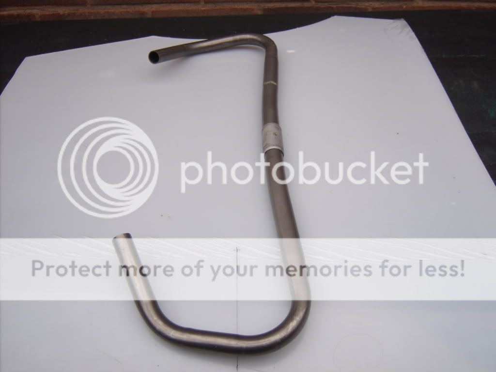

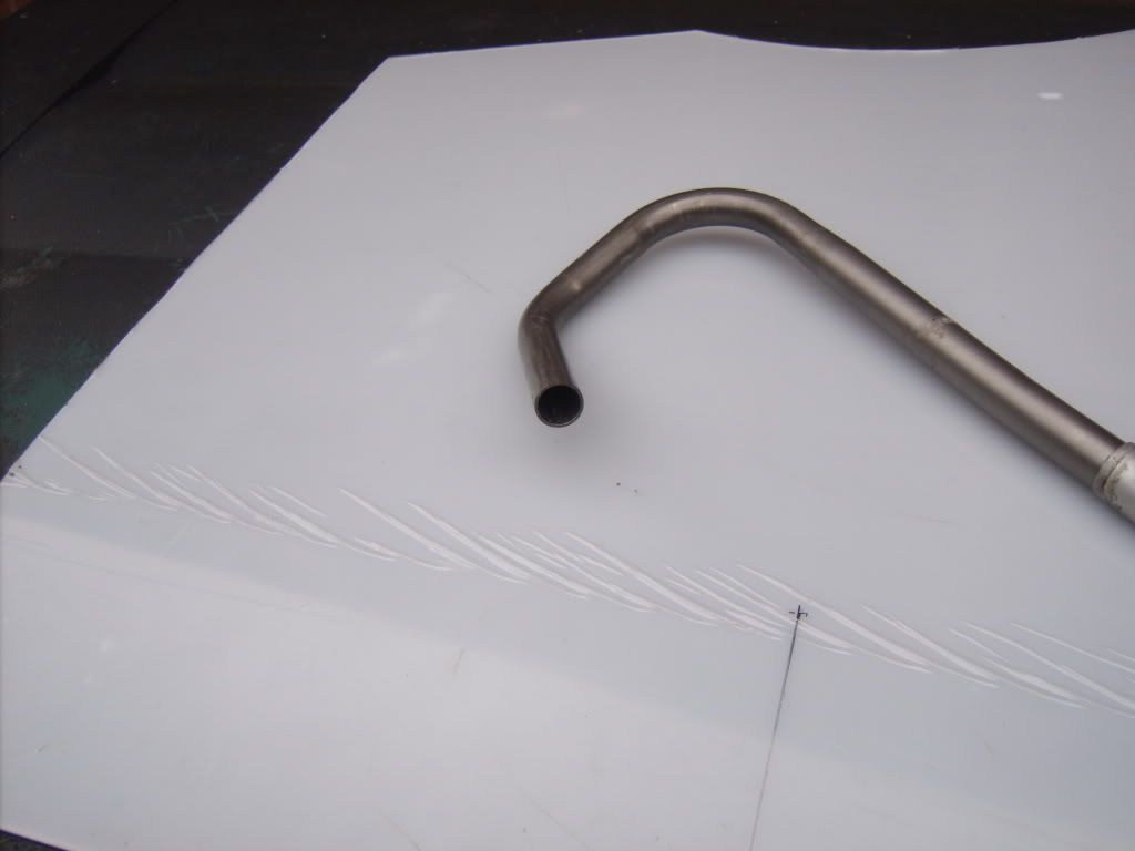

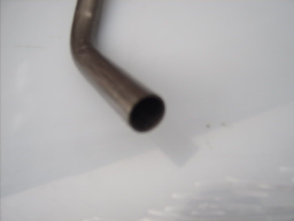

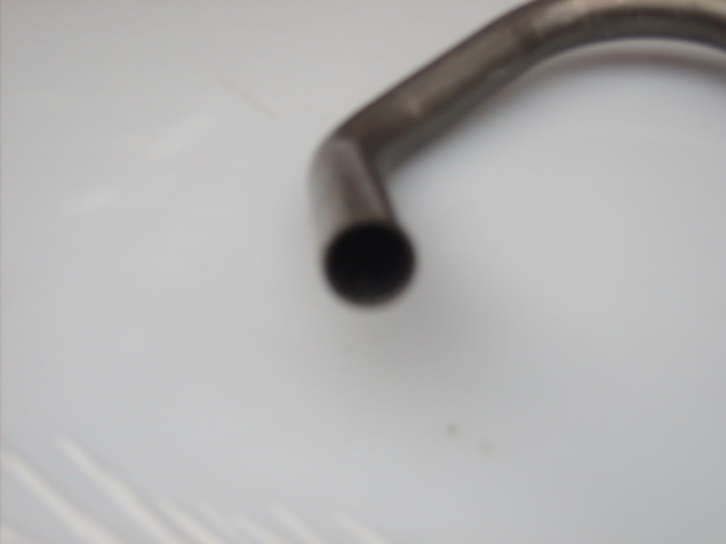

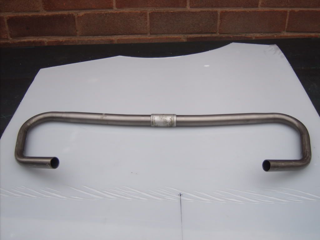

Thanks, i've followed all the advice and i believe they are Ti. I've even had the digi micrometer on them to check the thickness. The wall thickness is 1.45mm compared to 2.55mm for some alu bars of the same period. Anyway, some photo's:
And some not so great photo's.
