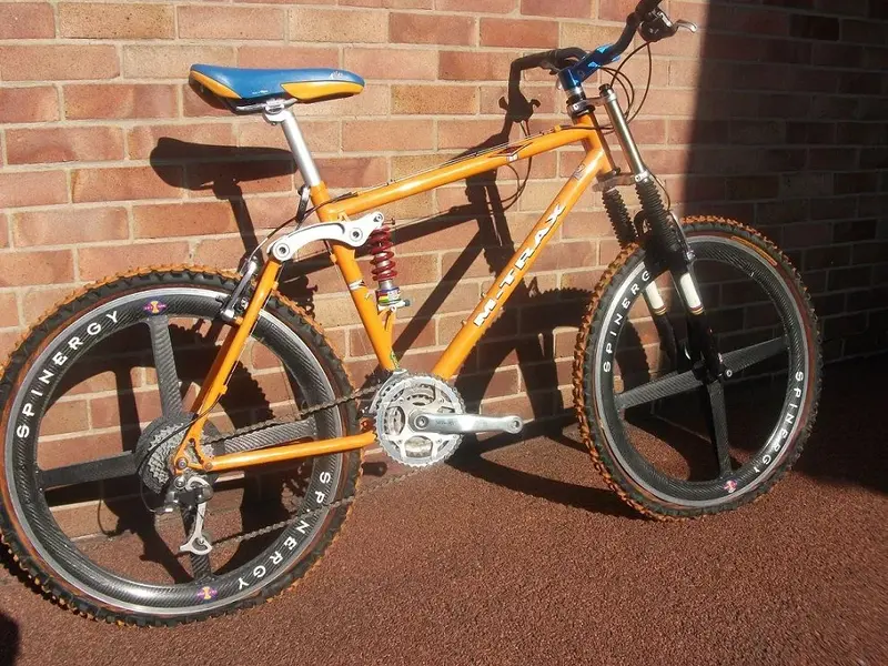

Just a few pics of my Raleigh Special products 853 full sus prototype. It was first to become the "Freeride", then developed into a range of full sus bikes including the DHO.
Really liking these frames at the moment.
That's quite a sofa on it!
Not a fan of the spinergy's but they do it for most others it seems.
Nice build. Do you use it much or fear damaging a rare prototype?
