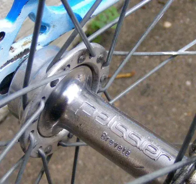

Are these all French threaded for freewheels, how does one ID, I can't see anything stamped on the free wheel itself...
As with previous Campagnolo hubs, the flange and shaft chuck together instead of one piece aluminium.
I'd imagine they probably made both English and French. They certainly weren't all French threaded - I sold some with English (or maybe ISO....???) threads.
They were a pretty cheap hub; I built a few in the mid-80s, and didn't see many around after that. They were about the same quality as the basic Maillard hubs, but instead of having the one-piece alloy hub body they had a three piece design with alloy flanges and a chromed body. the chrome used to flake off...
