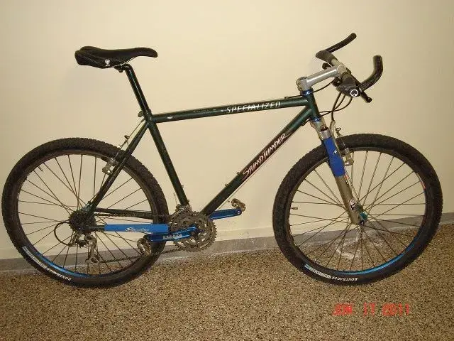

First up my 1994 Stumpjumper FS. Started life with the grey Umma Gumma tires and Specialized Future Shock, and if I remember correctly, all LX components. I am the original owner and have the receipt from buying it my first summer out of college. It was a leftover '94 as i would have bought it summer 1995 so I got a deal on it which was the only way I could afford it. I had a Hard Rock back in the day but I remember drooling over the Stumpjumper in the Specialized catalog so it was (for me at the time) like buying a Ferrari of bikes. As I started to ride more and more, I went hellbent down the upgrade path and sadly in my youth and naivety, didn't save any of the old components.
From memory, here's the rundown of what the bike has:
Converted to full XT
Machine Tech cantilever "zero-flex" brakes (bought from a friend's Gary Fisher Procaliber Limited)
Titanium Ritchey pedals
Raceface cranks
Judy XC fork (rebuilt by Hippy Tech Suspension recently)
WTB titanium railed seat (recent change)
Cane Creek sealed headset (recent change)

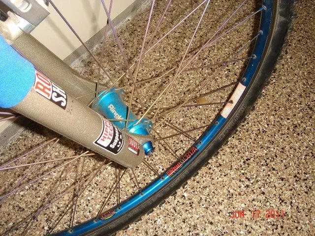

Sun CR-17A wheels with TCC coating on brake surfaces, titanium spokes, and Ringle Super Duper hubs
Quick releases deleted from seat post and wheels
As you can see I ended up pursuing a green/blue theme. Not perfect execution but it is ok. The bike got a lot of stares when I had the local shop do the Cane Creek headset.

I would like to convert my 1994 green frame Stumpjumper to XTR, m900, but it looks like that requires going 8speed. How do I know if my rear hub and frame can handle 8spd?
Frame probably can but hub cannot in its current state;
You will need to change freehub to the one that can take 8/9/10 speed cassettes and re-dish your wheel. There is possibility you will have to change your hubs axel.
