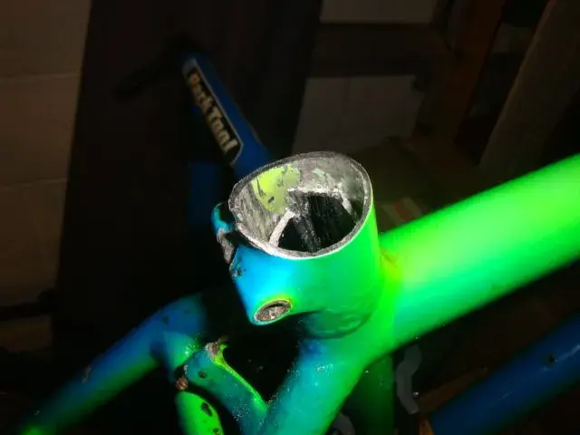

heres a picture for you, its abit of a mess.

rosstheboss":2zasmi40 said:
Is it just the photo or is the seat tube/seatstay bit horribly bubbled?
The paint has badly oxidised in some places, its getting a full respray if i can get the seatpost out.
Its a 1993 Attitude, hence worth saving as its pretty good apart from the post and paint.
It is a bit of a mess, with nothing left to get hold of. Even so, it does look as though you've got a bit of a gap between post and tube to get some PlusGas down. PlusGas can work some surprising miracles if given several weeks to insinuate itself.
have you tried cutting down with a hacksaw blade? depending on how much post is in the frame, you could maybe cut it into sections then tap each one loose
yeah i tried that, the previous owner had already started to cut down the inside, soon as it got the corrosion the section of seatpost broke off.
Its at Enigma bikes as we speak being worked on....
