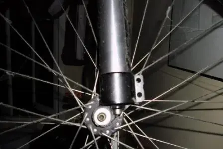

Is there an after market disc adaptor for the old White Brothers forks that use the goofy spacing they use (22mm ?). Or will I just save a lot of searching, grief and cost by sticking with Magura rim brakes?

They look sort of similar to the ones on my RC150's (see the RC500 build thread in my signature). They too use an adaptor to fit the caliper, depending on the type of caliper.
I remember I had one on one of my old Dual Slalom bikes and dug up a pic. They're nothing more than flat stock Al (3/8" IIRC) with 2 tapped holes for the fork mount and 2 holes for the brake mount. Fabbing one up would be easy. some plate, a hacksaw and a drill+tap and you're good to go.

you got a pic of the mount ? i may have something from hayes that'll fit :wink:

nope sorry , i only have a hayes 22mm caliper which bolts on slightly diffrent :(
I reckon these would be the same as amp ones, so keep an eye out for those too. I may have one that will allow you to run the early hope standard callipers.
i had a pair of SC90s BITD too and I had a factory White Brothers IS disc mount adaptor plate, but it also had a band style clamp that went round the leg (like the old hope/pace setup)..
