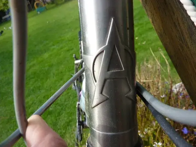

Long shot I guess :-( but does anyone have a spare Airborne head tube badge they want to sell me ?
Like this one (Picture shamelessly pinched off ‘maxhc’) :
I heard a rumor that people removed them as they had a tendency to attack the skin on your knees, hopefully this is true and therefore I might get lucky … :lol:

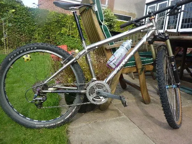

OK, here it is :

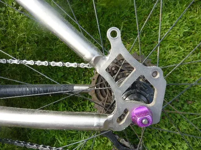

And the dropout’s / v boss’s / pipe clip’s / chain catcher etc that might help date it :
The serial number is SER02608
I initially got told that it could be a 2002 / 03 but then the guy at van Nicolas (up until the serial number confusing him) thought it nearer 2000 ? :?

your lucky strike is different to mine which I think is 2002?
No pipe clips.
My disc mounting is mirrored on drive side .
Serial no SER22930

This probably shows the welds and profile of the top tube best - it almost feels triangular (and potentially painful :lol:) :
This is the forming on the rear stays :
The down tube is ovalised at the head tube, round in the middle and then very ovalised at the bb shell (across the width). You can see this on the side view of the frame pictured in my earlier post.
