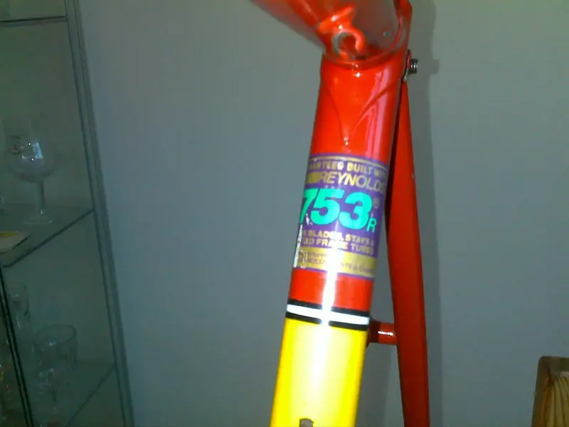

Thanks for all the detailed info guys - now I'm going to further confuse the situation with some more info of my own!
The frame number is SB5817, which makes it a 1983 build. The frame decal says 753R while the forks just say 753 - though the frame decal says "Guaranteed built with Reynolds 753R Fork Blades, Stays and Butted Tubes". Frame weight is 1690g while the forks are about 660g! So I think it's clearly all 753! Not at all shabby for a 56x57cm frame.
The frame tube ODs don't tally with the above info though. The top tube is 26.2mm, down tube is 28.2mm and the seat tube is 28.6mm all the way down. The ID of the seat tube comes out at 27.0mm no matter how many times I measure it, though my caliper only goes about 1cm down into the seat tube and I can insert my 27.0mm post about 4cm in. I'll pick up a 26.8mm post to experiment, and as a placeholder.
So here's a few pics to show the general condition and some detail. I left the frame at my car mechanic's place for about a week so that he could mix some paint up, and it looks like he's made a really good match. The next step is to get the fixed cup out and clean as much rust off the bare metal as I can. Then prime it with a light shade of Hammerite, and put a few layers of customised Nissan Red on it. Once I've touched up the paint I'll build it with a mixture of Record and Super Record, with Cinelli up front, and a Rolls to top it off. I need to replace the Super Champion Arc en Ciel on the F wheel after I trashed it last week, but I have a pair of Record du Monde on the way from Denmark. The plan is to ride it in the retro Ronde van Vlaanderen next year.

Maybe your frame has a mix of metric and imperial tubes. If the imperial tubes were introduced in 1983, maybe there were some metric tubes left over they wanted to use up.
26.2mm for the top and down tubes would match the metric spec if 0.2mm is allowed for paint.
This is from 1987 or after:
http://www.equusbicycle.com/bike/reynolds/Reynolds-tubing-sizes.jpg
753 seat tube is single butted 28.6 OD with 0.7/0.5 walls.
Perhaps very early 753 imperial seat tube was 0.8/0.5.

it and put it on youtube perhaps - i could diagnose a 753 much easier that way! lol going by the brazed components and the battered 753 badge it all ties in with the features found on a genuine early 80s special products frame!
the reason your forks have the unusual TI badge was raleigh's
decision alone - no one else to my knowledge had those badges
on the forks and indeed they didn't come with the tubesets available
to the ordinary framebuilders outwith raleigh. personally i never
liked them and indeed on the SB8650 frame that i had in panasonic
colours there were no 753 badges of any description, instead a red
and yellow motif with the raleigh "heron" on.
you have got a cinelli cast bottom bracket and internal fork crown (was it called the CCA? hmm...) and by the look of it prugnat lugs but the original owner must have requested the "shot in" stays as i'm sure that raleigh ilkeston built with the standard side-brazed stays - they certainly did on the larger frames as it was deemed stronger. also you have the under-offset brake cable stops on the top tube - another classic raleigh special products feature. i can't tell from the photos but are they campag dropouts? i know they used simplex for a while but think that was in the raleigh weinmann days of the panasonic colours, from '86 onwards and i'm thinking they might have been drilled for lightness too...now i'm guessing! yours looks like a 21 1/2" or 22" frame, perhaps?
