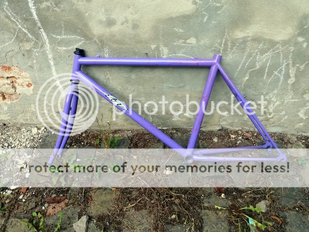

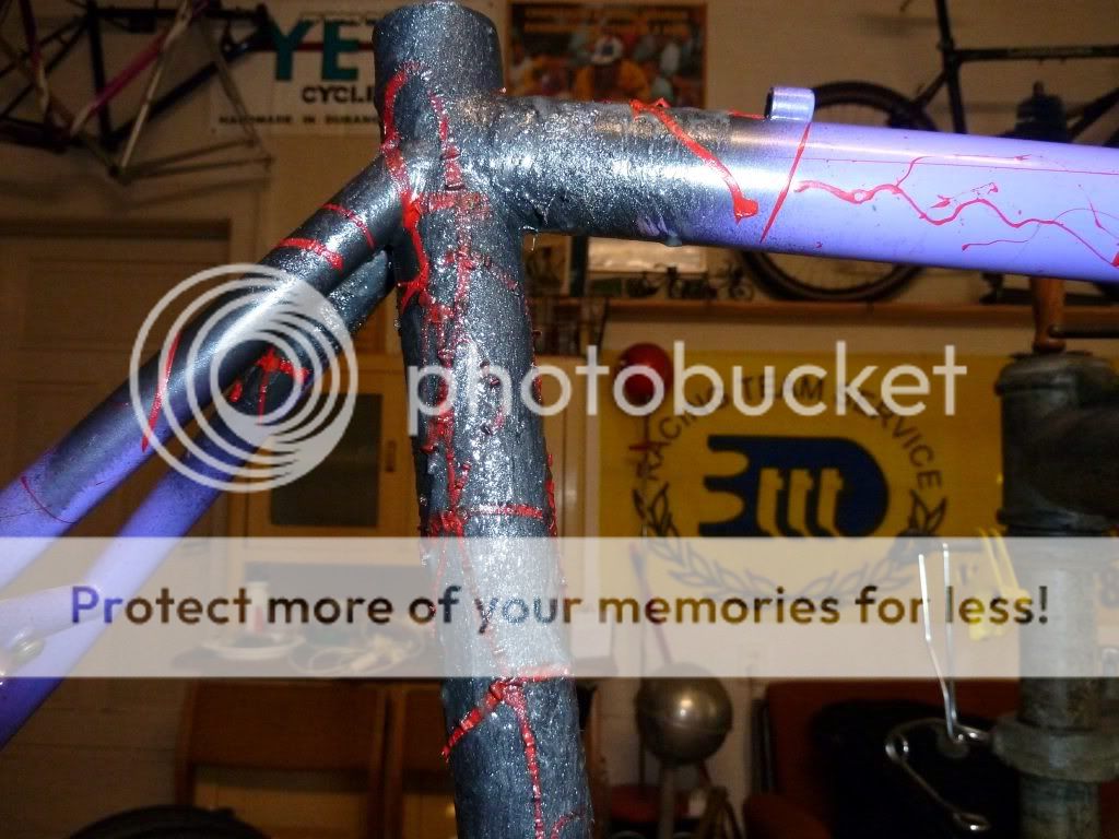

Frame number 1022 makes this a 1990 model, if my chart is right. Also the Koski Duratracs steerer says "Tange 90". The frame unfortunately had a stuck seatpost in it at one time and the previous owner (before FF) had used a propane flame to loosen it up and the frame was charred. So Jeff did a kind of preserve-condition-repair and spray bombed the frame and then did the splatter. I decided to take that challenge and made a nice swap with Jeff that also included some parts.
This is how the frame looked when it arrived:

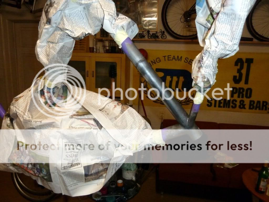

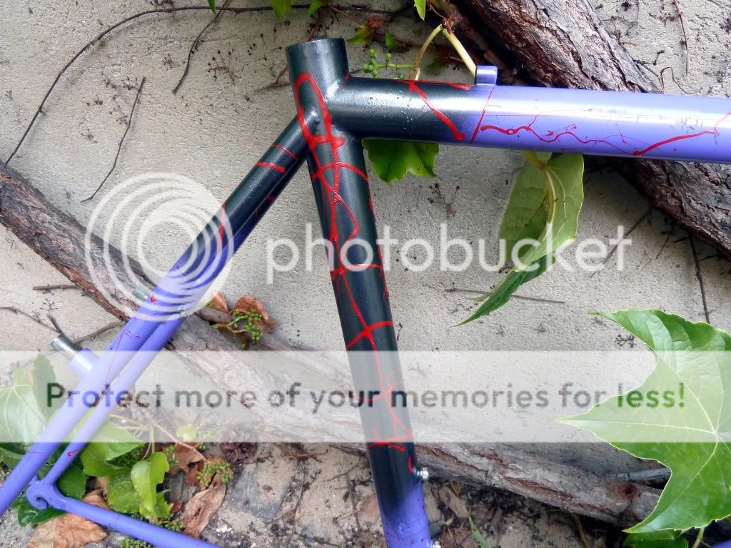

From the beginning, I had planned to repaint the black areas as matching as possible. Talking to my vintage (-car and -motorbike) engaged friends, I got told that a perfect colour match would be nearly impossible. I also had my own bad results paying someone for a non-matching stem. And a whole complete repaint never was a topic for me, since more than 3/4 are in nice original condition. Inspired by Carsten and his do-it-yourself-threads, I decided to try it, having done painting small parts and some touch-ups before.

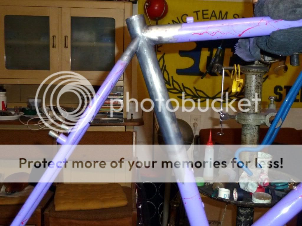

Removing the black with chemicals was easy, after this came sanding and polishing:

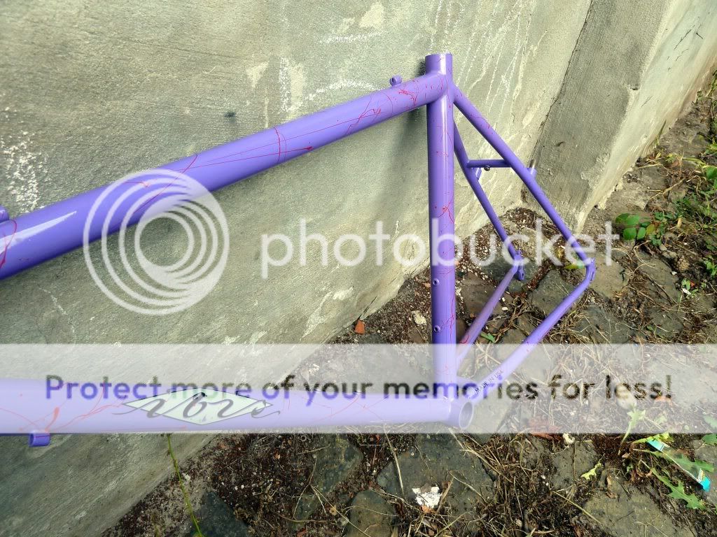

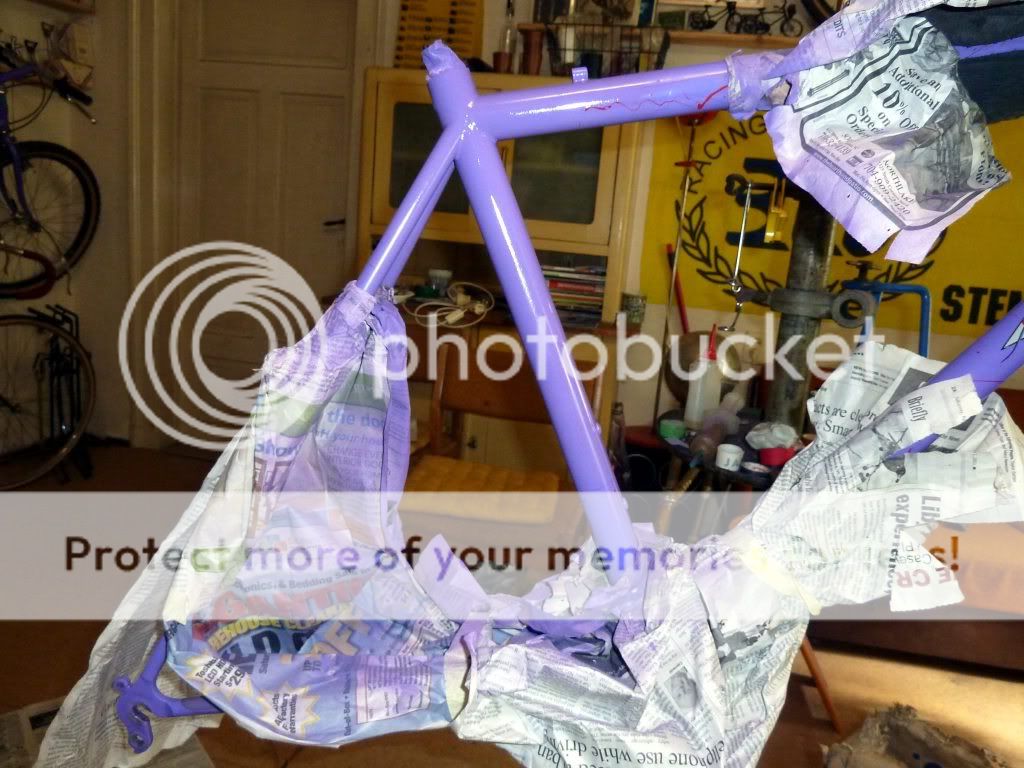

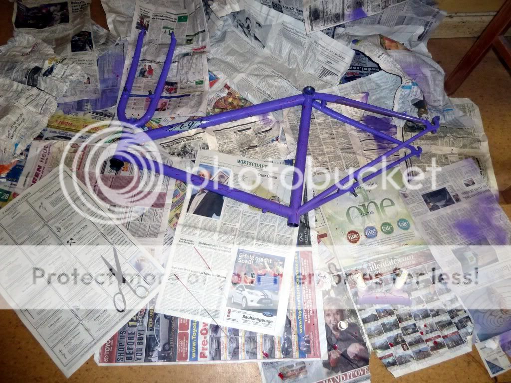

First try with acrylic colour spray, not so happy with the result. It looked more promising with the colour card than in reality.
So, colour off again (using acetone, it didn't hurt the original colour). Next colour mix looked better.

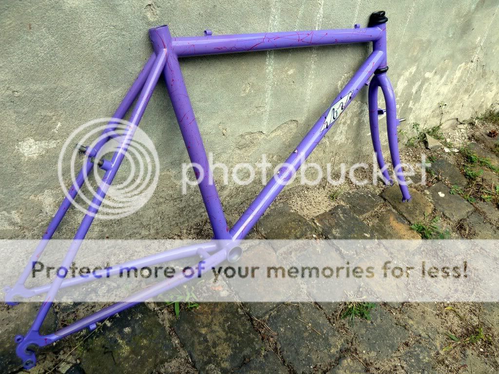

A closer (possible to get) match I have not found yet, also the difference is very small, so I decided to stay with this colour for the moment.

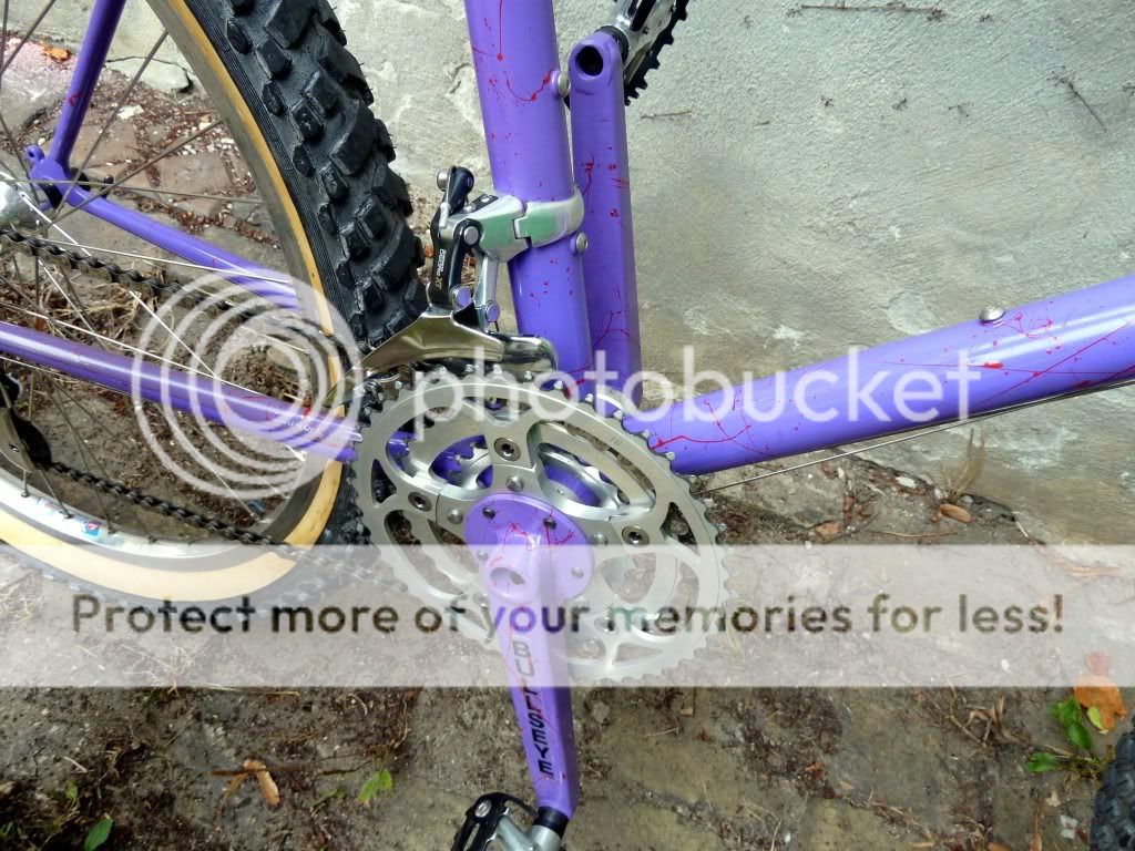

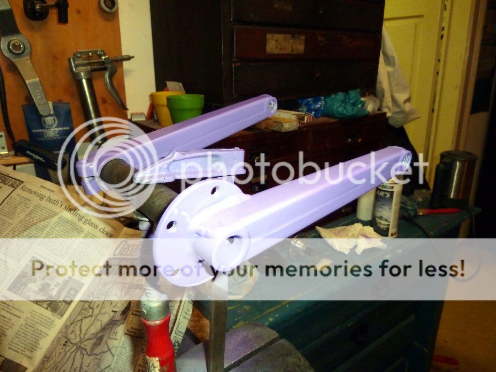

I remembered I had one beaten and rusty set of Bullyeye cranks laying around. I liked the idea of colour-matching them.

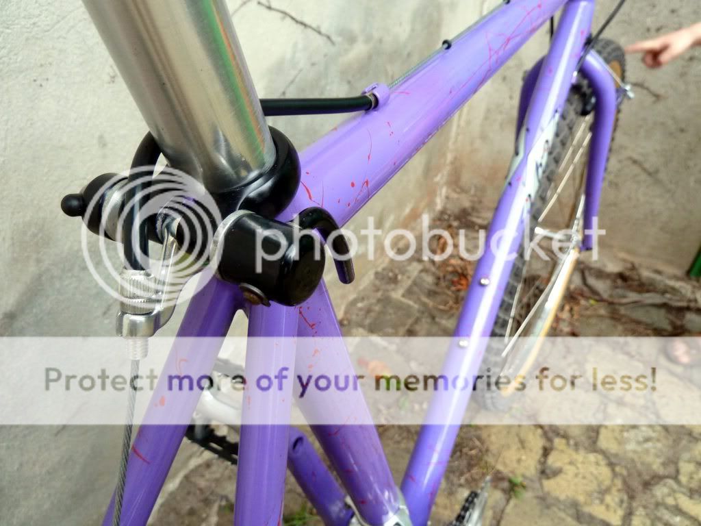

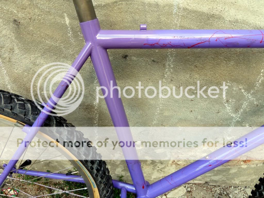

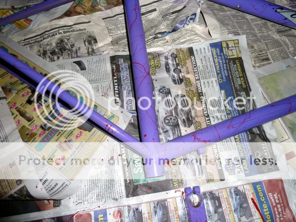

After numerous layers of clear paint, the next step was getting the splatter done. Asking Scot Nicol did not help (yet), so I did some experiments. Best results showed up using a very thin stiff plastic tube (1mm) that gets flooded sticking it inside the colour can and is then flipped with your hand. Hard to hit a specific spot, it always goes where you don't expect it, but the style had something in common with the original Ibis splatter.
Lots of polishing (also inbetween) later, I got this result:

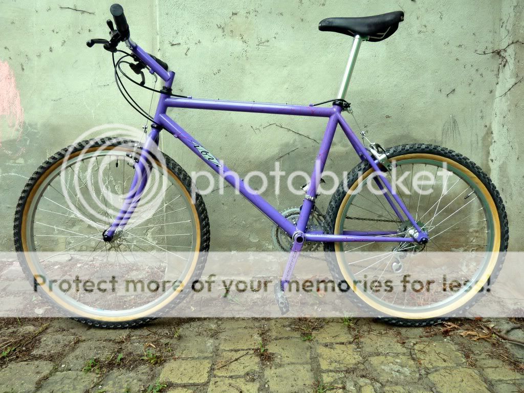

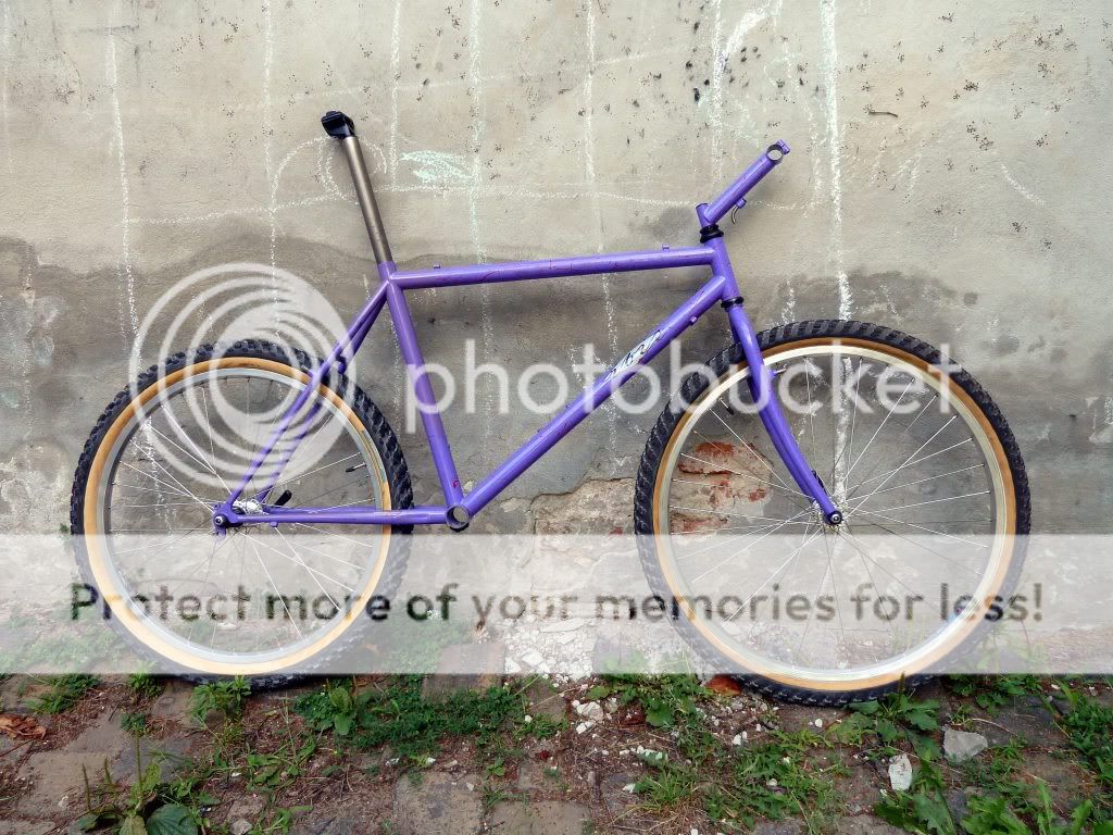

Built-up was relatively easy. This is what came out.

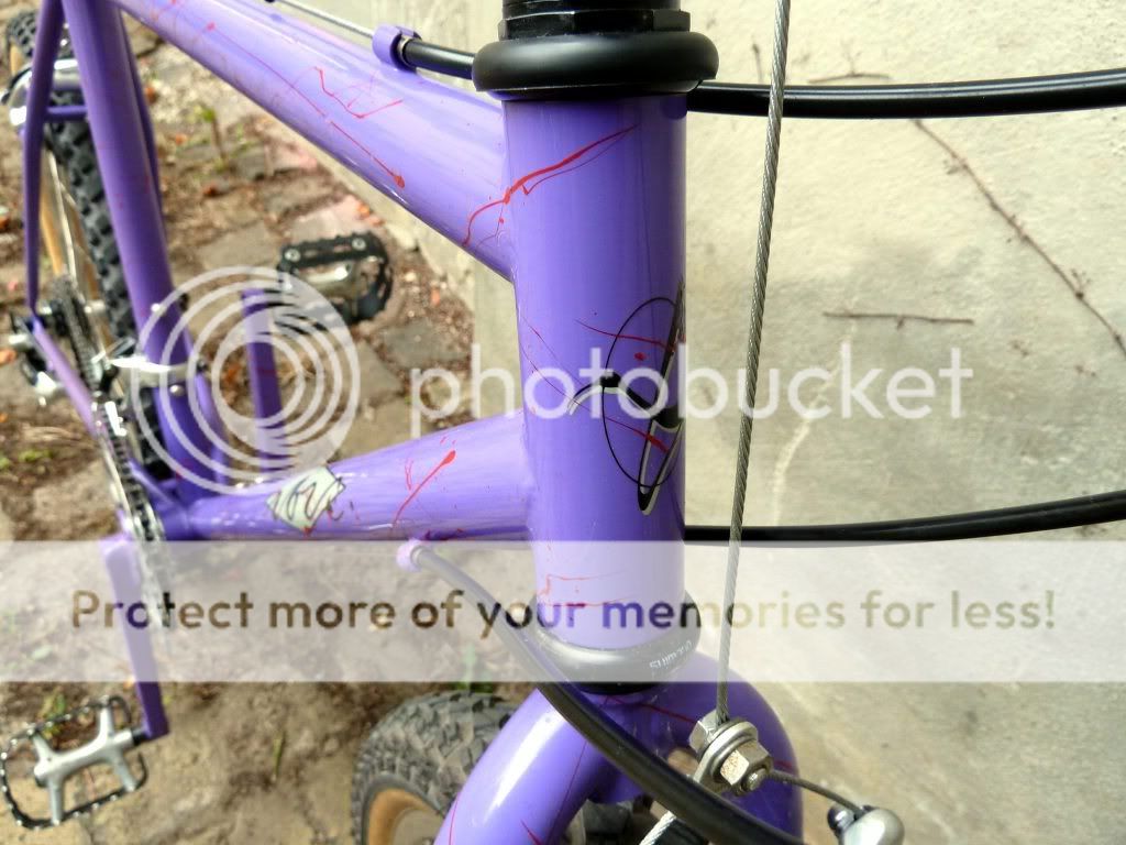

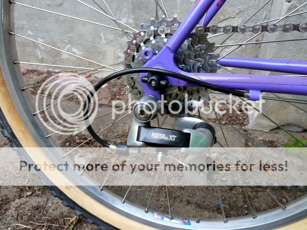

Deore headset is the only remaining (original?) part, not sure about those Sun Chinooks Rims, I think they were later. I also have a pair of matching grey RM-20s now, but I like that silver look for the moment.
Cranks came out fine, rear mech is a XT with 6400 cage (with relocated spring hole).
Size is 18" (the japanese production models were only available in 13" and 17"), still a little small but the AmericanClassic seatpost is long enough for me. I don't like these long looking out seatposts usually, but this bike seem to be one of the few where the constructeur had exactly this in mind, as old magazine reviews say, also reason to use their "29.4 Monster seatpost". Current weight is 12.3 kg (27.12lbs).
And it rides funny!
I was wondering why the rear wheel looked so fat... Those old Cannondale's with 24" rear wheels look awkward but this looks so right 8)
