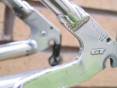

Till 96, yes you can't spot differences apart specs but Zaskars LE built from 97 has different, CNC machined dropouts.
If you have dropouts like on first picture, you have Zaskar (here is mine 96 but 97 and 98 are the same) If you have second one (CNC), you've got LE
