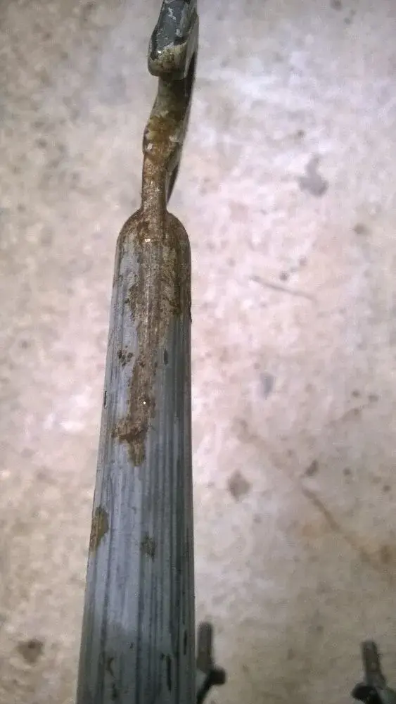

The forks:

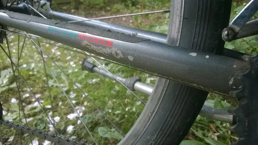

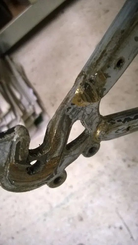

The chainstays:

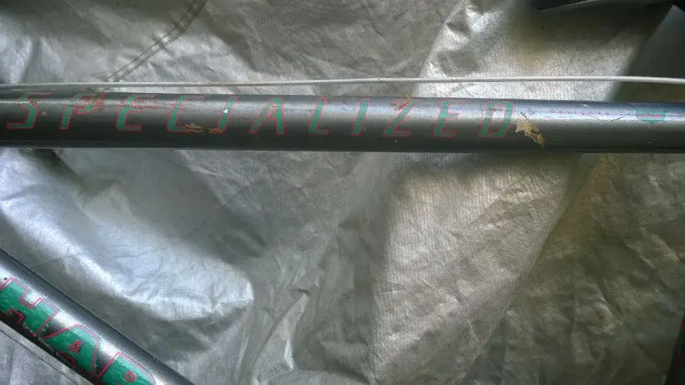

The top tube:

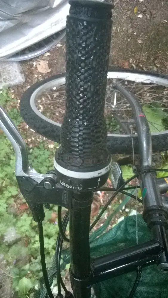

The grips and shifters were just vile :facepalm: :

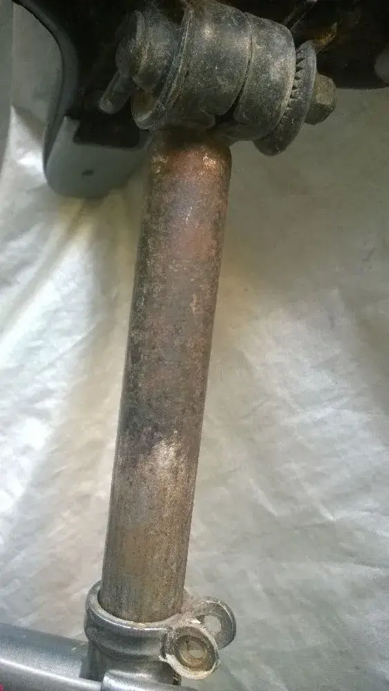

And the seatpost was a model of ugliness :shock: :

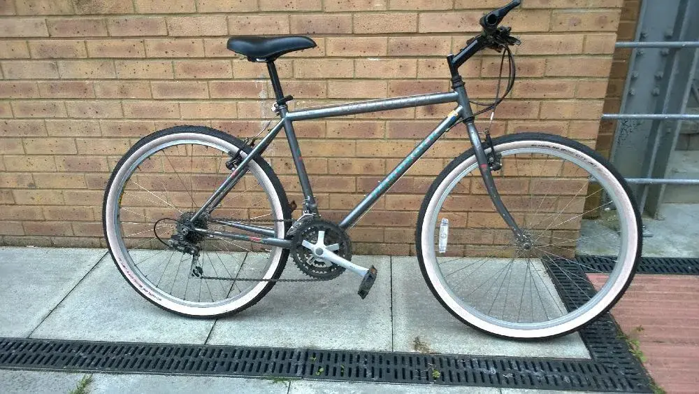

I got the bike running safely, after a fashion, and gave it a short test ride. It looked like this:
It was okay. The poorly functioning brakes gave it a slightly disturbing ride quality and then it sat in the garden, awaiting dismantling. It was simply not worth the time and effort it would take to make it a nice ride. Or so I thought. Mrs Ace asked me what I was going to do with it and I told her that I was going to get rid of it; whereupon, she responded, 'No. You can't do that. It's a nice bike.' :shock: :shock: :shock: I never thought I would hear those words. And I still thought it would take far more time and money than it was worth. However, I set to work. It was completely dismantled and I stripped the paint:

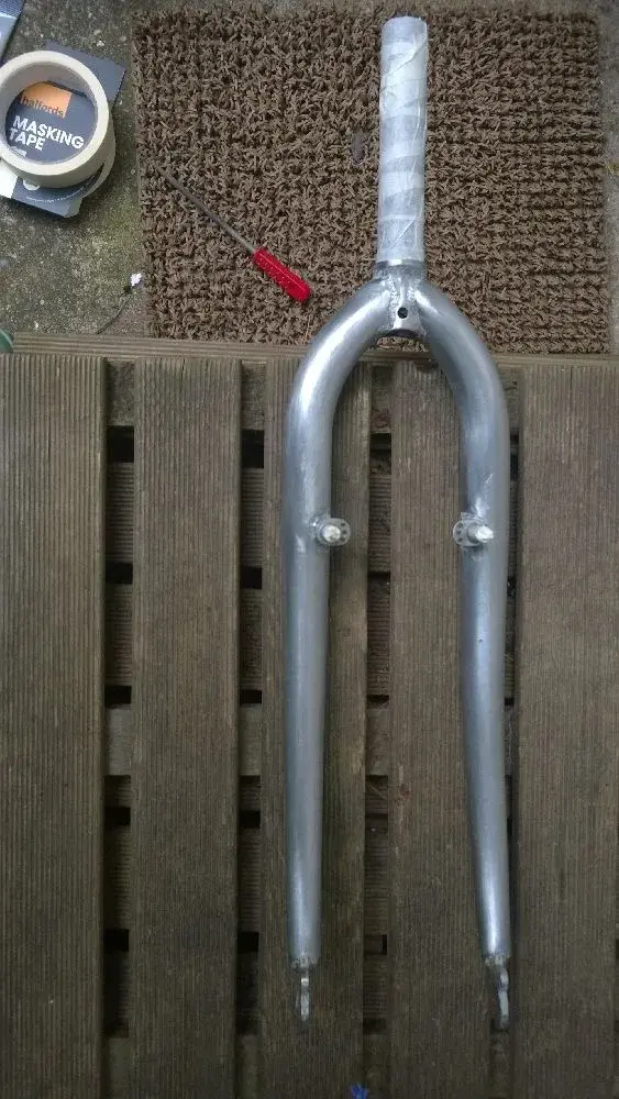

The forks:

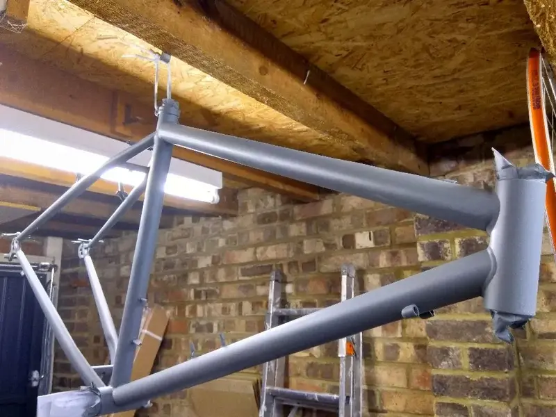

Here's the frame with primer on:

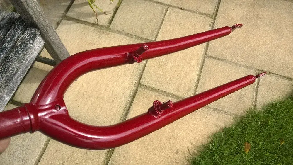

And here are the forks - finished:

Respraying continued, as and when I had time:
The original paint was stripped using Wilkinson's paint stripper. It was fine. I just followed the instructions and used a shave hook to take off most of the paint. The undercoat was left but that came off easily enough with wet and dry.
I thought that I would do the respraying myself, just for the heck of it. It began with the grey primer (about two or three coats); then red primer (two coats) because the red spray I was going to use required it; then the red. Now, after a bit of head scratching the colour I went for is none other than good old Rover Nightfire Red, mainly for sentimental reasons. It's a pearlescent paint and requires a good covering of lacquer to look its best. Many fine coats of the red were needed and then a fair few coats of lacquer (about five or six coats of the red and about four or five coats of lacquer). All the paints were from Halfords and the overall cost was about £60-£70 for respraying. Powdercoating is no more expensive in some areas but not near me.

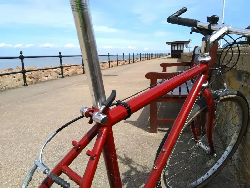

Here it is on its test ride, nearly two years after its first test ride:
And here it is, posing for a photo opportunity on the seafront:
