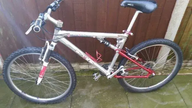

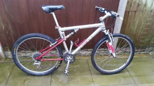

Behold, the 1996 sintesi hantrax.
Plan was hatched to fixerup and take to mayhem in June. Be a bit unusual / different and it's a good vintage for retro gathering. It also appeared in tidy condition so ticked plenty of boxes.
First inspection led to the following to do list:
Forks scruffy, replace.
Brakes wibbly, investigate an potentially replace.
Saddle scruffy, replace
Bars scruffy, replace.
Wheels, investigate further
Gears seem ok
Rear shock, investigate
And plenty of time.....

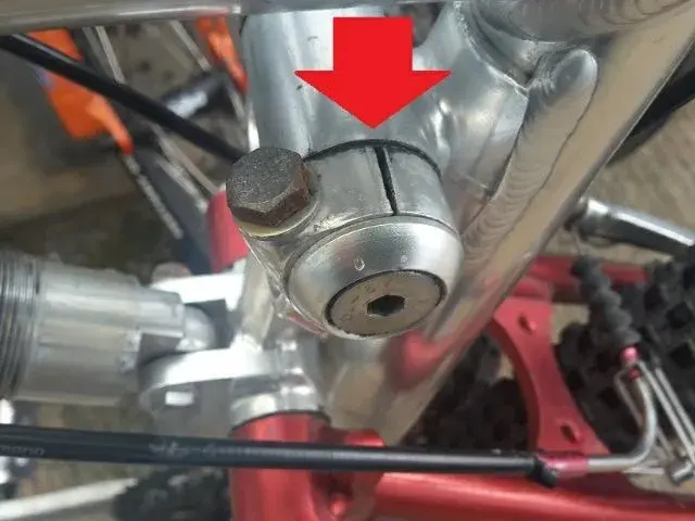

But on closer inspection.....
Yes, that's a crack at a design / manufacture weak spot on an irreplaceable part
Quick call to Dan in order....

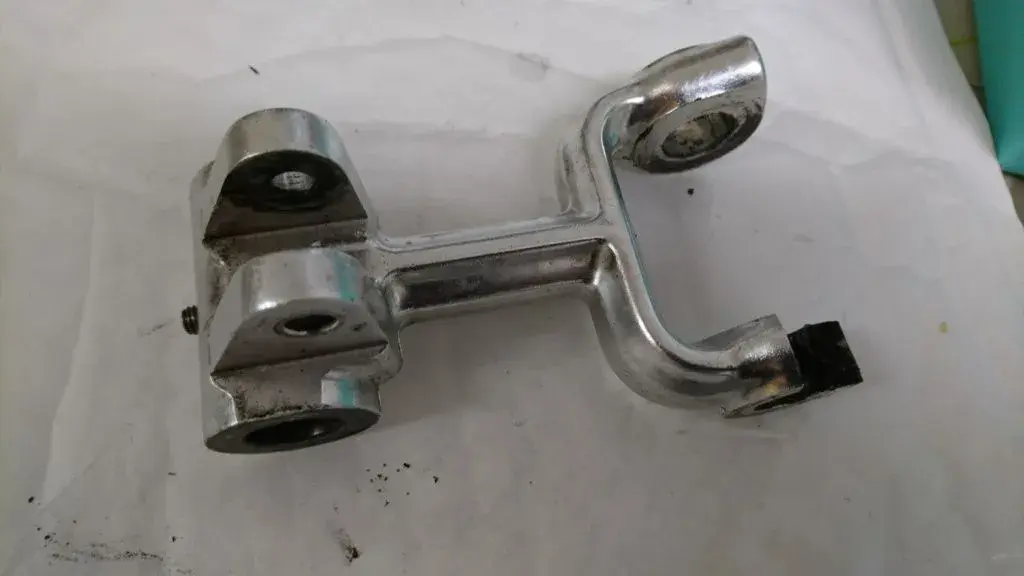

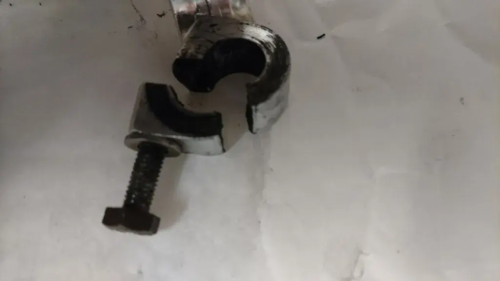

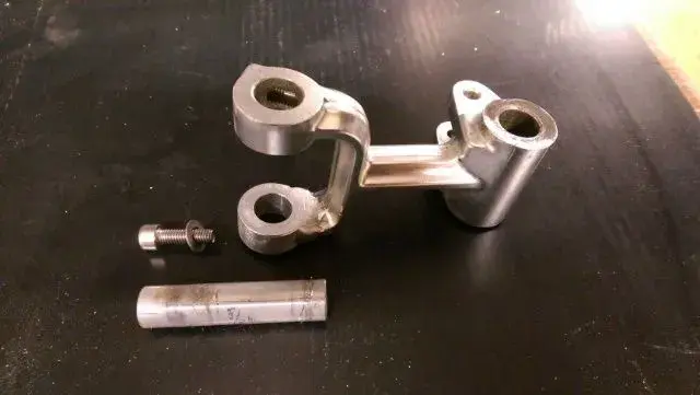

Re: Mayhem project
Busted the clamp along the line of the casting in looks like.
But never fear.... Dan to the rescue....
Chopped the broken ring out and welded in a new solid ring, no clamp, so it's a friction fit. That screw is to hold it still, there is a groove in the pin the bolt locks in to and stop the pin rotating, so it turns in the other part of the pivot (the frame). So Dan popped a thread in the 'other' side as it already had the casting for it (top in the third photo)
Not a bad job I'd say.
Now to get the parts stripped and cleaned up to see what's what.
