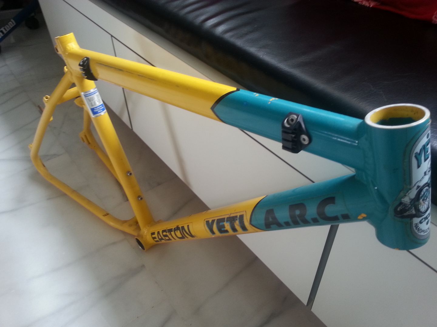

So here's the before picture:

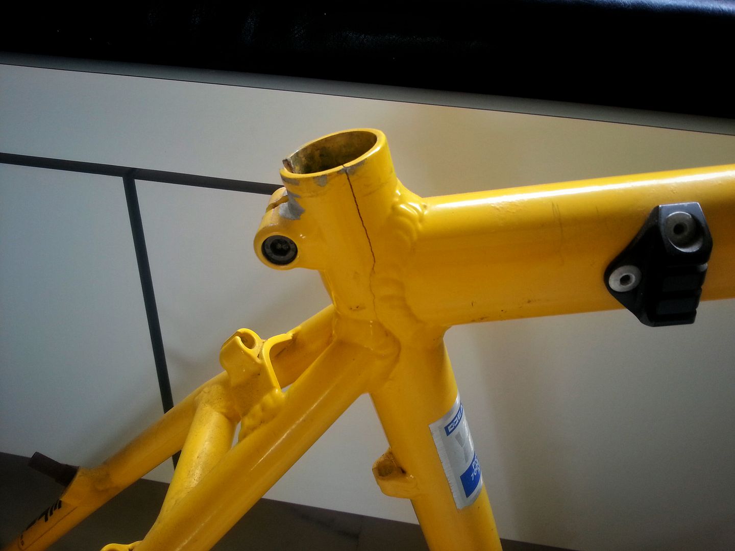

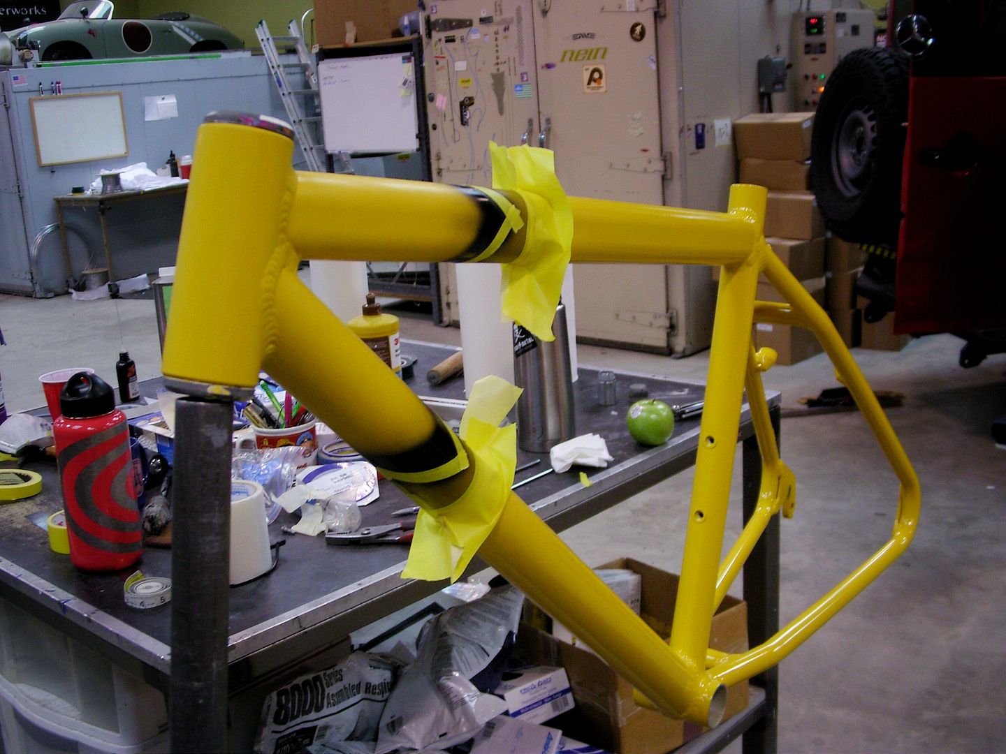

The frame had a cracked seat tube and headtube which Frank replaced:
A while later Frank got to grips with the restoration, it was scary to watch it unfold as he took the busted tubes off the frame:

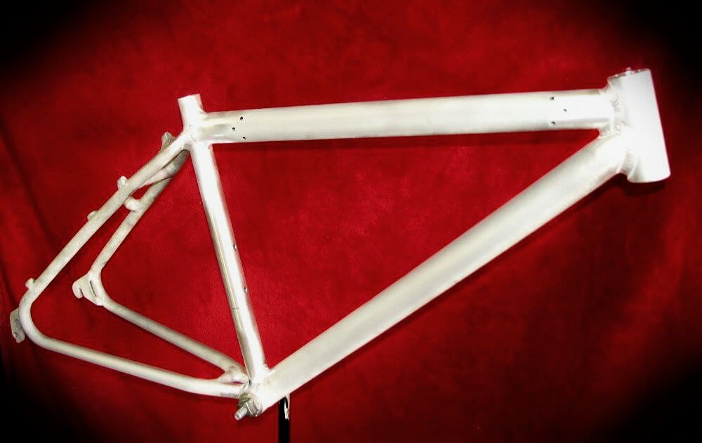

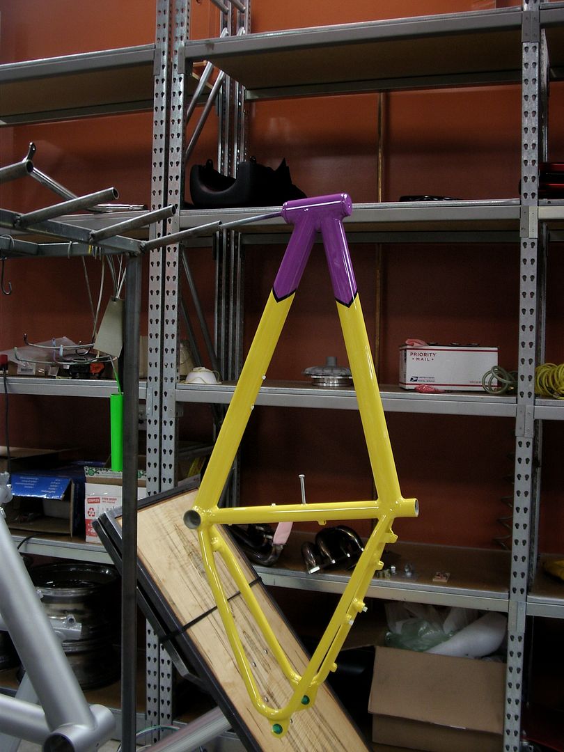

Alas he's the ultimate of metallurgical magicians and soon enough it was ready for paint:
Yes, the frame size has been dropped a little bit, that was Frank's artistic license, and the fact I have inherited stubby legs from my dad!

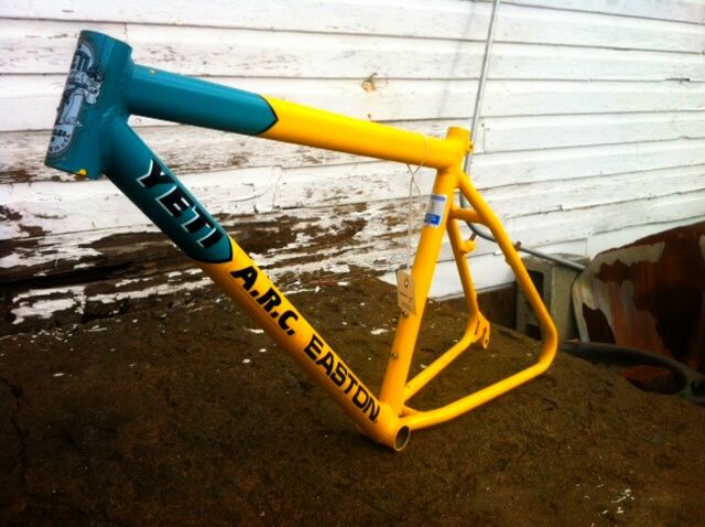

At this point there was a long wait between the frame being ready to go to Spectrum and them doing the paint job as I have a bike team to run and that was taking all my spare cash! Took a fair while to save the required small fortune for Spectrum to sort the frame out and during that time I was agonising over the actual paint job itself. In the 90's I longed for the team's turquoise and yellow, however I fancied something a little different, I considered a turquoise front with a white rear but this would have clashed with my predominantly purple parts, and that was my decision made for me, yellow and purple, perfect:

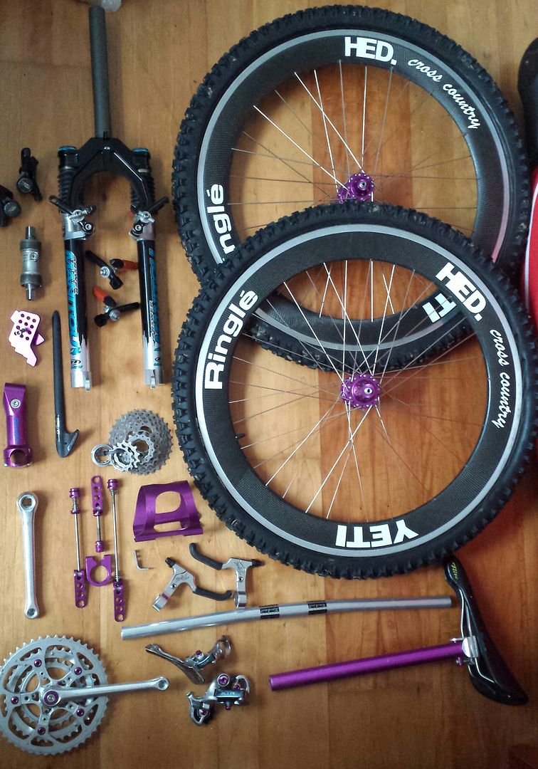

I had been hoarding parts for this build long before I had found the frame, it all tied in nicely with a purple, silver and black build, with just a smidge of turquoise:
I had a couple of issues with the bottom bracket and the Topline cranks, it was a complete pain in the arse to get the right axle length. In the end I purchased a cheap used Royce BB and then sent it to Cliff along with my crankset for him to take measurements and sort it all out for me, the result is a perfect fit, but what a right old faff on!

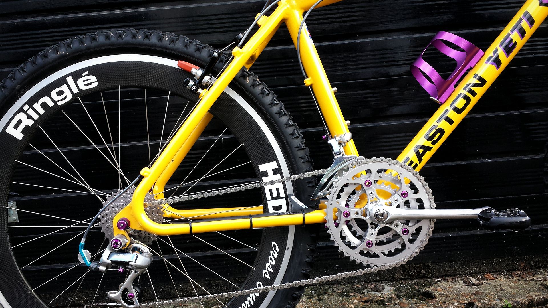

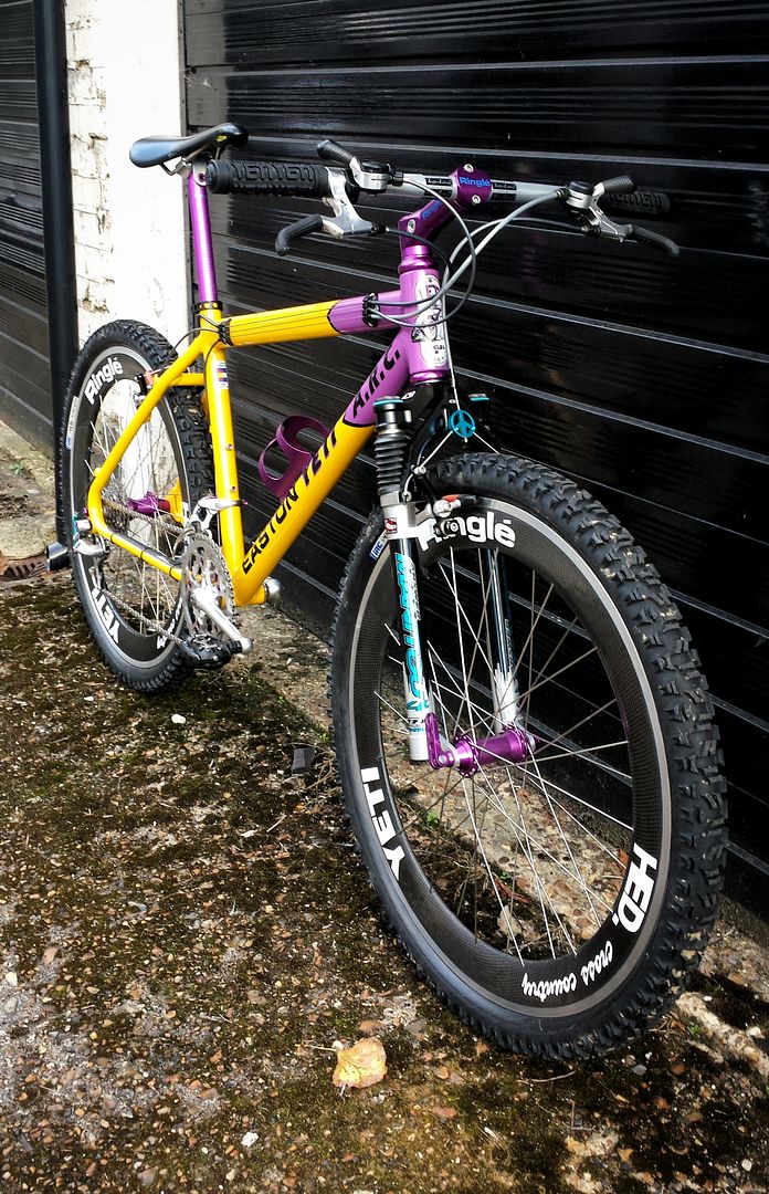

So here we go with the final build:
Frame: Yeti ARC 1993
Fork: Manitou 4
Headset: Chris King No-Logo
Stem: Ringle Zooka
Handlebar: Answer Taperlite
Grips: Yeti
Brakes: Paul Component Stop Lites
Brake Pads: Kool Stop
Brake Cables: Gore Ride-On
Cantilever cable hangers: Ringle Mojo
Brake Levers: Real
Shifters: XT Thumbies
Front Derailleur: XTR M900
Rear Derailleur: XTR M900
Derailleur Cables: Shimano XTR
Cassette: XTR M900
Chain: Modern SRAM, forgive me!
Cranks: Topline
Crank Bolts: Royce
Chainrings: Shimano SG
Chainring bolts: Middleburn
Bottom Bracket: Royce
Pedals: Shimano M737
Hub Skewers: Ringle Holey Ti-Stix
Rims: HED XC
Hubs: RIngle
Nipples: DT Swiss
Spokes: DT Swiss
Tyres: IRC Yeti FRO
Saddle: Flite Ti
Seatpost: Ringle
Seatpost Binder: Ringle Holey
Now I need to go and get it muddy at Hamsterley Forest!
Lee.

Superb colour and build, love the details like the blue mojo and rollamijig matching the blue on the Manitous.
Wonder what it would look like with Magura Racelines?
Well I must confess I didn't like the paint job on the naked frame. However I will happily admit to being wrong as the combined colours on the completed bike looks spot on. Great Job!
Nice job Lee...Really like the paint scheme. I'm sure I have a pair of spare Manitou 3 legs if interested which would be more in keeping with a 93'. Let me know if your interested.
