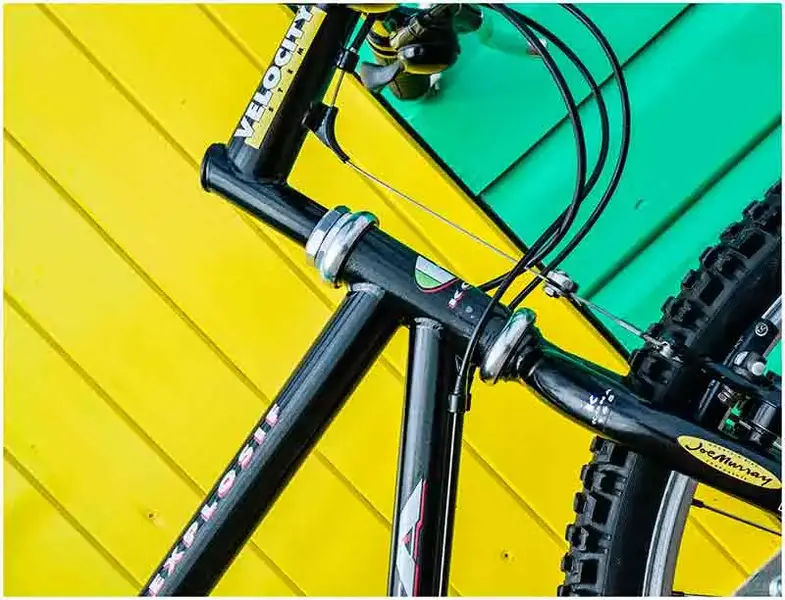

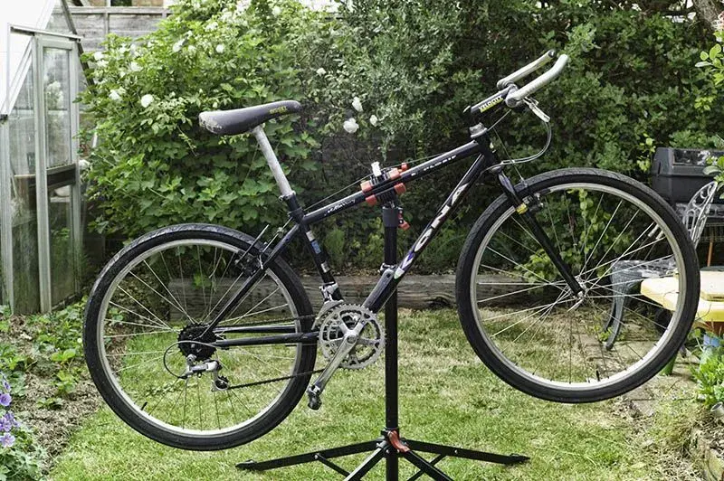

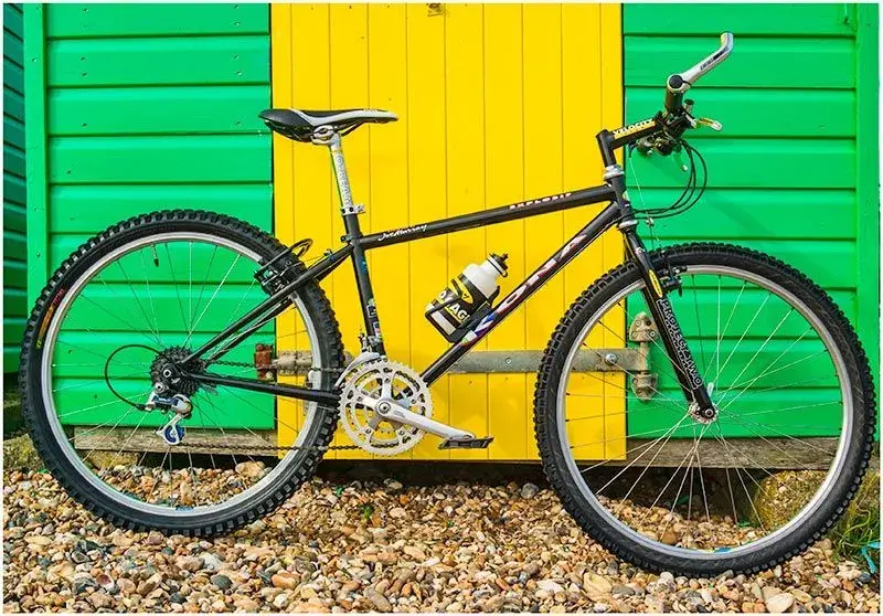

I got this Kona Explosif on ebay the guy said he had the bike from new but over the years he had to replace some of the parts.
I would like to get this bike back to like it was in 1992 so the first job is to strip the bike down to see what needs changing.
Most of the components' are ok but the saddle is so bad that it lets the bike down also the pedals are past there best need to be changed.
I have a new saddle, new pedals new the head set the frame has been re-sprayed Metallic Black the forks, stem, and handle bars all Metallic Black.
A new set of decals from Gil M.
1992 Kona Explosif / Specifications 2016
Re-Sprayed by Colour Tech Custom Bike Sprays Dartford Kent
Bike built by Blazing Saddles ltd Cycles Bike Shop Rustington West Sussex
New Decals by Gil M

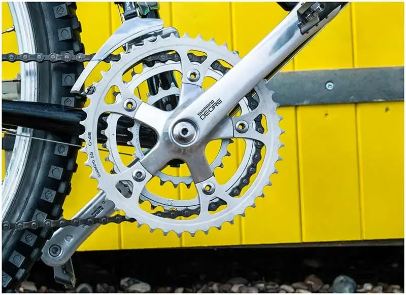

CRANKS Shimano Deore DX Silver

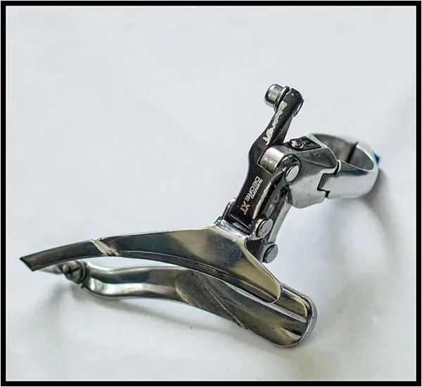

FRONT DERAILLEUR Shimano Deore XT Black

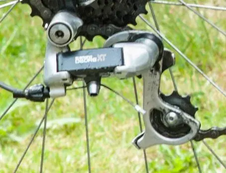

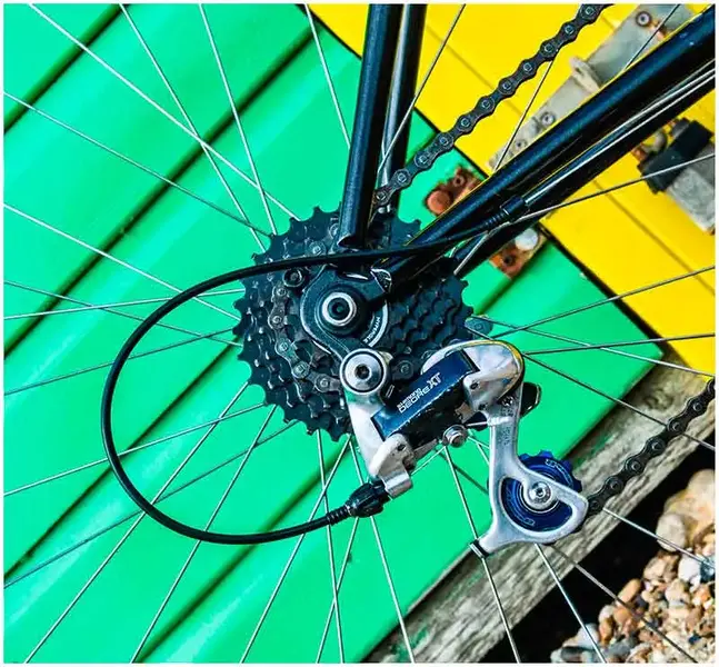

REAR DERAILLEUR Shimano Deore XT Black

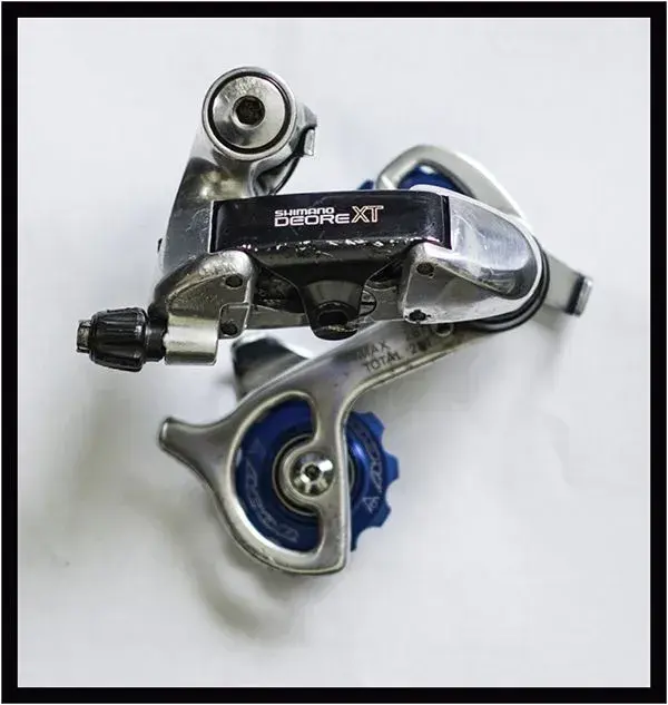

Jockey Pulley Wheels Acor CNC Alloy Jockey Pulley Wheels 10 Tooth 7 Speed Blue

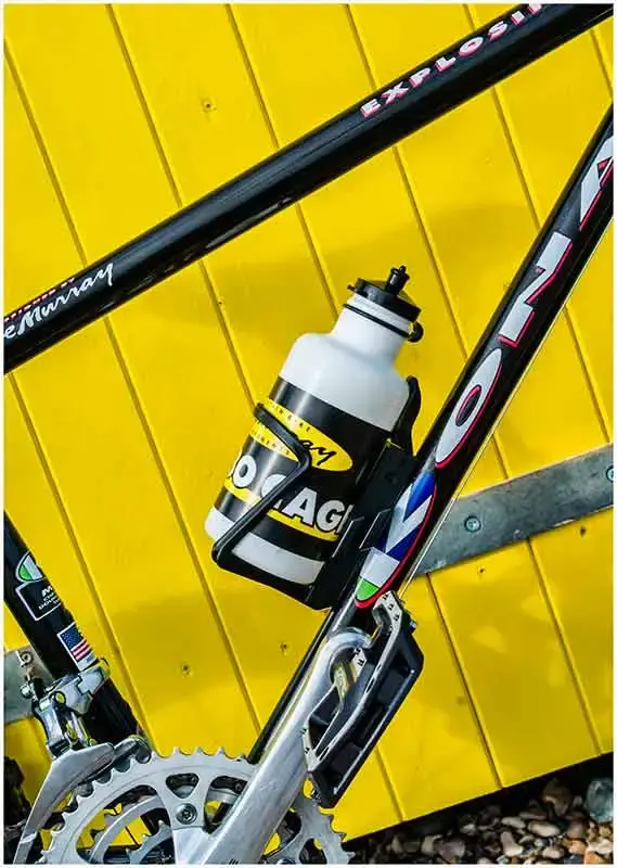

Bottle Cage
Joe Murray Combo Cage Water Bottle And Bottle Cage
Cranks DX old PEDALS
