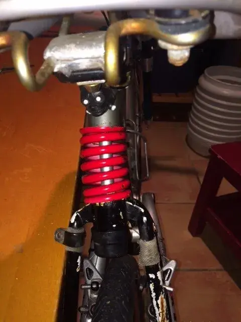

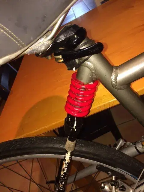

I am very new to this, but I just got for free this bike and I am trying to get it back on the road for my son, the only left issue I have with it, is with the rear suspension.
I have disassemble the rear part and I feel it my suspension is frozen it is because my rear spring (red) is to hard, do you know where I can get a new one?
Also, I am told that I shall replace some dampers inside if anyone could help me out I am sure my son would be happy to have a fully working bike.
I am attaching 2 pictures of the rear suspension

That looks rather weird to say the least. The stock 862 comes with an elastomer, not a spring so that's a non standard part on there. I struggling to see what that spring is sitting up against, other than the join between the seat tube and the top tube, which looks decidedly dodgy to me.

Thanks for your feedback, yes the spring set up against the bike frame and up against the rear fork at the bottom. as per the link do you know which of the elastomer I shall get as they have a lot of different one? Sorry to look so novice but thanks for helping around.

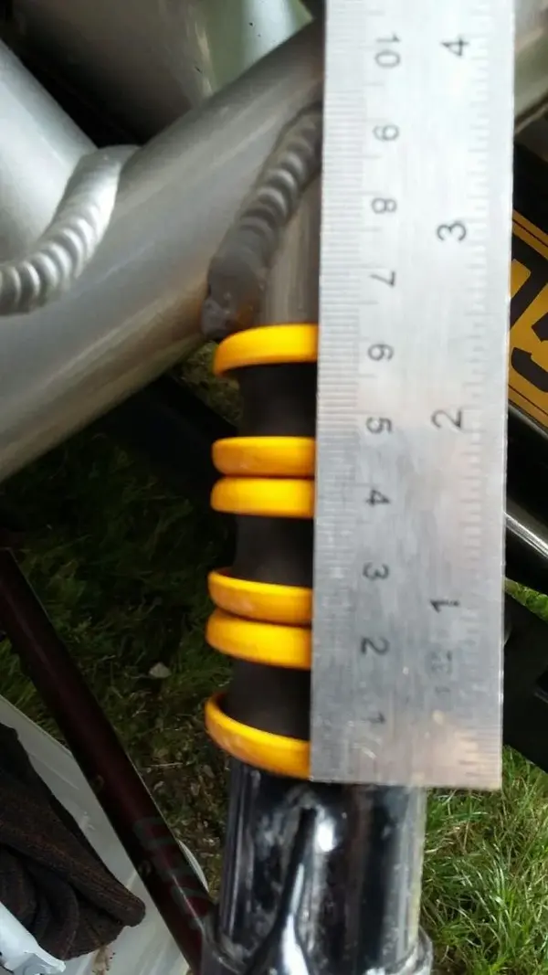

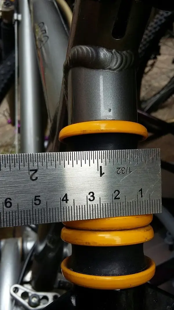

If it helps at all, here's a pic of a 962 in (allegedly) more or less mint condition. This should be more or less the same as your one. The elastomer is the yellow bit at the top of the seat stays.
file.php
My guess (and it is a guess BTW) is that the elastomer fits around the narrow metal rod running up the middle of the shock (see the pointy green line in the picture).
If you hold the bike up so that the suspension is fully extended and measure the length of that bit, that should give you the length of the elastomer you need.
If you look at the picture, you can see that there is a plastic washer at the top and bottom of the elastomer to hold it all in place. I'm a bit suspicious that your bike seems to be missing those but maybe the elastomer people can sort you out with what you need.

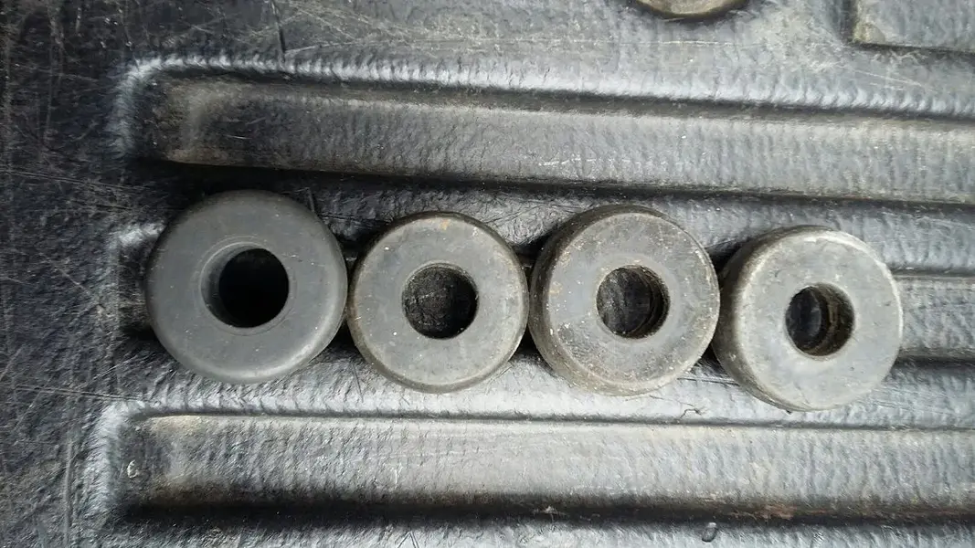

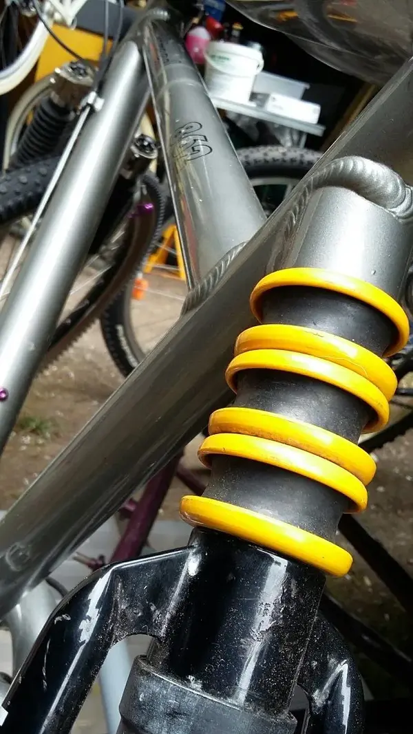

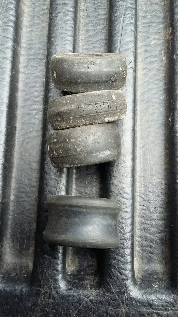

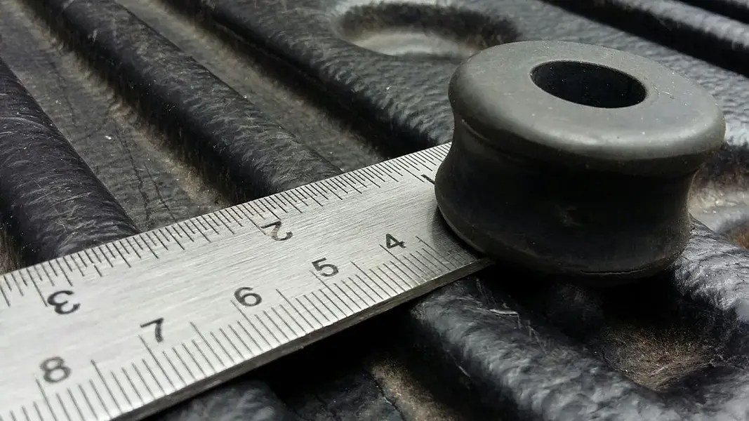

Hi. Here's some piccys of the way mines running 911 with the Landrover shock bump stops (roughly 80p each) >>>
Photos 4 and 5 show the 3 old elastomers with one of the fresh ones. I still think your spring will do the job and not be any worse than what I'm running. This was only an early shock absorbing type setup and not a modern day full on bouncy bouncy one. You will have to make it safe though by maybe getting some big washers / spacers made up so the shock isn't staraight against the frame.
