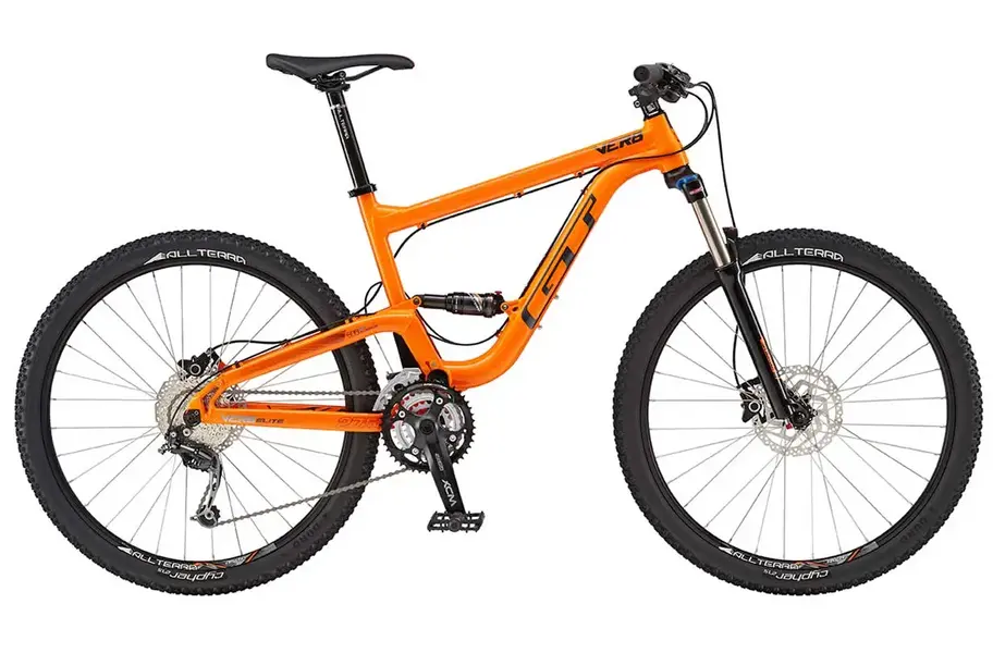

I might try a wider, straighter set of bars, but the risers are good as I have slightly dodgy wrists, hence the experiment with the Rock Shox. Initial test down my favourite hill tonight was promising and a lot less impact up my arms. I know the QUARDA 21Rs aren't exactly cutting edge and were even derided back in their day, but they were an easy, cheap and authentic "retro upgrade". Their travel is feeble compared to modern stuff - just 60mm. I guess if I really like them then the only sensible thing to do to save my ageing joints is to buy a brand new full-suspension bike and convert this back to fully rigid.
Of course I'd have to get another GT...
