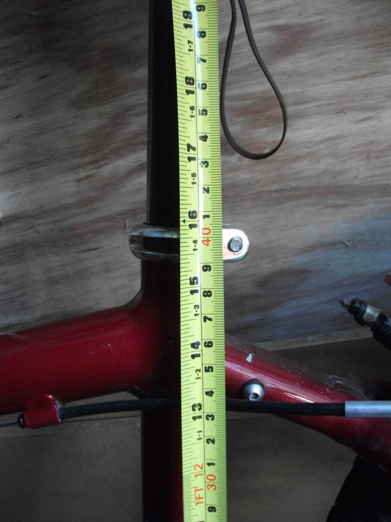

Cannondale M500 What size frame?
What size frame do you think this is, I thought 16", a 14" was available?
