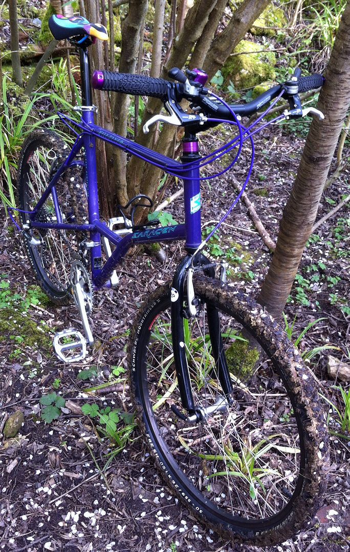

A Very Sad Looking 1992 Saracen Kili E Stay with issues
coomber
This was cheap and I bought it under the influence of alcohol...
Kindly picked up and delivered by the great gravy monster
Has awful parts, no problem I think, strip them off, most can be binned as in a right state, but the frame is still dent free and good. Or so I thought. Then I see this:
One seatpost half way down the seattube. Hard to tell how much is in there but its bothering me.
Cant get a magnet down there to see if its alu, but assuming it is and so next week I'll be giving caustic soda a go.
If I dont give up and pass it on.. It'll be a modest build of stx and a few nicer bits like thumbies, ritchey bars, old flite if I can restore it.
Yep, its a bit of a dog.

Caustic soda.. Frame upside down and plug top or just pour straight down seattube do we reckon?
Couldn't resist a little more tinkering so cranks now off and junked unless anyone wants altus cranks with free rust and presumably stuck plastic pedals...
Handlebar is great. Been hammerited but mainly on the top. Shifts are junk anyway but not coming off. Might have to cut bar in half to slide off and then I can rescue stem which is fine otherwise and now removed.

Assuming the post melts out nicely, anyone know what size seatpost I actually need?
