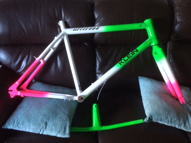

Fast forward <ahem> "some" years and occasionally they have turned up in my size but never quite at the right time. So when I got the opportunity this year I claimed it was a special birthday present to myself and went for it. A frameset freshly refreshed by jonrock. So exciting.
It sat in the lounge for a week, just so I could stare at it !

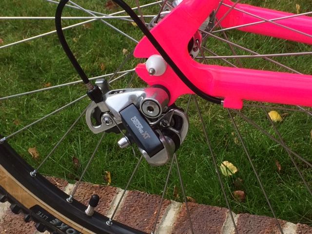

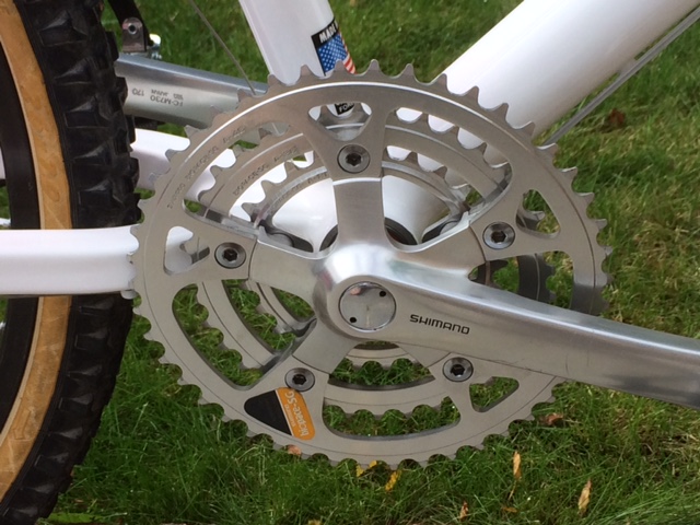

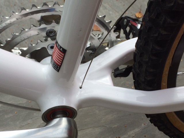

Brakes cleaned & polished. Shifters & rear mech too. Need to source the correct band-on front mech. Fitting the gear cables.... BLOODY INTERNAL CABLE ROUTING !! Jon had fitted new liners, but I like to cross over the gear cables so that the outers don't rub on the headtube, which meant removing & reinstalling the liners. Massive PITA. But I did it eventually. Front brake fine, rear brake cable just a touch too short so a new pair ordered. Chainset dismantled and every tooth individually cleaned. Any normal person would give me a funny look right now, but I'm sure you guys are just nodding approvingly

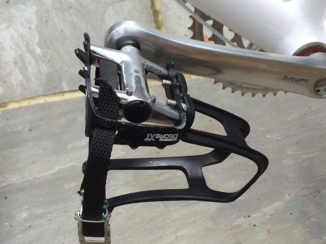

XT pedals cleaned & polished, Specialized toe clips fitted from one of my other bikes. And here I'll mention one of my pet peeves - otherwise obsessively period correct bikes without toe clips. They were ubiquitous BITD (unless you had the brand new, groundbreaking SPDs). That's why so many pedals are asymmetric, they have a "right" side to put your foot on. If one side is cut away on the outside edge, they're meant to have toe clips !

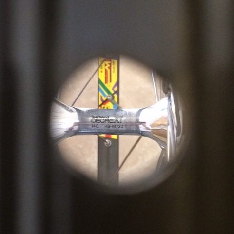

Next, the wheels. M730 & M732 hubs in great condition laced to M231CD rims that look almost unused. A couple of rides max. Lovely. But bizarrely 36h front & 32h rear. I think the donor bike was a Friday afternoon parts bin job. The nipples were all discoloured with age so I've ordered new ones, stripped the wheels down today and will rebuild them later in the week when I have new nipples. Shiny hubs & almost unmarked rims:
Next d'oh moment - the rear hub is 130mm and the Klein frame is 135mm. Longer axle ordered. And then I realised that means the XT skewer won't be long enough either. So as the only modern component I'll use on this bike, I'm using Halo Allen key skewers. They're cheap & neat. I use them on a lot of my bikes.

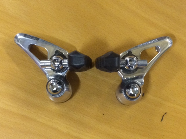

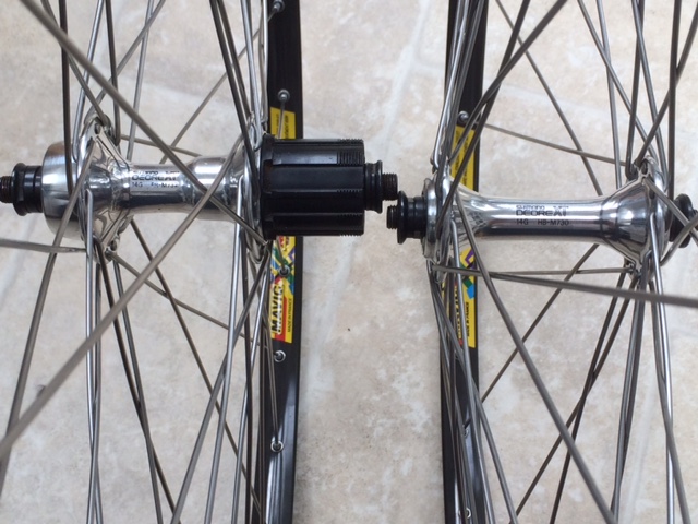

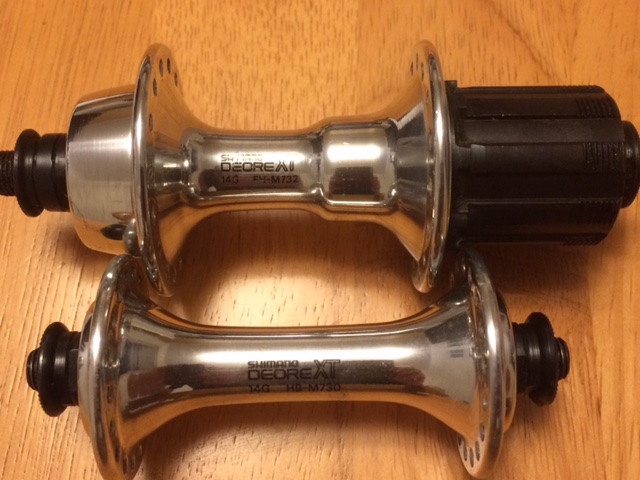

Next, how to acquire the right bits ? Doing it piecemeal could take forever. A huge stroke of luck and a suitable donor was found with a vgc 1990 XT groupset that would provide almost everything I needed. I got stuck into that yesterday. This era of XT was mirror polished and it still comes up lovely. Here's the front brake after a quick polish. It's better in real life.
Not NOS quality, but pretty close. 26 year old brake blocks might be interesting to ride !
