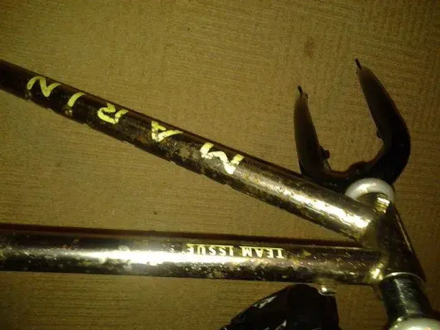

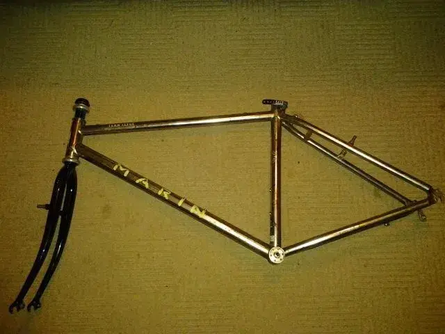

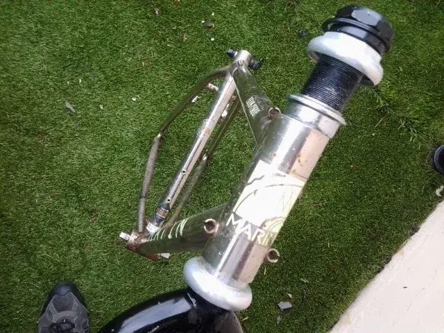

Unable to save myself , I won this for £25 on eBay today. :facepalm:
A 1992 Marin Team Issue frame ! In my size.
It looks pretty rusty , but hey a projects not a project without some grief , right ?
Hoping to have it chrome powder coated to replicate the polished nickel finish which has had it , although I've emailed a company who do nickel plating to get a ballpark figure , you never know , it might be do-able !
Anyway , it won't be a quick project because I have several unfinished bikes in the garage lol so it'll be done as and when , but I'll try to keep it updated.

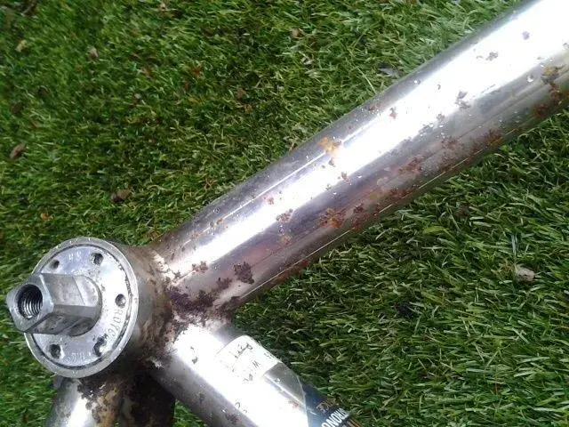

Indeed it does , seller thinks it may be jammed though or fitted wrongly as the left hand cup is fitted to the right hand side of the frame ?
Never tinkered with a bottom bracket before always leave it to the lbs so have to wait and see what turns up.
The "LH" just refers to the left-handed thread cup, which is correct for the RHS of the frame! :D
I reckon you'll be surprised how well that'll clean up bud.. a couple of guys on here have done it with scrunched up tin foil. Give us a shout if you need anything to complete the build. :wink:

ask jussa on here about oxyacilic acid he just did an old raleigh burner with it and the results were amazing.
Cool , I've got some oxalic acid as it goes , we use it on the boats at work.
Do you think that the finish can be saved even with all that rust ?
Curious how the tin foil works !
