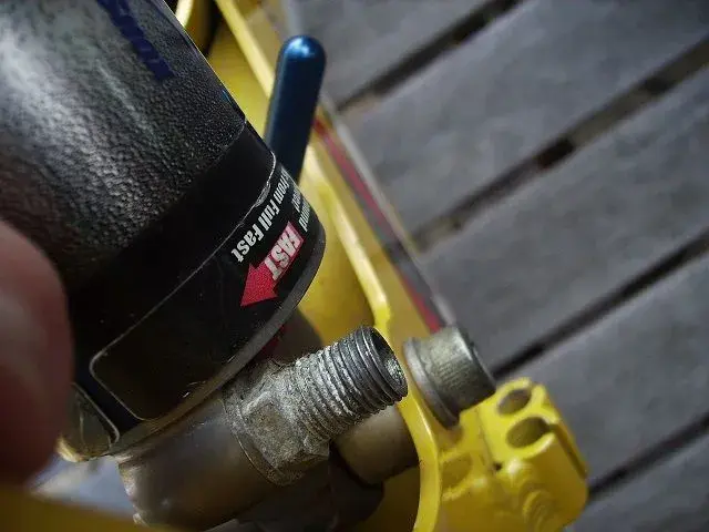

Is it salvageable do you think? The rebound adjuster, the red circular dial, won't move at all. Have fiddled with the positioning of the blue lever but doesn't make a difference to the dial, still won't move. The valve cap was corroded on, had to be removed with pliers, so that's obviously not been off for a very long time. Now it is off, something very odd is happening when I try to add air, basically I wonder if it's actually holding air at all? It'll take it, then when I put the pump back on again, nothing is registering, it says zero again! (Pump is new)

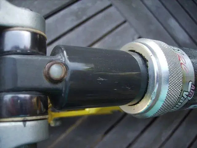

There's a ding in the 'stantion' bit but I can't see that affecting it if it actually worked. And does that knurled collar do anything...? Don't want to start building up or taking apart for now until I know outcome off the seller.

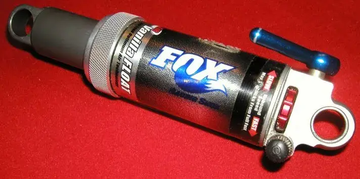

One pic is from the net, as I haven't taken a pic of the whole shock yet :facepalm:

If there is a dent in it then it's dead. As soon as the seal goes over it on compression it'll loose air and oil depending on what is there. Bin it.
The valve has probably corroded or gummed up, same with the damper adjuster. Wd 40 etc may free it up. Chances are the oil is well used given the condition so will need a service.
The ring is a spring adjuster (air spring)

"The ring is a spring adjuster (air spring)"
If I am correct that you are replying to the question "And does that knurled collar do anything...?" and not the red circular dial which is already ID'd as the rebound adjuster, nope, it's not an air spring adjuster.
The air can sleeve screws into it and it holds the seals for the air can sleeve. It doesn't adjust anything. If you were to unscrew it all the way, without letting all the air out shock, there's a chance you could get injured by it blowing off. A chance though as I assume the air will leak first before the ring was unscrewed completely.

It's the dent in the body (brown bit) that been mentioned that is the major problem though.
OK, just was worried LC might try unscrewing it in an attempt to find out what was wrong with it.
As you say the dent means it's a goner. How does anybody manage to get a dent on the shock shaft when it's directly under top tube/seatpost mount?
