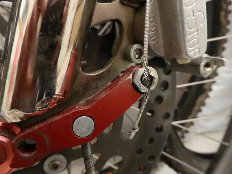

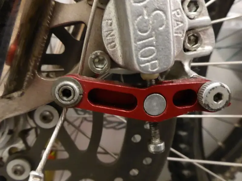

Hi,
Does anybody know where it's still possible to get spare parts for MC Pro-Stop calipers, 1st gen? I broke (or should I say it broke itself? 😱) the cable-locking screw. OK, I know it was 25 years old, but discovering that this "safety" part was made of weak aluminum alloy where I was expecting strong steel now drives me nervous...
Quite interestingly, I've found old posts of people selling NOS (or new BITD) complete calipers where this cable-locking screw just isn't present, as if it was something standard that could be found easily. I then simply don't know what's the correct wording to find such a thing.
Of course, if someone is manufacturing steel repros of this cable-locking thing, I'm in :)
Thanks!

Interesting :-) I too will try to disassemble everything this weekend. Be careful to the tiny ball beneath the locking screw and the cable. It's easily forgotten...
As a late follow-up, this was sorted by a friend of mine [1]. Sorry, he only made one pair from an aluminum bar and didn't took any measurement for future references :p. Thanks anyway Pascal!
