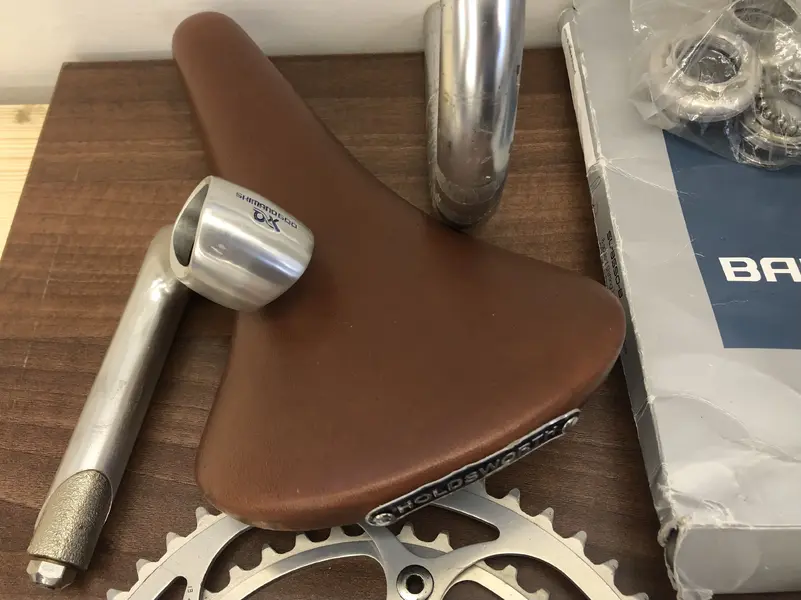

Anatomic saddle went straight into a box I’ve put aside of catalogue correct kit for my daughters Majestique, and the arabesque levers and front mech have me thinking about the group.

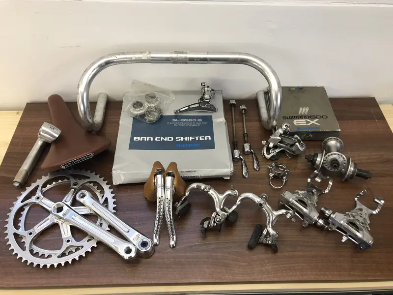

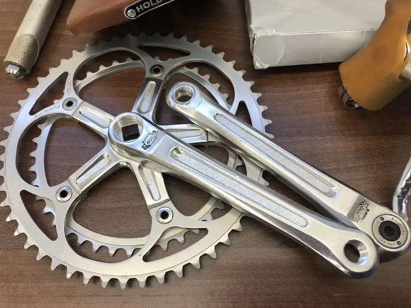

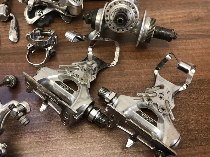

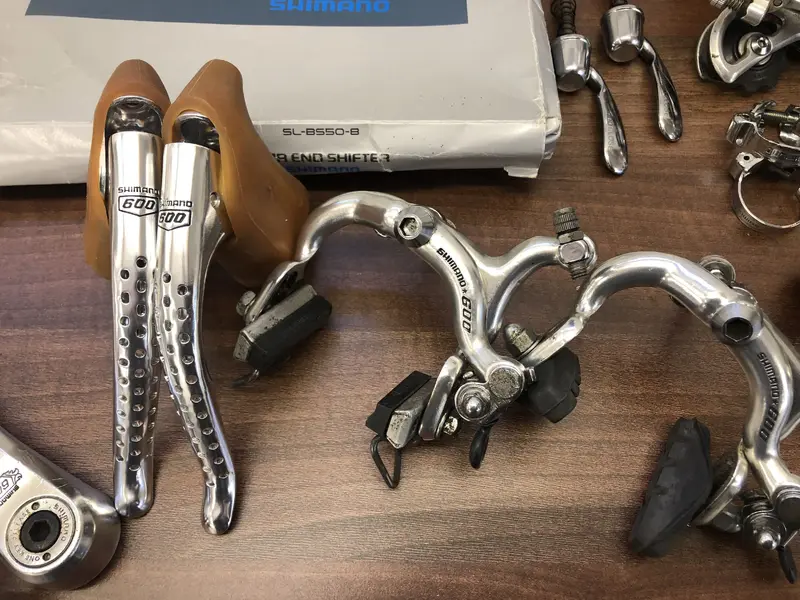

I had a rummage about and have cobbled together a sort of group, predominantly 600 from across the ages, I think I'd like to use it's original Arabesque front mech.

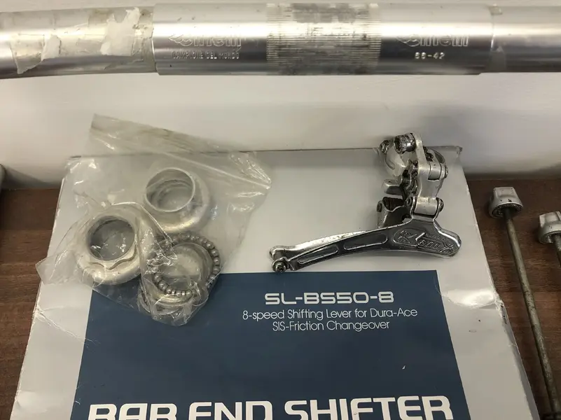

8 speed Dura Ace bar end shifters, I know they work with the 600EX SIS rear mech, but will the indexing be ok with me restricting the stops for a 6 speed freewheel? It is a 600EX indexed freewheel, just not sure if the jump up to 8 speed made any slight changes? :? IMG_0067.webp IMG_0065.webp IMG_0064.webp IMG_0063.webp IMG_0062.webp IMG_0061.webp IMG_0060.webp
Very shiny kit but maybe check the forks first if you already havent done so?
(8spd shifters may work pretty well, I'm sure I ran 8 with a 6spd freewheel, but dont forget down tube shifters work just as well on the bar-end mounts!)

As for the shifters, I guess I’ll find out when I fit them. :wink:
